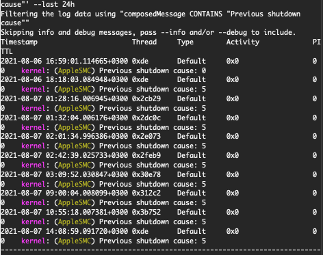

I woke up last saturday morning and checked the results of shutdowncause with terminal.
Last login: Sat Aug 7 14:09:13 on console
I'm pretty much sure I was sleeping allready at the time of those late night boots, and I don't know what was happening there. Big Sur 11.5.1 running now. I'm not so reassured of the latest Bug Sir update.
Most of the programs do recover from those boots, I reckon. I think not everybody bothers to bother about these incident that much with 6,1's because of this recovery process. My main program does not recover that gracefully though. It needs some user interaction to fully recover. Maybe because I fire a lot of instances of that program all the time. That's how it works. An instance for one project. Or an instance of a program for one file that is.

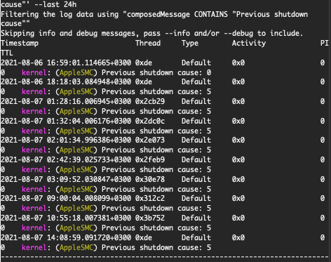

Sorry I am OT. I am on 6,1 now. Maybe I should go with 5,1 OC+LB, and maybe get a more reliable alternative to this 6,1.
