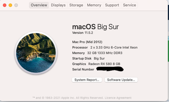

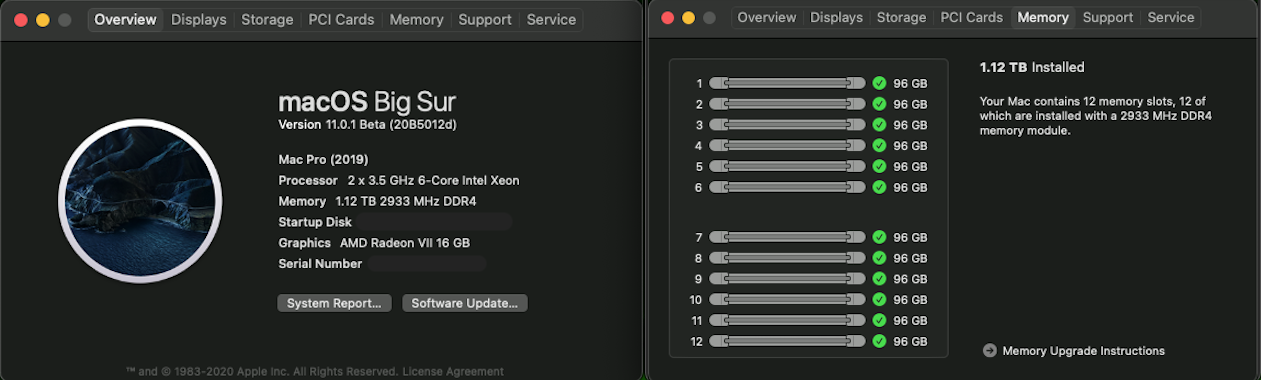

After playing around with the ram, we can now say that we can run 256GB 8x32GB of ram in this Mac Pro.
The 1.12TB of ram showing here is just to see how far I could go with the config.
No more " Notification Message Error " anymore. I do not even think that Notification disabler.Kext is needed anymore too..
Everything runs smooth..View attachment 999535View attachment 999499

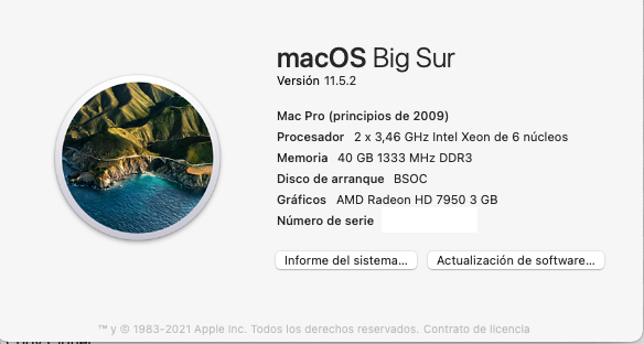

Running Big Sur 11.2.3 in my Mac Pro 4,1->5,1 with the @h9826790 package, works like a charm. I have cloned the SSD and updated to 11.5.2., activating Latebloom. The installation went smooth, no problems at all. Boot at first try and working with it now. Seems to run perfect.
Thank you so much, @h9826790 and everyone involved.

Yes, working so nice. But I replaced the original ones with a new Wifi/Bluetooth card long time ago.

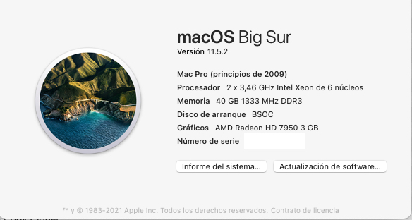

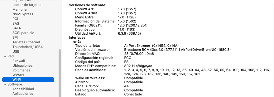

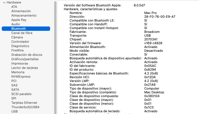

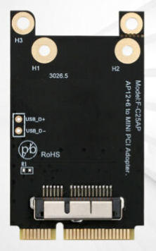

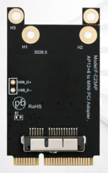

Hello,
I have a MacPro 2012 running BigSur with Opencore 7.2 (Martin Lo package).
It's a new installation I've done, drive was completely wiped.

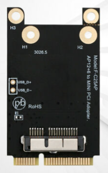

I have in this Mac installed an iMac Wifi card which is using the chipset BCM943602 and this adapter (attached image of it)
I am getting the Wifi to work fine but bluetooth is not detected and I would like to use airdrop.
I've tried with and without attaching the USB lines to the bluetooth connector as some mentioned in another guide but with no difference.
Is this an adapter problem from your experience and I will need to get a PCI-e adapter instead or there something else I can do to fix this?
Thanks.
I tried updating 11.5.2, and it hangs halfway through, don't know what I'm doing wrong. Will have to buy another wifi card it seems. currently on 11.2.3
Sorry about your predicament, but this is the wrong thread to ask about Wi-Fi/Bluetooth hardware updates. Such concerns have nothing to do with OpenCore.
