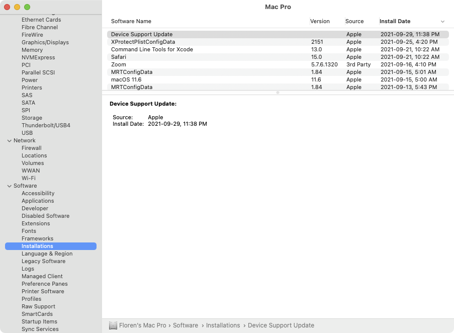

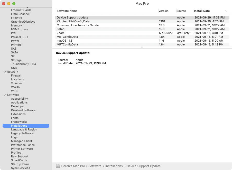

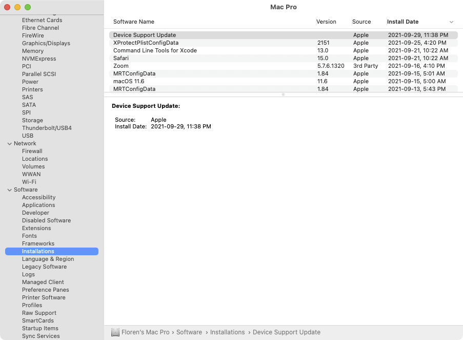

Has anyone seen the "Device Support Update" in software update?
I am on 11.6 with OpenCore. I use Hybridization to see Software Updates and moved from 11.5.2 to 11.6 recently. However I am not seeing the "Device Support Update" that was released yesterday so curious if others are seeing it and it something is going on with my system.
I got a notification the other day and installed it, update did not asked for reboot.
