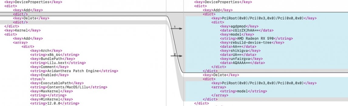

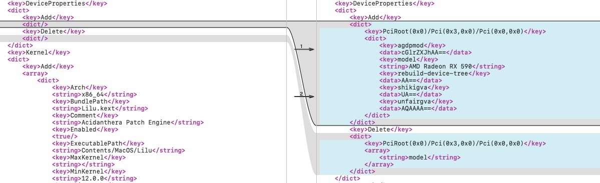

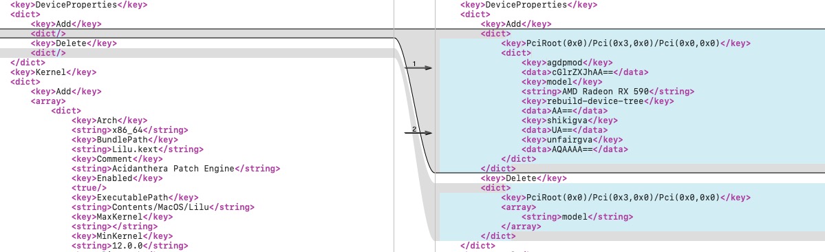

Attached is the difference between my MyBootMgr 0.7.3a OC config.plist (no GPU issues) and the 0.7.4a OC config.plist version (blank display after the Apple logo progress bar disappears, and therefore can't see logon screen onwards). I'm not too sure what to take from this because 073a doesn't have the Device Properties agdpmod section but works, and 074a does have it and doesn't work?! Hoping someone knows how to make sense of this.
One Config file is for when GPU acceleration is active and the other for when not.
Anyway, this suggests the PCiRoot (XYZ) path is incorrect. This can be either because the config file was generated on a different machine or some flaw in the code getting the path.
Follow the procedure in Post 1 (of this thread) >> ADVANCED CONFIGURATION >> Enabling Hardware Acceleration >> The path of your graphics card (Expand the Spoiler) to get your actual GPU path and replace the key under "Add" and "Delete" with what you get.
If you end up with the same value and that is the only material difference in the config files, then your issue is elsewhere. Other obvious action is to edit that part to match the one that is working and see if it works (but will not have GPU acceleration)
Another possibility is that the device properties did not take:
However, I don't think that the RX 590 (@JedNZ's card) has this problem.
I updated on the MyBootMgr thread, but basically I checked the PCI lane thing with gfxutil and it is correct
<key>PciRoot(0x0)/Pci(0x3,0x0)/Pci(0x0,0x0)</key>

Good to know ConfigFactory is able to both correctly identify the GPU and get the correct Device Path.
