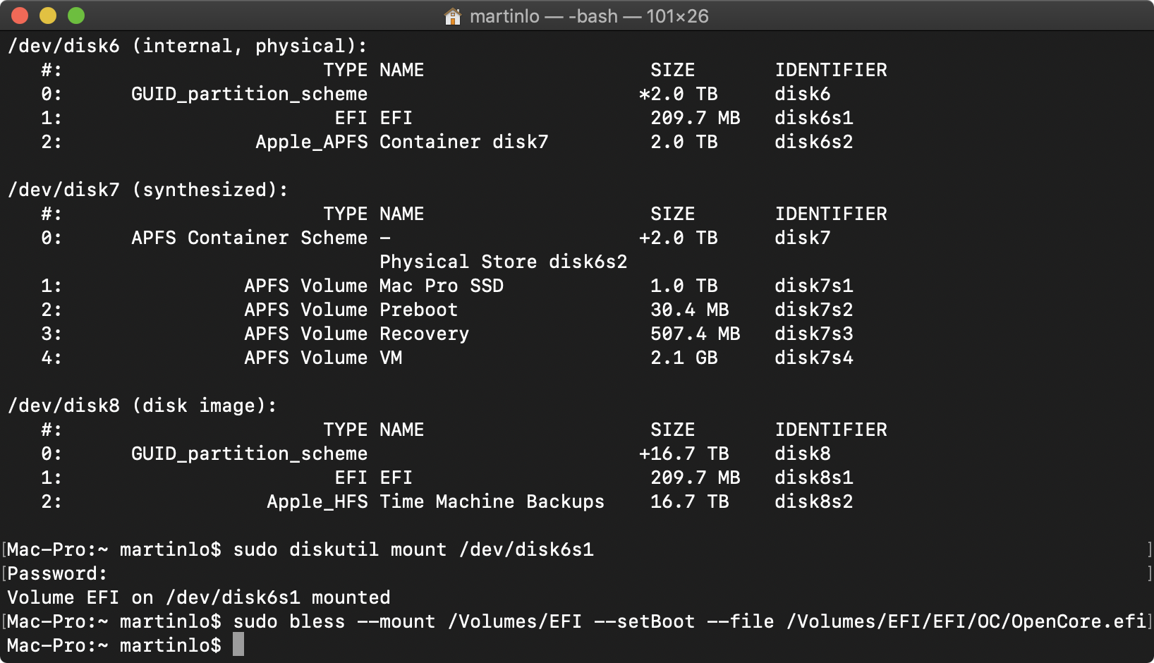

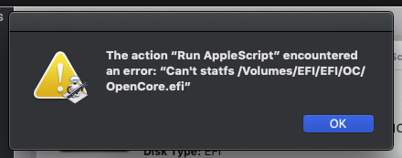

I'm slightly stuck on trying to put 0.7.4 on my second 5,1 Mac Pro which has Mojave 10.14.6.
I'm fairly savvy with this (I have it running on my other Mac Pro), but this is the first time I'm getting this error when I run the bless command:
csrutil status is disabled. I have only the 1 disk drive in the machine now, just a single 1TB HDD.
Opencore is in the right location as well. My Google wizardry is failing me when I search for that.
I've checked and the structure from my disks is nearly the same as in the screenshot here:
I used these commands:
sudo diskutil mount /dev/disk0s1 (that worked)
sudo bless --mount /Volumes/EFI --setBoot --file /Volumes/EFI/EFI/OC/OpenCore.efi (that gives the error)
the same error occurred regardless of me typing it in or using the AppleScript provided in the package.

I'm doing everything the same as for my other MP 5,1, they are nearly the same just that this one has an old 1TB hard drive and single CPU X5690. Both are RX580 graphics cards.
sudo bless --mount /Volumes/EFI -setBoot --file /Volumes/EFI/EFI/OC/OpenCore.efi (that gives the error)
I don't think your syntax is correct, which means you are trying to bless the wrong path. You'd better study the details of post #1 and use the syntax recommended there.

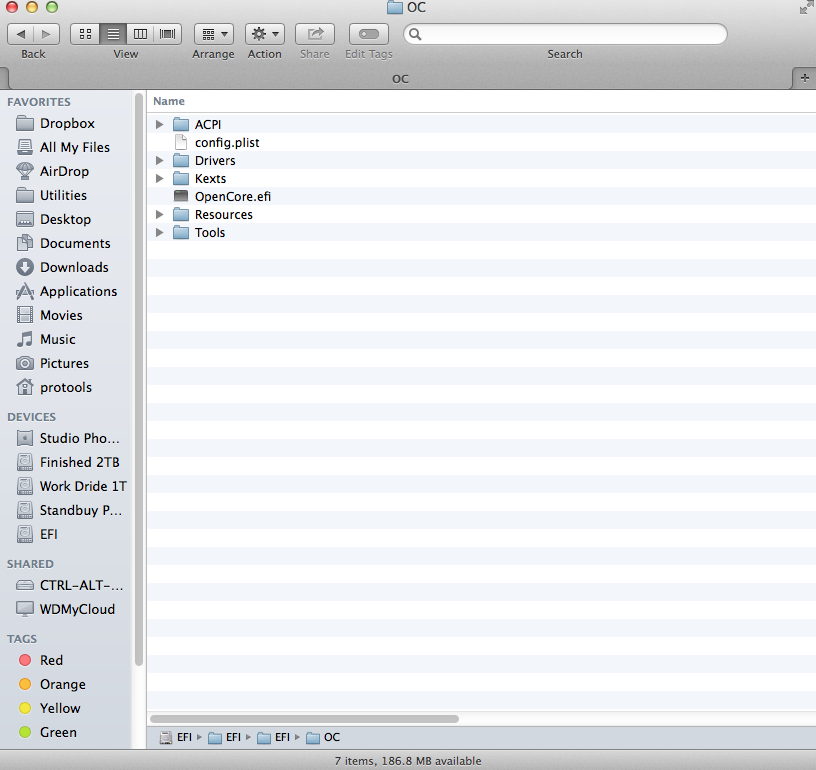

Hi there, I can't manage to boot OpenCore but I think I've followed all the steps properly. Mac Pro 5,1 running macOS 10.9.5 here. I want to enable my GC-Titan Ridge 2.0 Thunderbolt card but the System Report still shows nothing under the Thunderbolt section?!
I've looked to see if OpenCore was booted properly and here's the error message I got, what could be the problem?

In the attached picture you'll see the mounted EFI partition with the proper files added to it and I think I set it to be bootable... please help!

^I don't know about those messages, but I think you need the following:
EFI/EFI/OC/ACPI/SSDT-TBOLT3.aml (this should be announced, within config.plist, at Root/ACPI/Add/0: Comment=TBOLT3 (or anything you like); Enabled=true; Path=SSDT-TBOLT3.aml
That's the way I have it and it works fine.
This differs from the description in post 1 in this thread. Why do you ask in this thread when you are following a different recipe?
Sorry, I confused OpenCore with another package (linked from the first post in this thread). Indeed this was the wrong topic. Apologies. I found what was happening and it was unrelated to syntax.

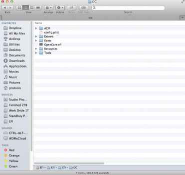

you have one EFI too much
