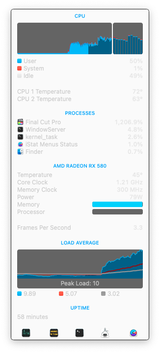

The issue is mainly to do with Apple Apps like FCP and Compressor. With Big Sur on FCP 10.5.4, only HEVC Decode and no Encode. 1:26:00 minute Swordsmith clip took 25 minutes to render (4K UHD 10-bit HDR to 4K UHD 8-bit) with most of the Xeon Cores on ~40% loading while RX580 is idle most of the time (except when FCP is decoding).
FCP does use the AMD dGPU for H.264 Encode & Decode and took 2 minutes to render out.
On the other, VideoProc App uses VideoToolBox API and has no problems transcoding HEVC to H.264 in realtime (took less than 2 minutes (~ 32 fps vs 3 fps with FCP).
Not experimented with Monterey yet.
UPDATE:
Issue persists with iMacPro1,1 spoofed board-ID with FCP 10.5.4 too. I believe version 10.4.6 did work well under iMacPro1,1. I'll downgrade mine and test with both spoofed ID's.

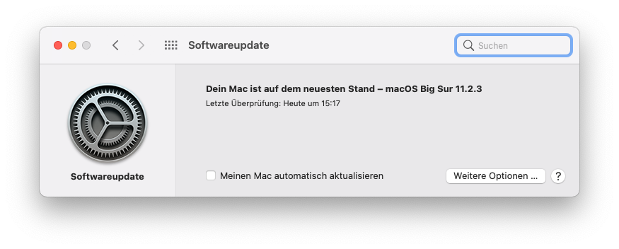

I followed the instructions on page 1 and was able to run Big Sur 11.2.3 on my Mac Pro5.1 since several months. Now with OC 0.7.4 and the integration of SurPlus I wanted to update to 11.6, but Software-Update doesn't show the update, it says "you are using the latest version 11.2.3. I have gone through my config file several times but can't find what's wrong. Would be great, if a more clever person could help me out... and yes, the VMM flag is turned ON.
  • config.plist.zip
The update should show up if you use hybridization spoofing (in which case, you won't need the VMM flag).
