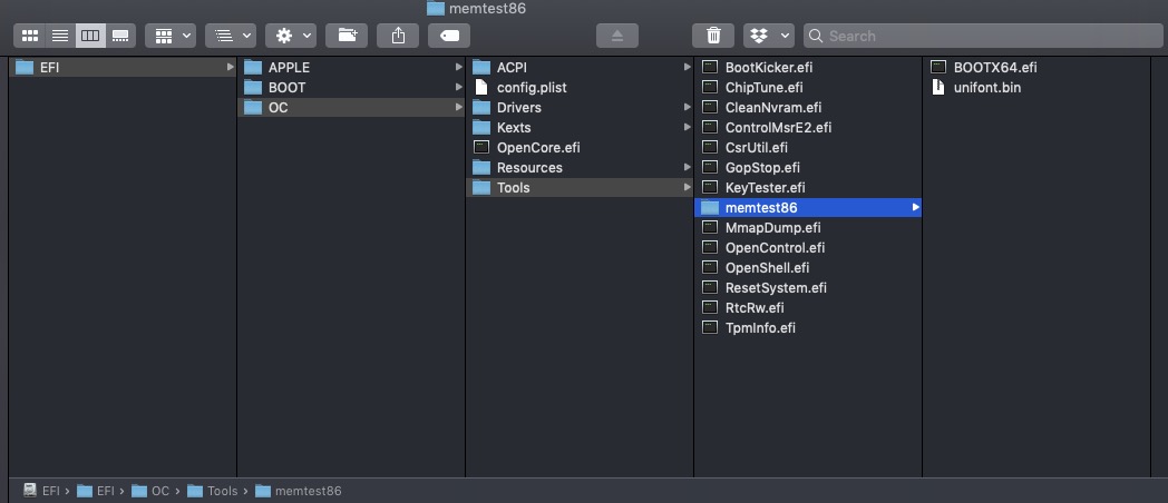

To use MemTest you have to download memtest86 from its website. Mount the file memtest86-usb.img. Now, you should see a folder named EFI containing a folder named BOOT, open it. We are interested in only 2 files: BOOX64.efi (it's the app for 64 bits) and unifont.bin. Save these 2 files in a folder called memtest86 and put this folder inside the OpenCore Tools folder. The Path key of this tool in config.plist must point to memtest86/BOOTX64.efi. This way, running MemTest from its icon in the picker executes the memory check."

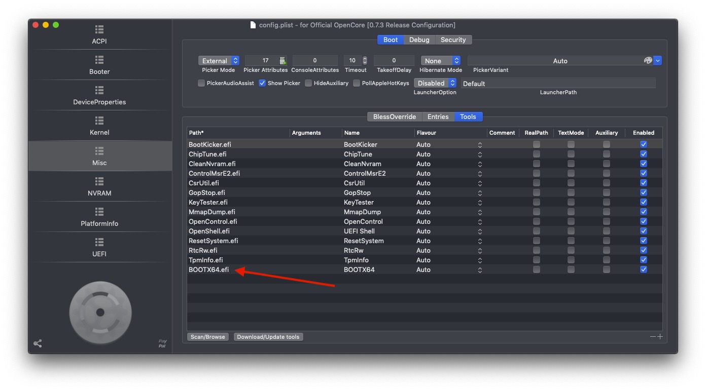

I follow the instructions, opened OCC and added memtest's BOOTX64.efi to config.plist's MISC>TOOLS. Upon reboot, I now see all the tools in my boot picker, but, unfortunately the I tried to execute BOOTX64.efi nothing happened in OC defaulted back to my default boot device.
I'm not sure what to next...
That's a good guide to install and run memtest86 on OpenCore.
But you you did not follow the instructions you quoted above.
It states "Save these 2 files in a folder called memtest86 and put this folder inside the OpenCore Tools folder". Memtest86 needs that unifont.bin font file to run.
Also, the reason you see all the Tools in the Boot Picker is because you have enabled them all in using that configurator tool you are using (personally not recommended).

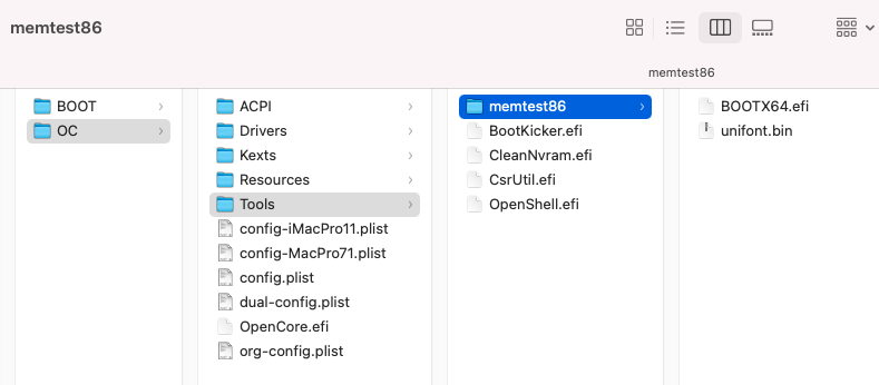

Your EFI folder structure should look like this:

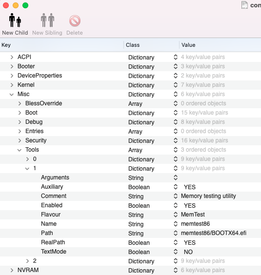

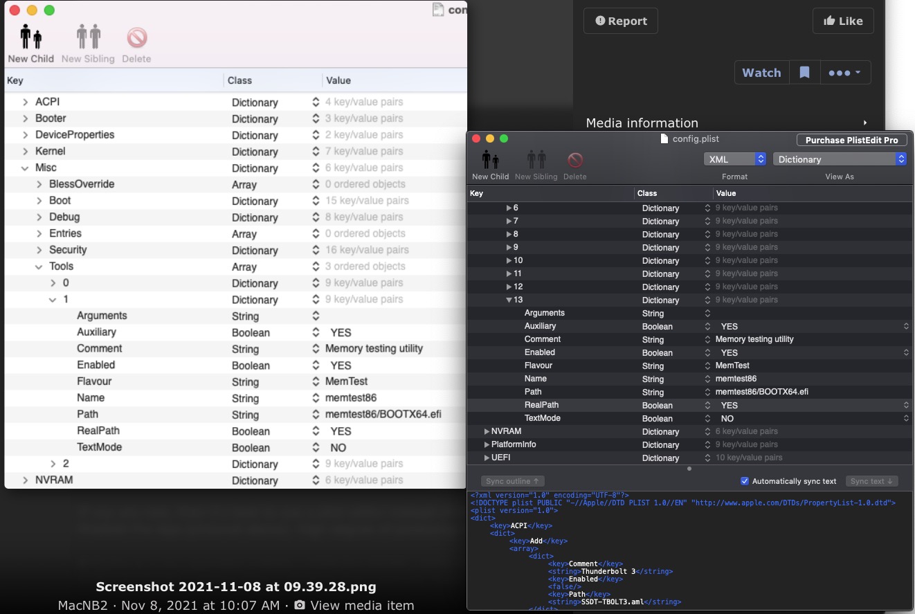

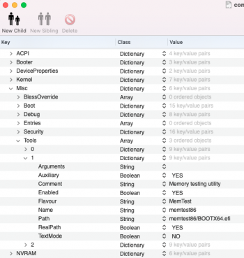

In your config.plist, the entry for memtest86 should look like this:
If you are new, then it's best to use a plist editor instead of that tool. There are many but I personally prefer & use PlistEdit Pro App (pictured above). High degree of producing fully compliant plist files and really easy to use.

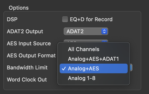

EDIT:

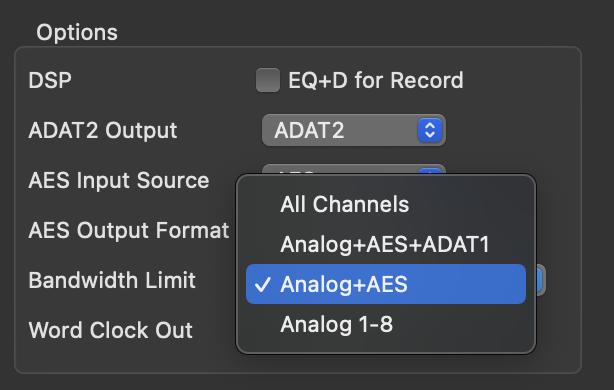

I just found my solution!
In my my audio drivers settings I limited the bandwith of the interface... to not use All Channels.
Now I can play high resolution audio files again, and do 96kHz projects in Logic Pro X without crackle/distortion.

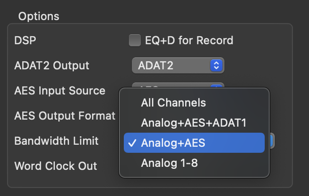

EDIT:

No, this is the specific driver from RME for my audio interface. You have to look for something similar within Focusrites own driver software if it exists.

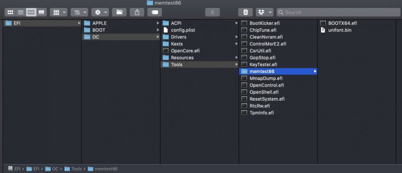

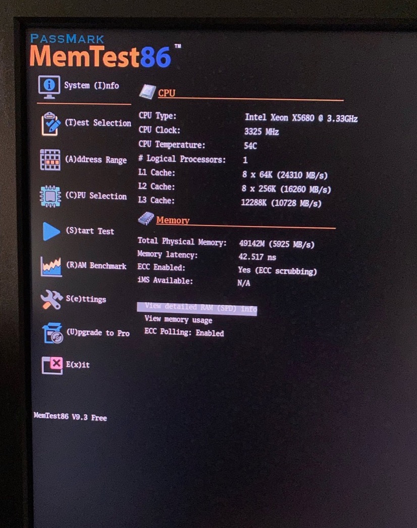

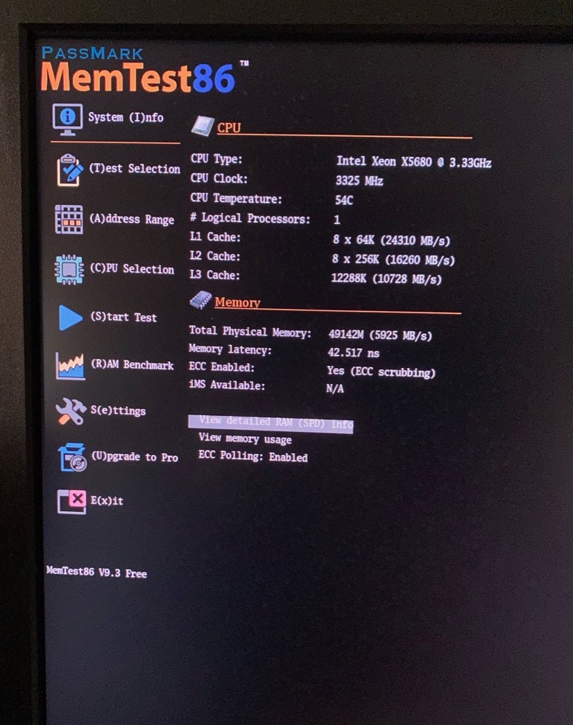

Success!!!
Great info, Thanks for the screenshot and recommendation of a good plist editor. I had placed the 2 files correctly but the other tool didn't respect the file path I though I'd selected. From your screenshot of PlistEdit Pro App I was able to see what had not been respected by the other tool and made the changes....
And now 48 GBs of RAM in triple channel will get the acid test!
Thank you!

You are welcome !
Well done and good luck with the tests.
BTW, Memtest86 has screenshot facilities...just hit F12 and a screenshot is saved in the same folder where you put those two files
