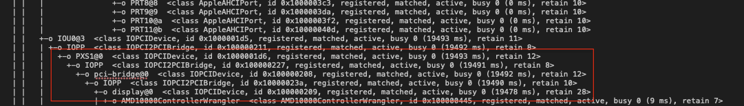

@cdf So I take it this is the problem?
It does appear that device renaming or remapping is not working as my boot SSD also shows up as an external, rather than internal, device. I did follow the steps of fetching the PCI 'name' of the SATA III card with gfxutil and embedding it in config.plist. Any thoughts as to why this particular aspect of OpenCore isn't working as expected? And is there any alternative method that might work? (I think you mentioned "rebuild-device-tree".)
Yes, that's the problem. Check with kextstat that Lilu and WhateverGreen are actually loaded and confirm the presence of the -wegtree boot-arg.

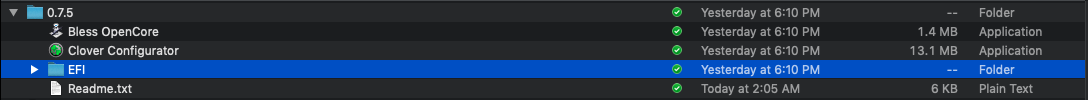

That's fine. Big Sur booted with OpenCore was the test setup for the creating the CD. This is how the CD should appear in Finder:
I wonder if there are differences to account for depending on what media is used. I've been testing this with a DVD+RW...
