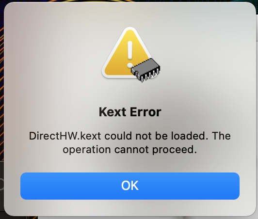

I'm trying to dump with BootROM tool but keep getting this error, SIP is disabled:
Google search has not come up with many answers.

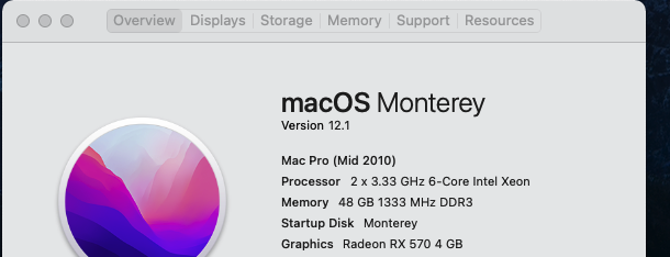

Can anyone already confirm that macOS 12.1 is not a problem for our cMP? VMM activated while updating I guess, right?
Edit: worked like a charm. Had VMM flag on and the update worked well. Was once stuck at the boot process but a forced reboot brought me back into the system and I am now on 12.1

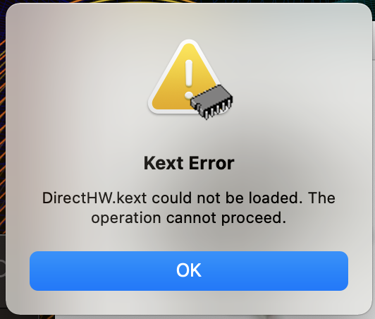

Not sure why it's not working , you could run macschrauber's ROM dumper.
Has anyone here accidentally replaced both EFI>BOOT and OC when updating their OpenCore on a dual-boot dual-disk setup and lived to tell about it?
Starting to dread that I may have to reformat/wipe my Windows drive and start from scratch. I am not doing that!
you can try my Dumper, it works with supported systems since Mavericks (no Yosemite) and unsupported (Catalina, Big Sur, Monterey)
It needs SIP disabled for Systems since El Capitan and the kext approved in Security Settings since Catalina.
SIP status can be checked by opening up terminal and typing csrutil status.
