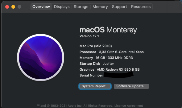

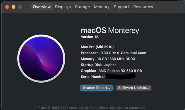

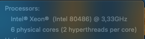

@cdf Thank you your hint "try again" was the solution. That means give the volume macOS installer a second try from the boot manager. This I'd to do for every reboot during installation.
My Mac is now on 12.1 and the desktop apps are working.
Unfortunately brew shell apps are confused. Even brew is not starting:
Code:
brew
/usr/local/bin/brew: line 27: /usr/local/bin/readlink: Bad CPU type in executable
And arch is showing:
Code:
arch
i386

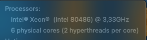

Which might be wrong. Never checked this on Mojave or any Mac OS before. Also MenuMeters is now reporting 80486 as CPU what I'd also never seen before.

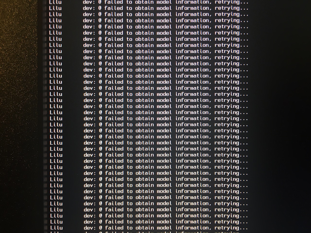

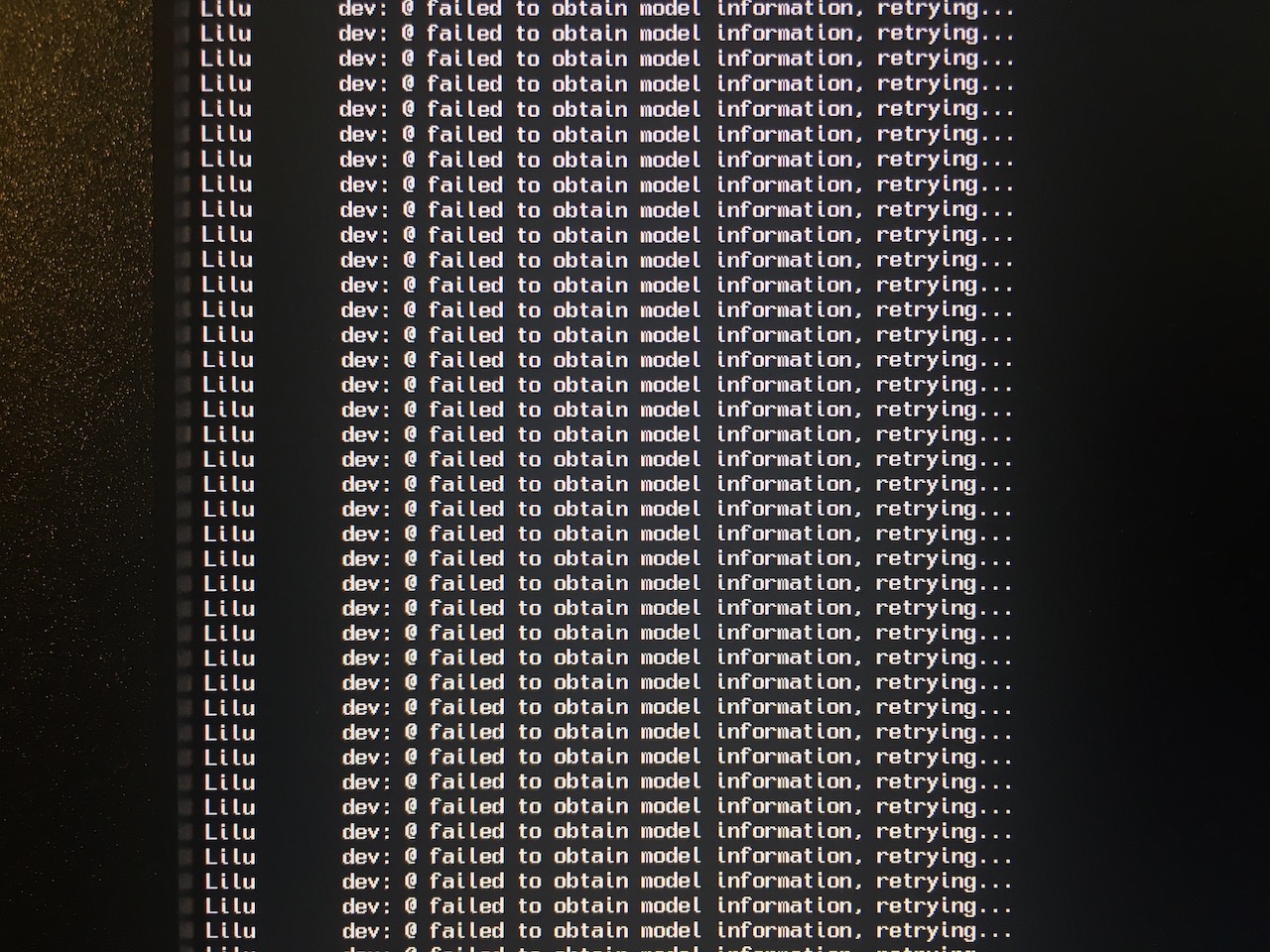

Hello all,
I wanted to check to see if this is normal when I boot my 5,1 via OC to Monterey 12.1 (did the same thing on prior versions of Monterey also). Monterey is on a 970 blade on my 7101-A card.
After selecting the Monterey disk with the boot picker, the Apple logo comes on with the progress bar. After about 10 seconds of fast movement, the progress slows dramatically. It then take approx. 150 seconds of very slow movement of the progress bar until the screen flashes, the progress bar comes back and then completes very quickly.
The system always boots and never fails. But I am wondering if this slowness is normal. OC config attached.
Thanks!
I see you are using a 970 blade. Have a look here: https://forums.macrumors.com/threads/samsung-nvme-and-super-slow-boot-on-monterey.2310537/
I had exactly your problem with a 970 evo. Swapped it for a WD Blue blade. Problem fixed. Now boots up quickly in Monterey.
Code:
brew
Code:
arch
i386
The issue with CLI apps is resolved and not related to OpenCore. The issue came from old GNU executable I've installed around 2009/2010. They where fat apps with i386 and PPC7400 executables. I moved the to a folder and immediately brew was working again. In 4 weeks I'll delete this folder.
From googling for arch I found that arch on Mac will always report i386 - I think it was on Stackoverflow.

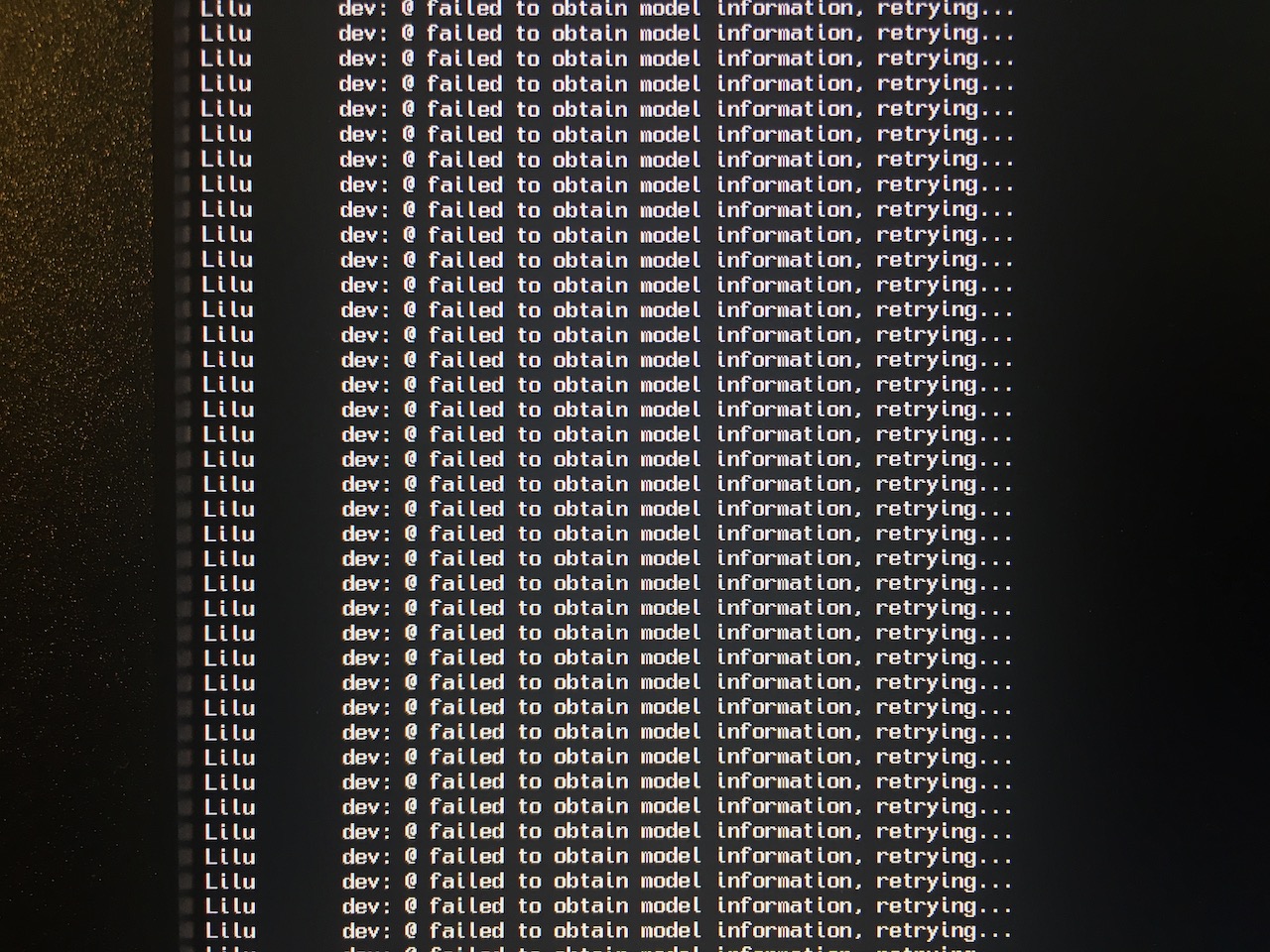

Here's a little quirk which appears on my MacPro5,1 occasionally. Sometimes, usually when booting from cold (or so I imagine) I get the following error from Lilu:
A little digging turned up very few reports of others seeing this, so I took a peek at the code and as expected, it's trying to pull the model and board identifiers from the EFI. Have other people seen this? Should I be worried?
My solution is to turn it off and back on again, usually everything is fine on the next attempt. This is happening with OC REL-075-2021-11-02, Lilu v1.5.7, though it also happened on earlier versions.
Well there you go - this happened to me today as well - had to switch off and restart twice....
