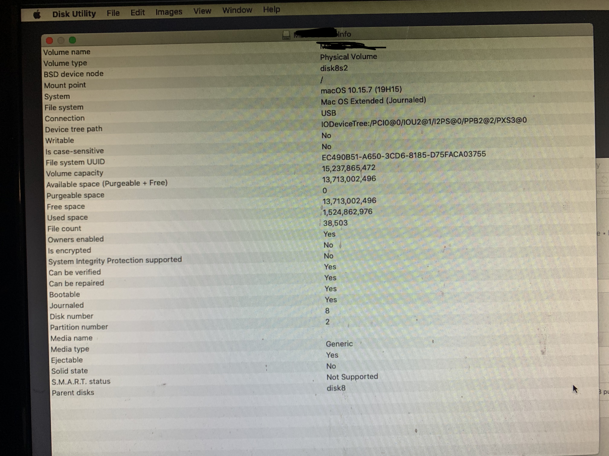

The wikipedia page at https://en.wikipedia.org/wiki/MacOS_Mojave says 18G9323 is the latest. This is the version that I see in my /Volumes/Mojave/System/Library/CoreServices/SystemVersion.plist file so I guess I'm up to date. I have dosdude1 Mojave and I believe all updates appear without having to use other tools, unlike dosdude1 Catalina.

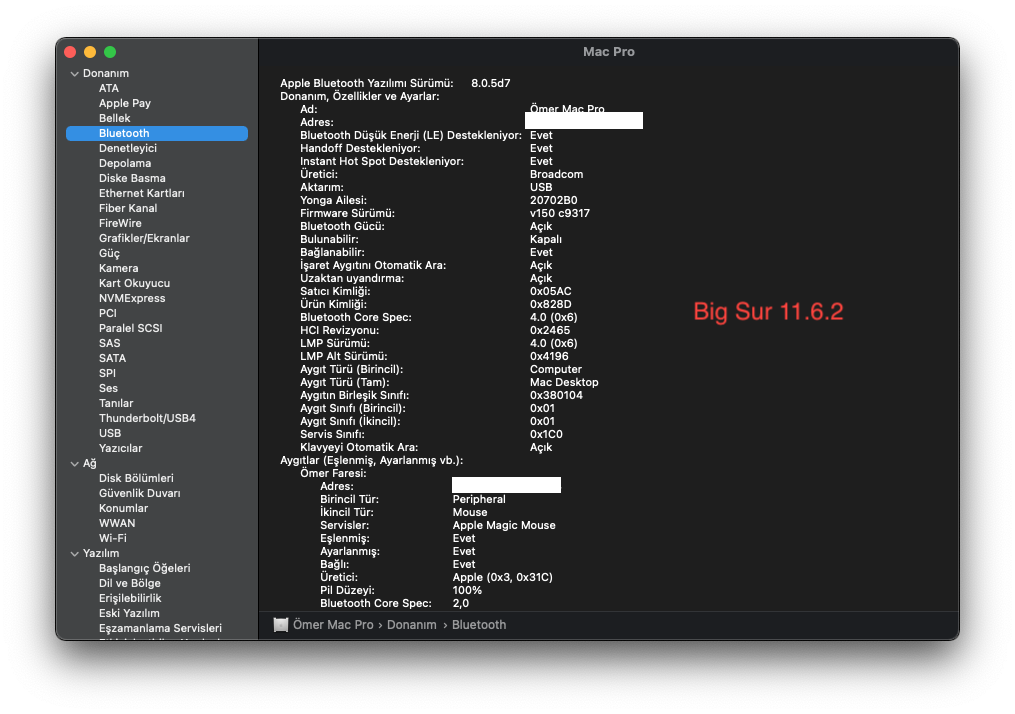

Hi,
cMac Pro 5.1 OCLP 0.7.6
BCM94360CD It works fine in Big Sur and Monterey. It doesn't show Handoff and other features in Monterey, but it works. What could be the reason for this?

Is it safe to install Catalina from the official installer with OpenCore or do I need to patch the installer?
