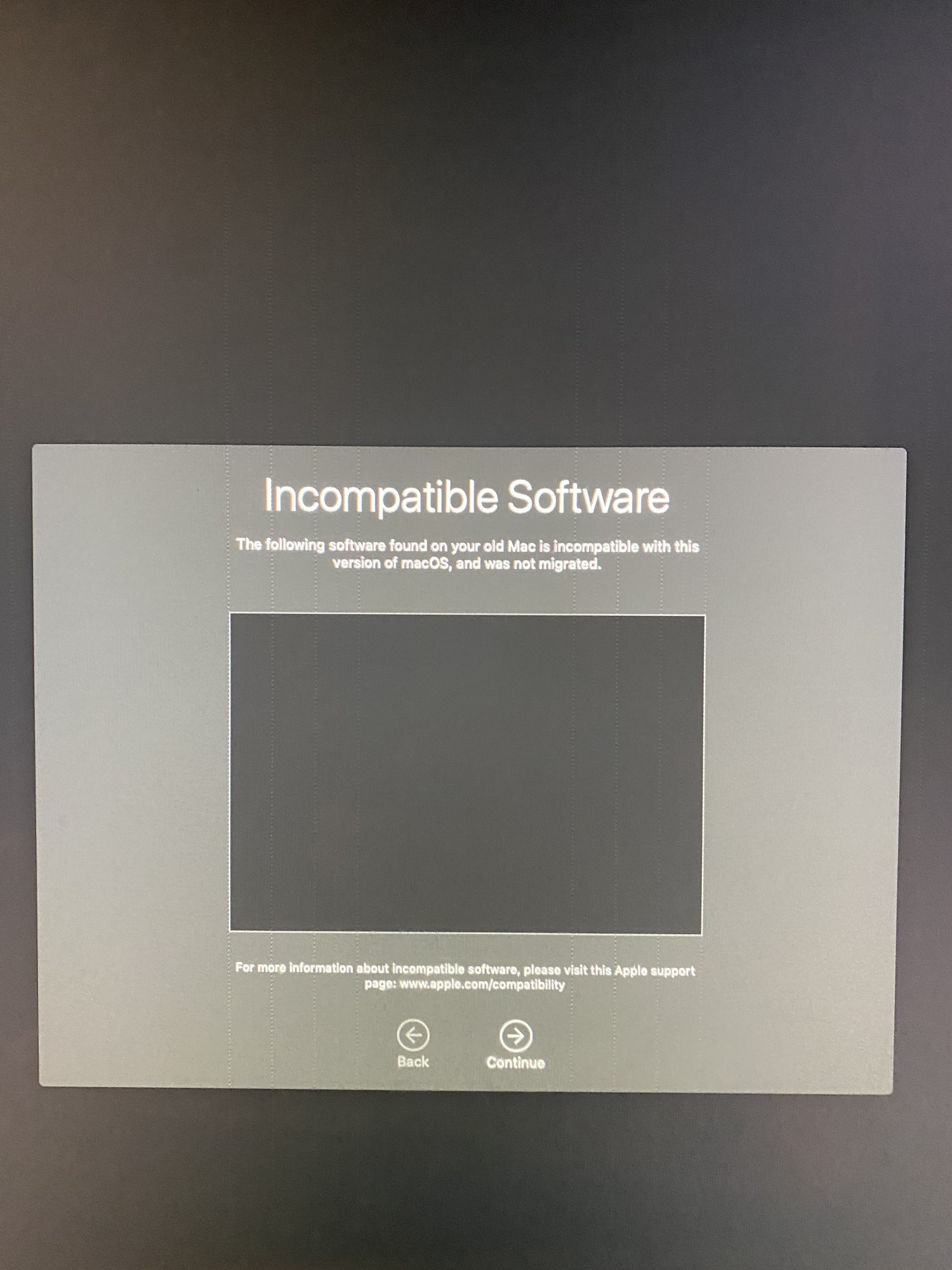

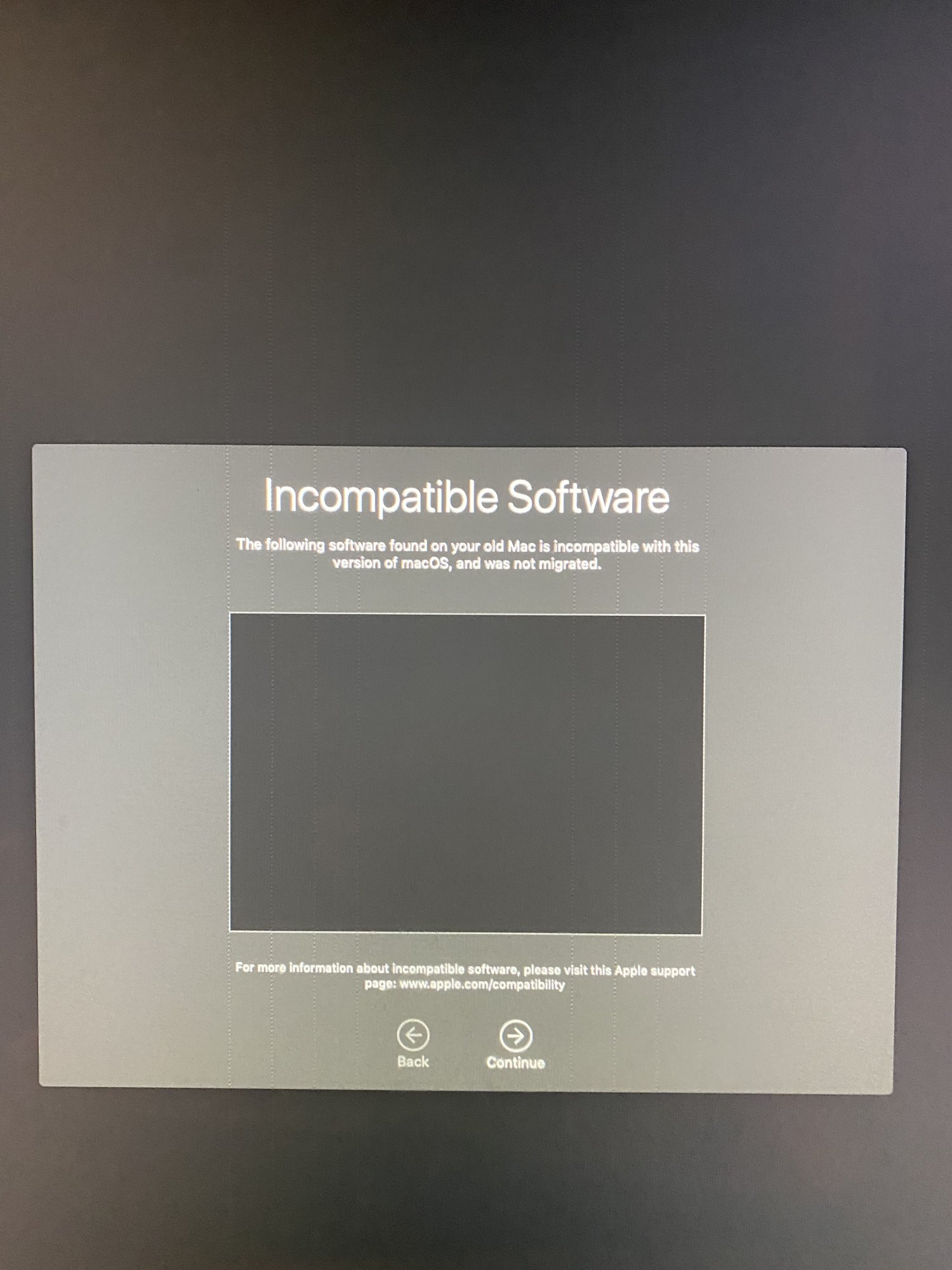

I don’t want to speak too soon for anyone else, but I use only wired. I’m reinstalling Mojave after some ****up open core did, glad I never used the same drive. Anywho yeah, now every time I get past the install it asks me to turn on my mouse. Note the line that runs to the bt on the logic board is snapped. Never thought I needed latency on a mouse or replace bats again. Pretty cool stuff.
Again, awesome!
edit: i chose z for boogie woogie 👌
