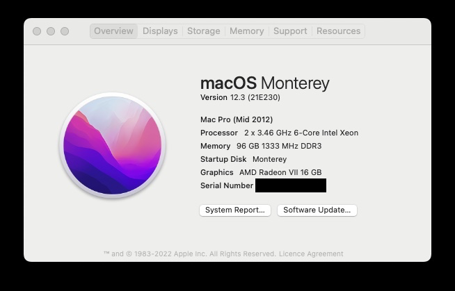

Slightly nerve-racking upgrade, but all working fine with the Dortania ASPP-Override.kext. :)
No need for VMM, SurPlus or MonteRand, just make sure the codeless kernel extension is added to EFI/OC/Kexts and the entry shown in @mike.101's post is in your config.plist. My system rebooted three times, once from 12.2.1 into the update, once after the update completed the main installation, then once again after sitting at the Apple logo for a bit on the first 12.3 boot. Couldn't see what that last one was about, as we'd left verbose boot. All completely hands-off from clicking "update" in System Preferences.

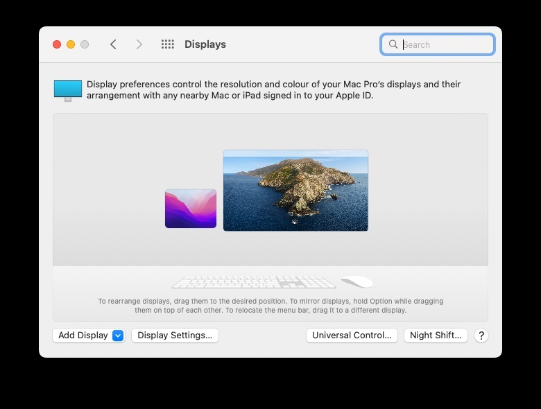

EDIT: Oh my word, Universal Control works with my iPad Pro! I was not expecting that.
NB. Not the display extension stuff that requires the Intel graphics hardware, but "link keyboard and mouse" works great. Just a shame my old iPad Air 2 isn't supported, but I'll take what I can get!
