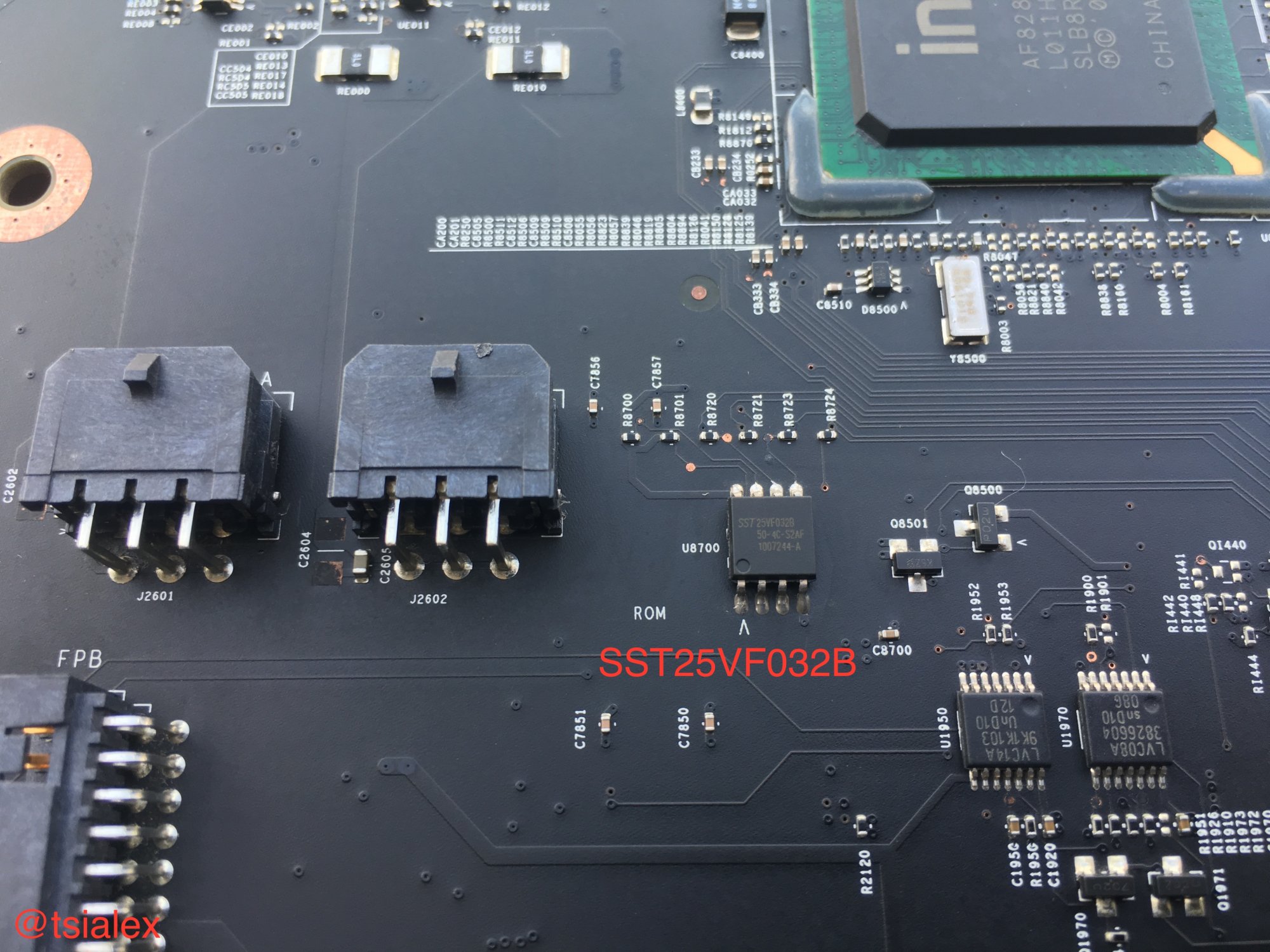

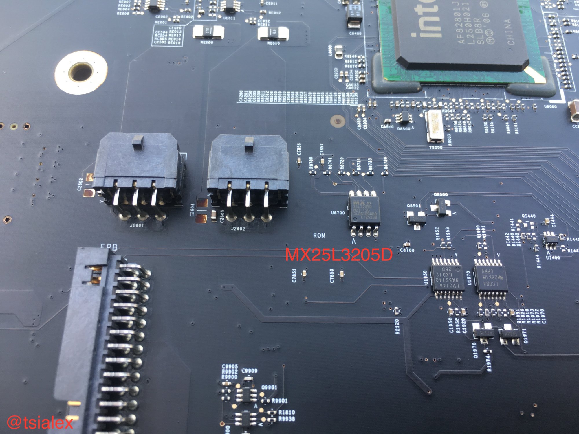

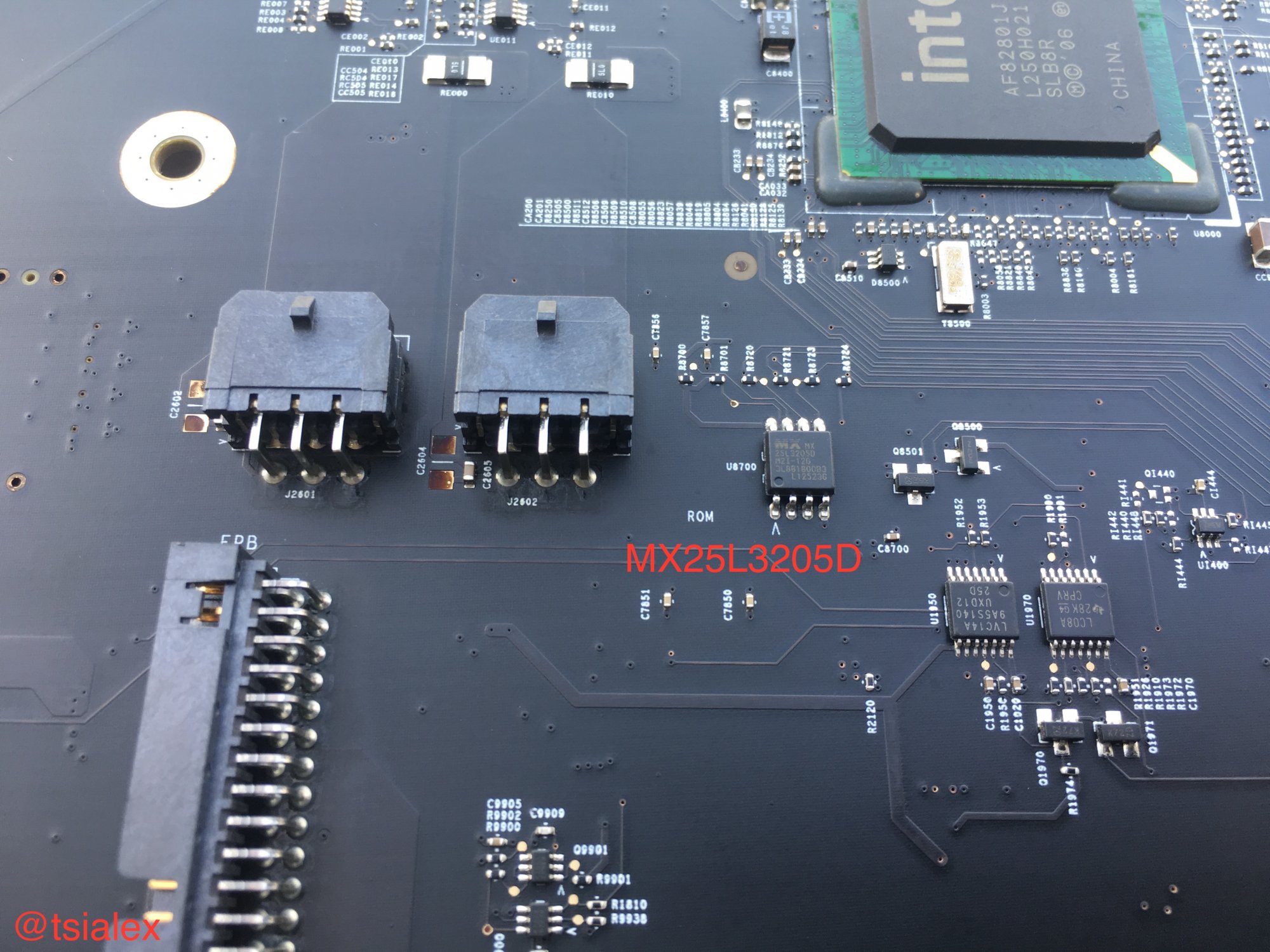

To flash a backup BootROM image you will use ROMTool (zip file password is rom) from a supported macOS (10.9 to 10.14, don't use Yosemite) and SIP needs to be disabled. Never flash booted from OpenCore.
First enter Firmware Programming Mode correctly.​
  1. Shutdown your Mac,
  2. Press and keep pressed the power button,
  3. You will hear a loud beep, keep pressed,
  4. You will hear the startup chime (if your Mac still has it, some Macs lost the chime with MP51.0087.B00), release the power button when it ends or when starts loading macOS (if your Mac lost the chime).
Boot your supported macOS install, after you login you can proceed to the flashing process with ROMTool.
Open ROMTool:
  1. Click "Flash System ROM",
  2. Open your back-up BootROM dump.
  3. Flash it*,
  4. Shutdown your Mac Pro.
  5. Remove the power cable for at least 20 seconds to reset the SMC controller.
  6. Connect the power cable and power on your Mac Pro.
*If ROMTool asks you to confirm what is the model of your SPI flash, it's the 8-pin SOIC flash memory next to the PCIe AUX-B power connector, label U8700 - see the photos below. The model of the SPI flash memory is usually related to the model year:​
  • with early-2009 almost all backplanes have SST25VF032B,
  • with mid-2010 usually is Macronix MX25L3205A or MX25L3205D, sometimes can be MX25L3206E with mid-2010s made in the 1st half of 2012, very rarely is SST25VF032B,
  • with mid-2012 usually is Macronix MX25L3206E, it's not common to see mid-2012 with MX25L3205A or MX25L3205D.
  • If ROMTool don’t ask you the SPI model at all, Apple used a SST25VF032B.
