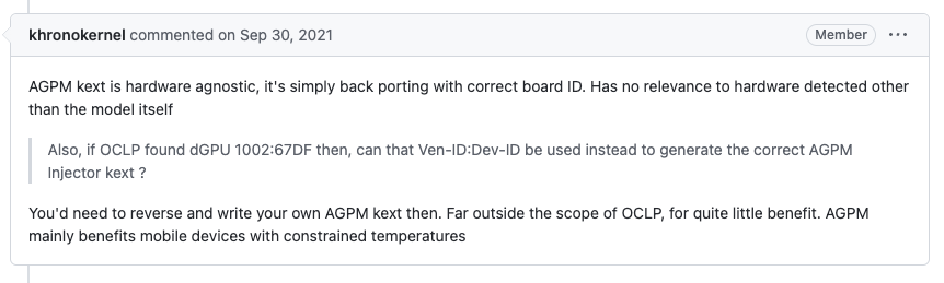

You can read about AGPM-Override here:
The kext appears to set up parameters for the original Nvidia card (GT 120). I'm not sure it is actually needed.

In that linked thread, this reply indicates the AGPM override kext isn't useful, at least wasn't back in September 2021:
But if one was to add it to their OC config, then should the board ID in the kext's plist file be the "native" one for your Mac Pro (i.e., MacPro5,1) or for the board being spoofed in the OC config ("Mac-27AD2F918AE68F61" if this guide has been followed).
