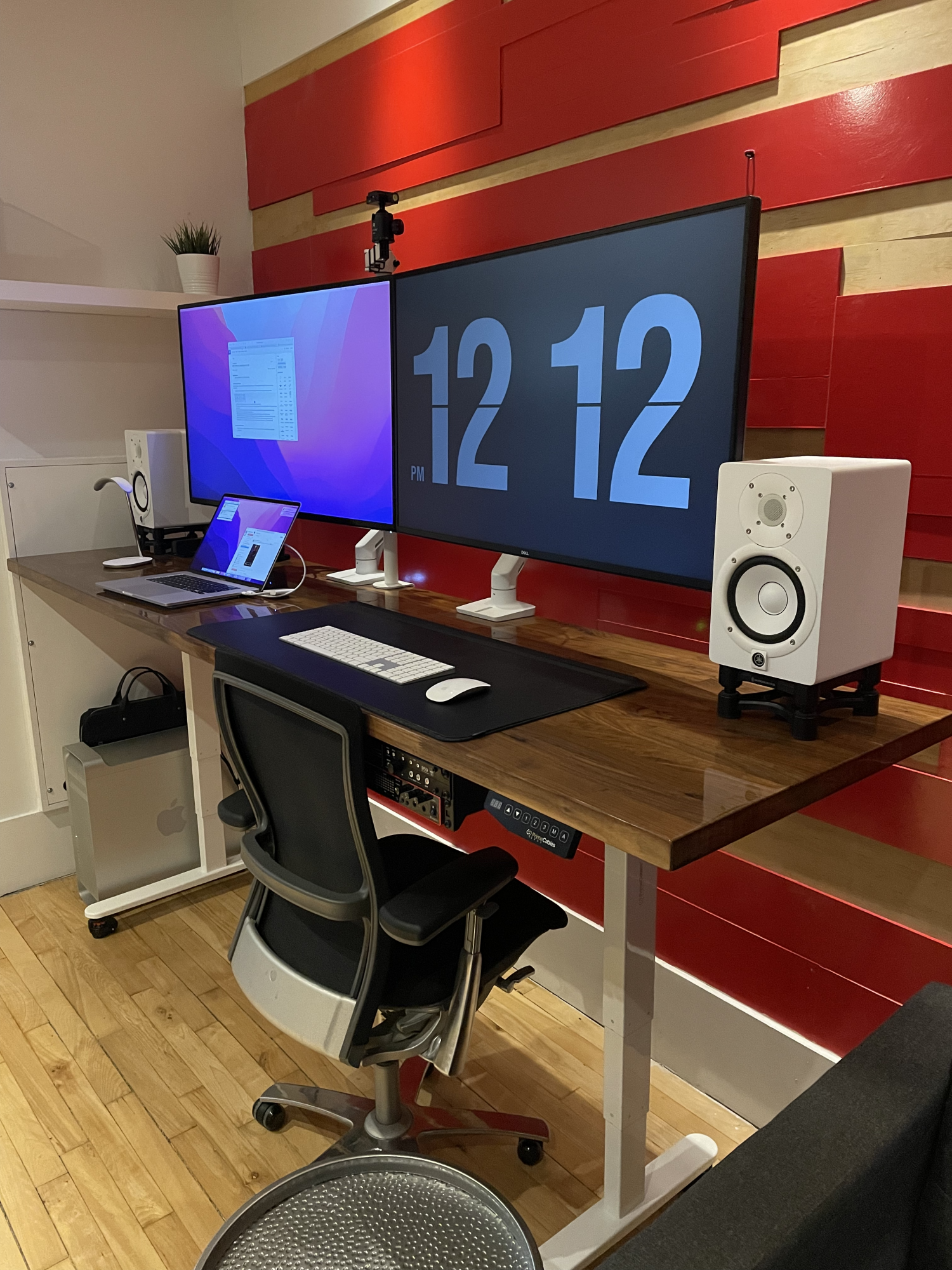

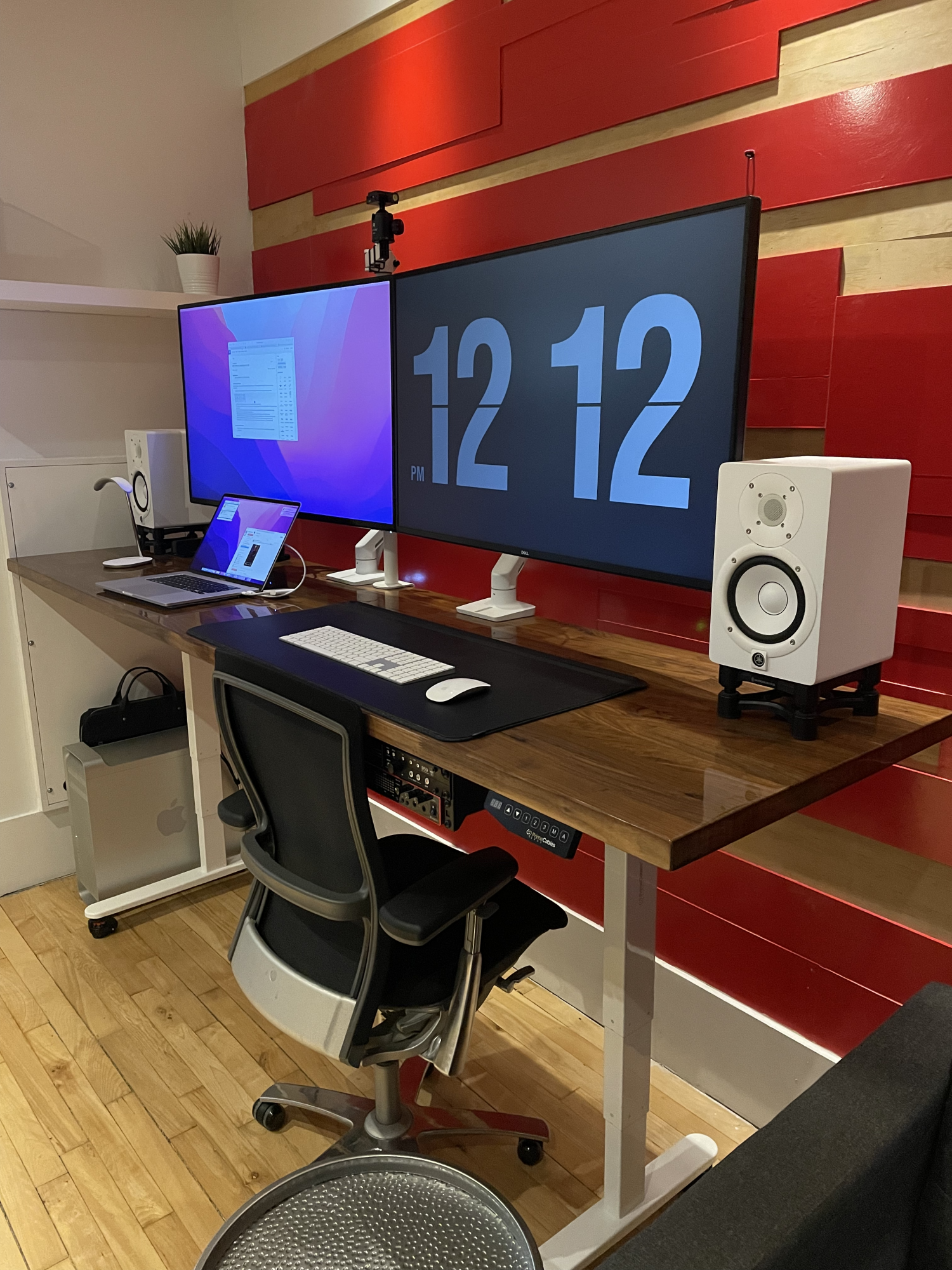

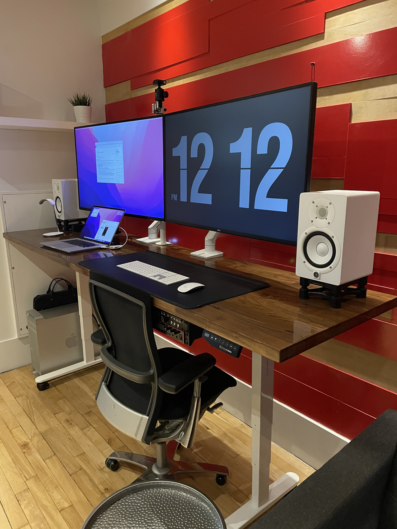

No issues with Dell U4320Q monitor internal speakers connected through Monoprice 8K Certified Ultra High Speed HDMI cable into RX580 GPU in both macOS Monterey and Windows 10. I also have a Scarlett 18i20 interface connected to Yamaha HS5 studio speakers and my CMP with a 10feet USB-C cable. Everything works properly.

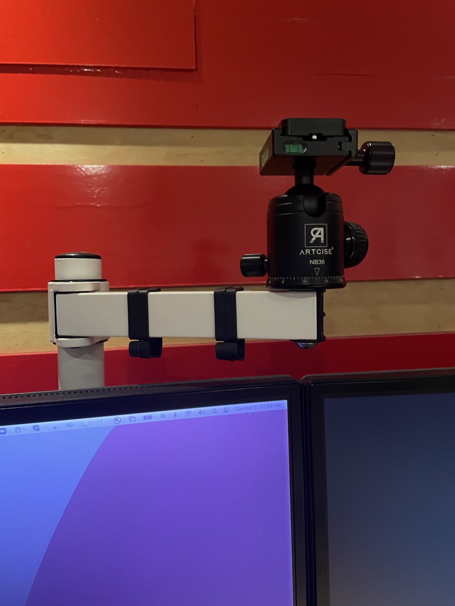

Is that a webcam over the two displays?

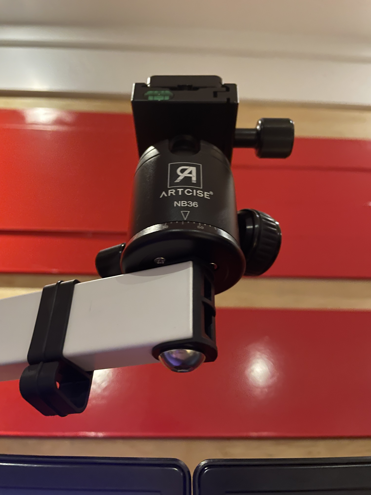

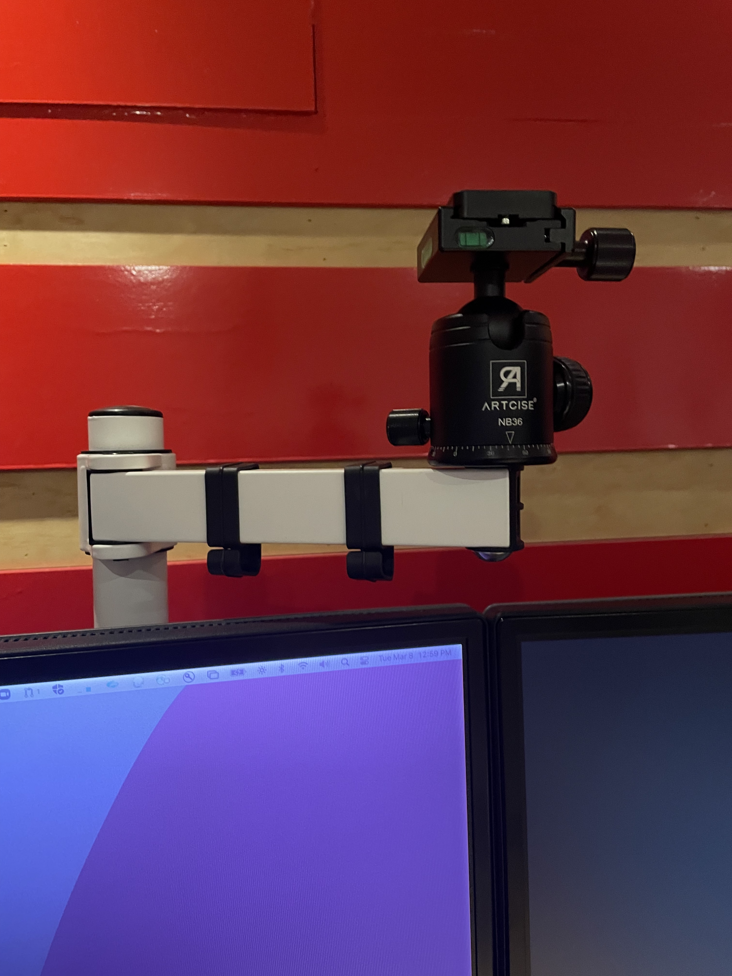

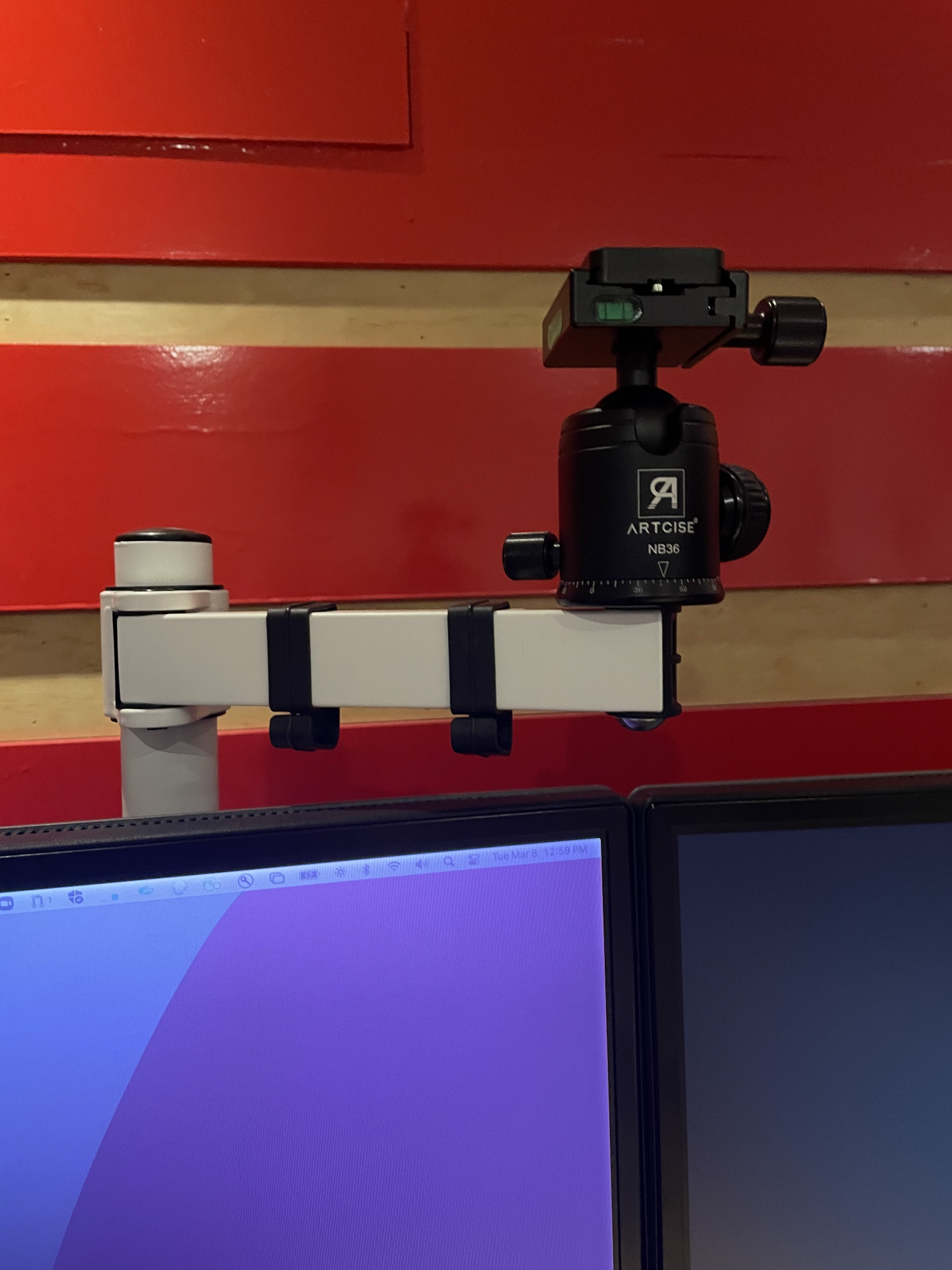

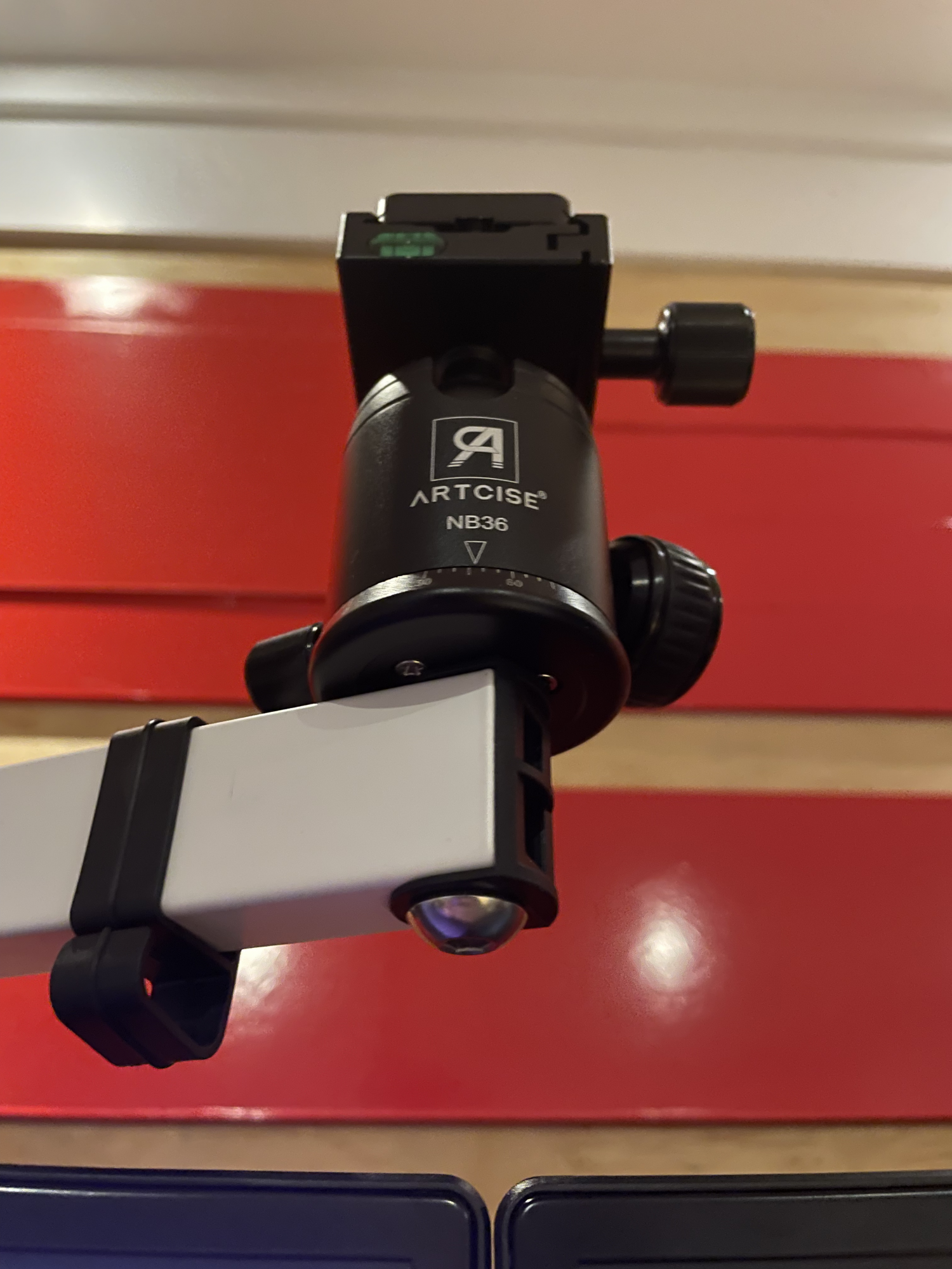

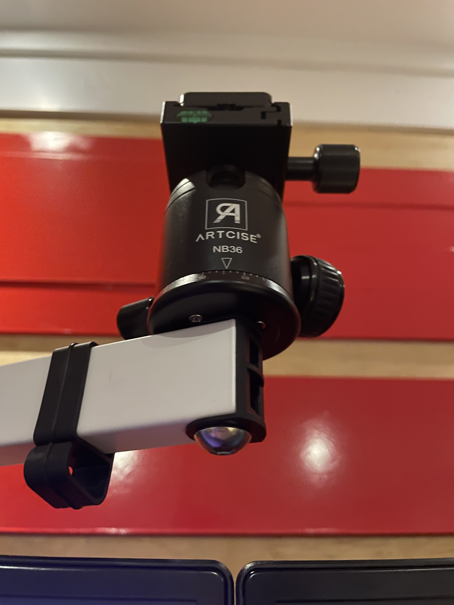

That's a mount I built for my DSLR camera, so I can do video conferences for work or film the desk when I make music or mix. Parts:
  • Wali M001WX-W monitor arm (modified to mount a DSLR camera)
  • Artcise NB36 camera mount (attached with a 3/8-16 1-1/2" button head bolt to Wali arm)
I removed one extension piece of the Wali horisontal arm to keep everything stable, the NB36 mount allows you to tilt the camera down to 90 degrees. To fit the button head bolt through, you use a drillbit to enlarge a little the plastic cap, it is very easy. The hole design supports 20kg, very stable.

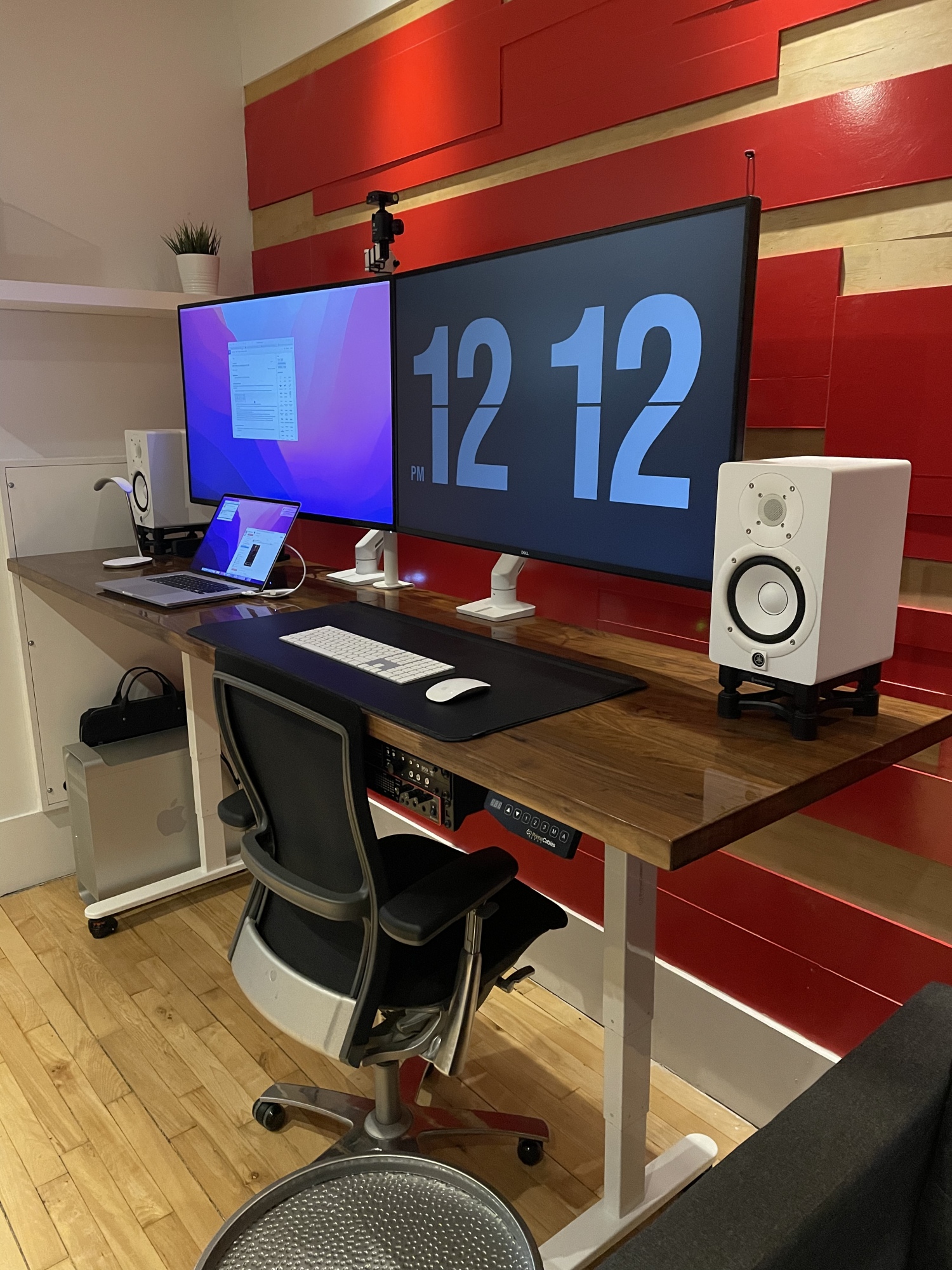

As a side note, it took me 3 months to build that table. One month was only to apply 12 coats of oil based polyurethane (one per day), let it cure for 2 weeks, then polish the wood top up to 3500 grit, to make it look like glass.
Thanks! I might do something like this myself.
Looks great!

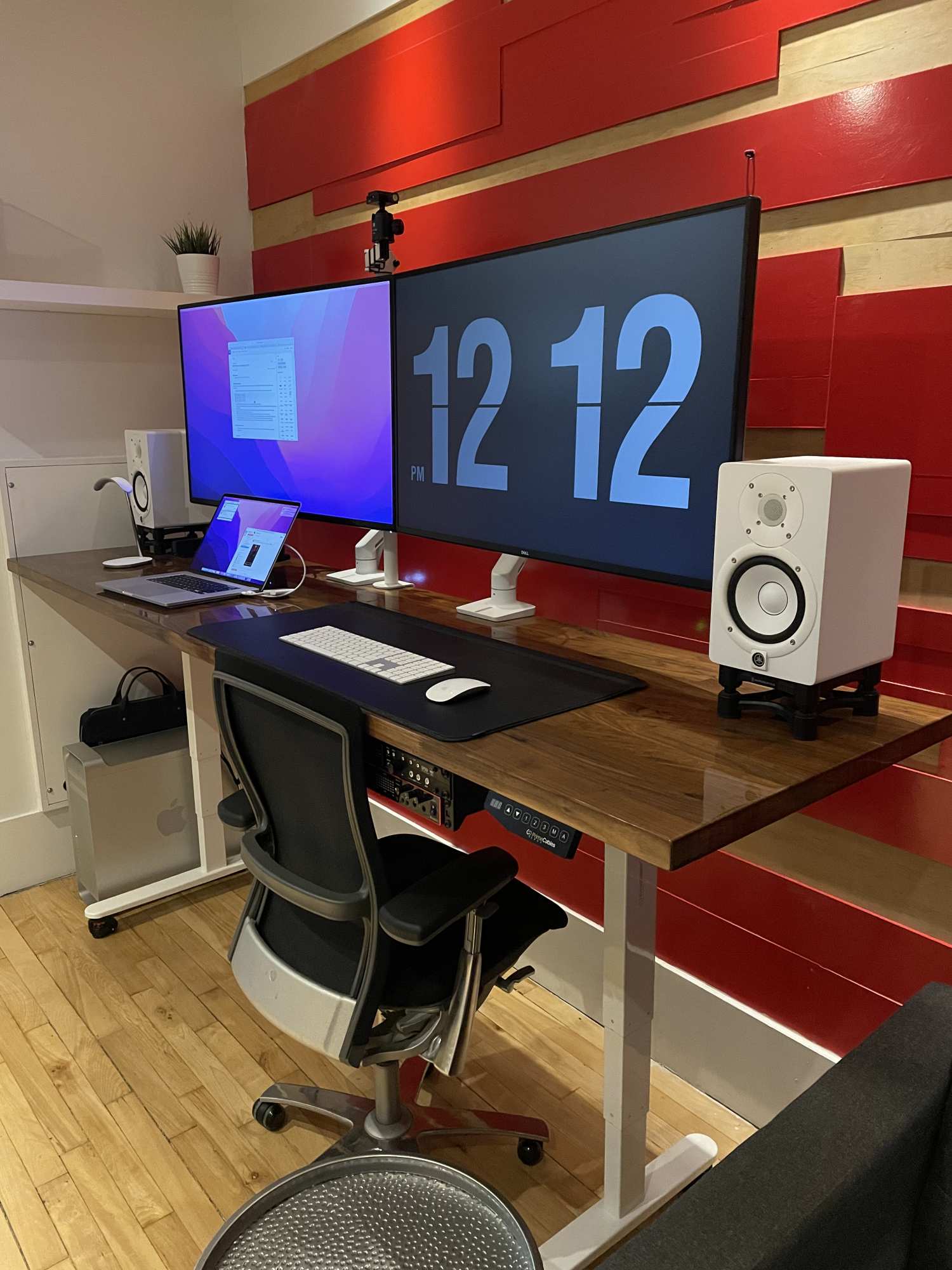

That desk is absolutely gorgeous! Great work on that.
Reactions: NC12

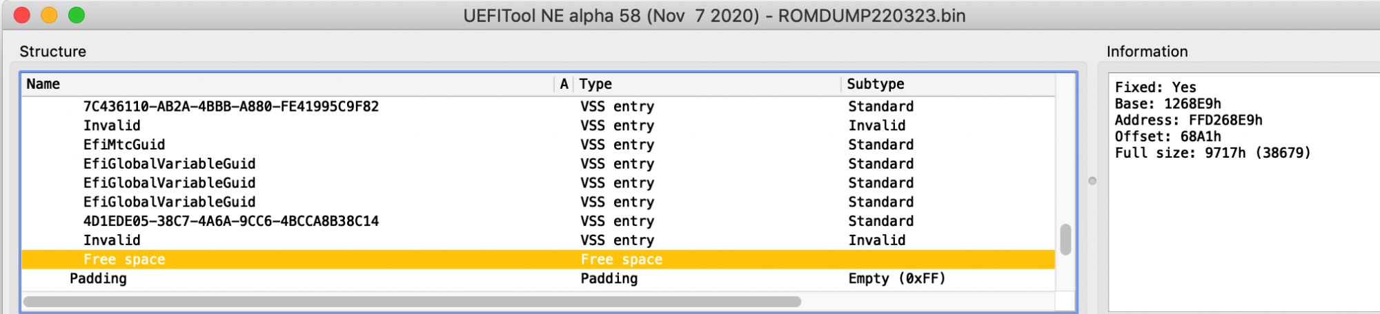

Thanks yea I was forgetting to drag the ROM bin into UEFI tool...where can I find your tool BTW?
Alright I was able to re-flash my bootRoom with my never-booted image...and using UEFI tool, it looks normal for my 96GB configuration:

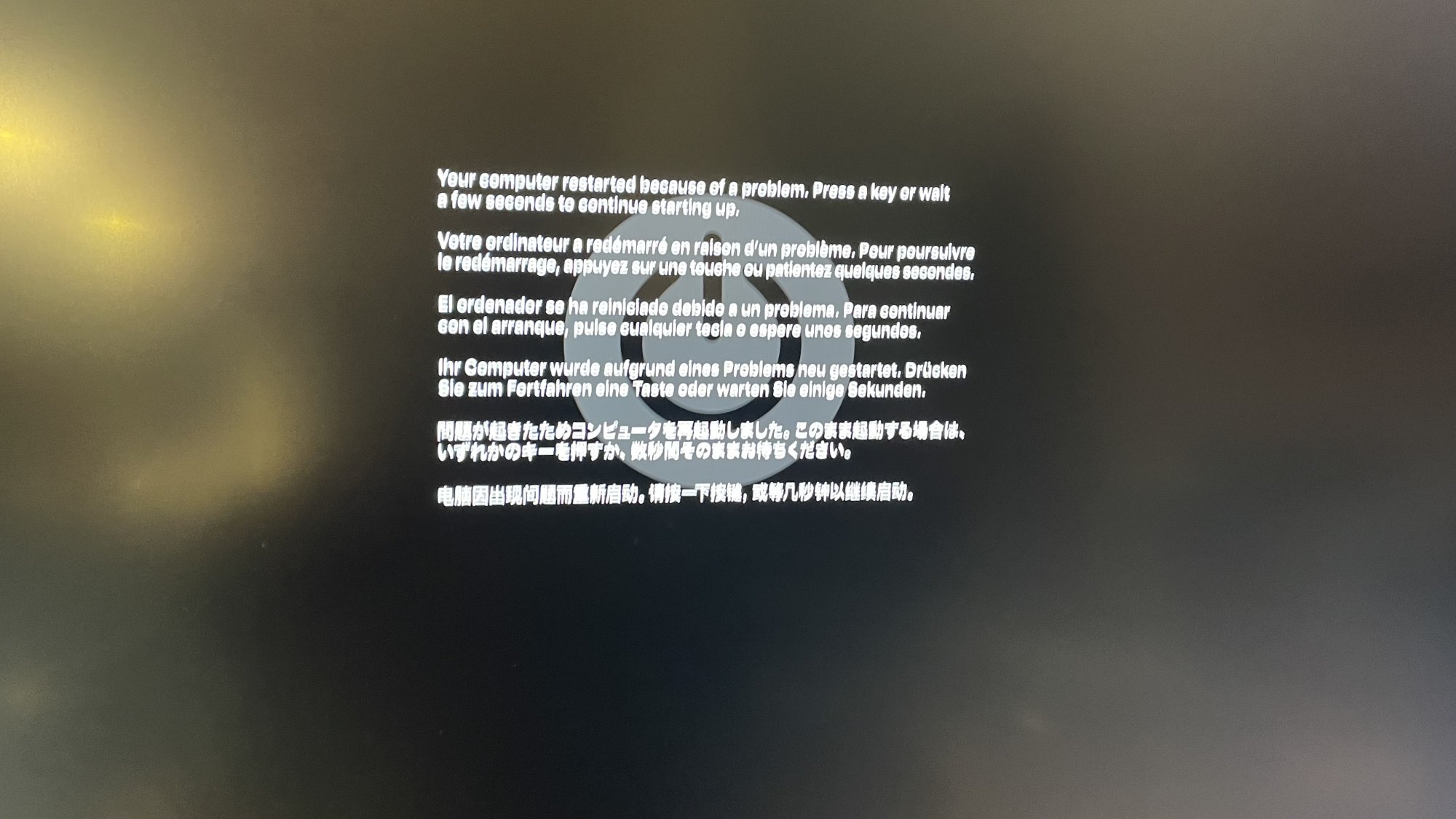

However, both before and after doing that, I am getting the following kind of thing from time to time. Before re-flashing it even happened once when I tried to boot to Mojave without OC.
When I first updated OC to 079, including the ASPP-Override.kext, it seemed to work fine. When I attempted to turn on VMM mode, I immediately get this when trying to boot Monterey (12.2). I tried several times to boot and after even turning off VMM, it still gave me this message, but then sometimes would boot after that anyway... I don't know what all is causing this. It all started since I updated OC79 and then previously attempted 12.3 update.
Anyone have any ideas? I have attached my current config.plist (one with and one without VMM)
