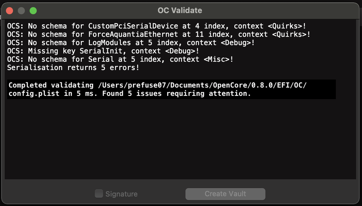

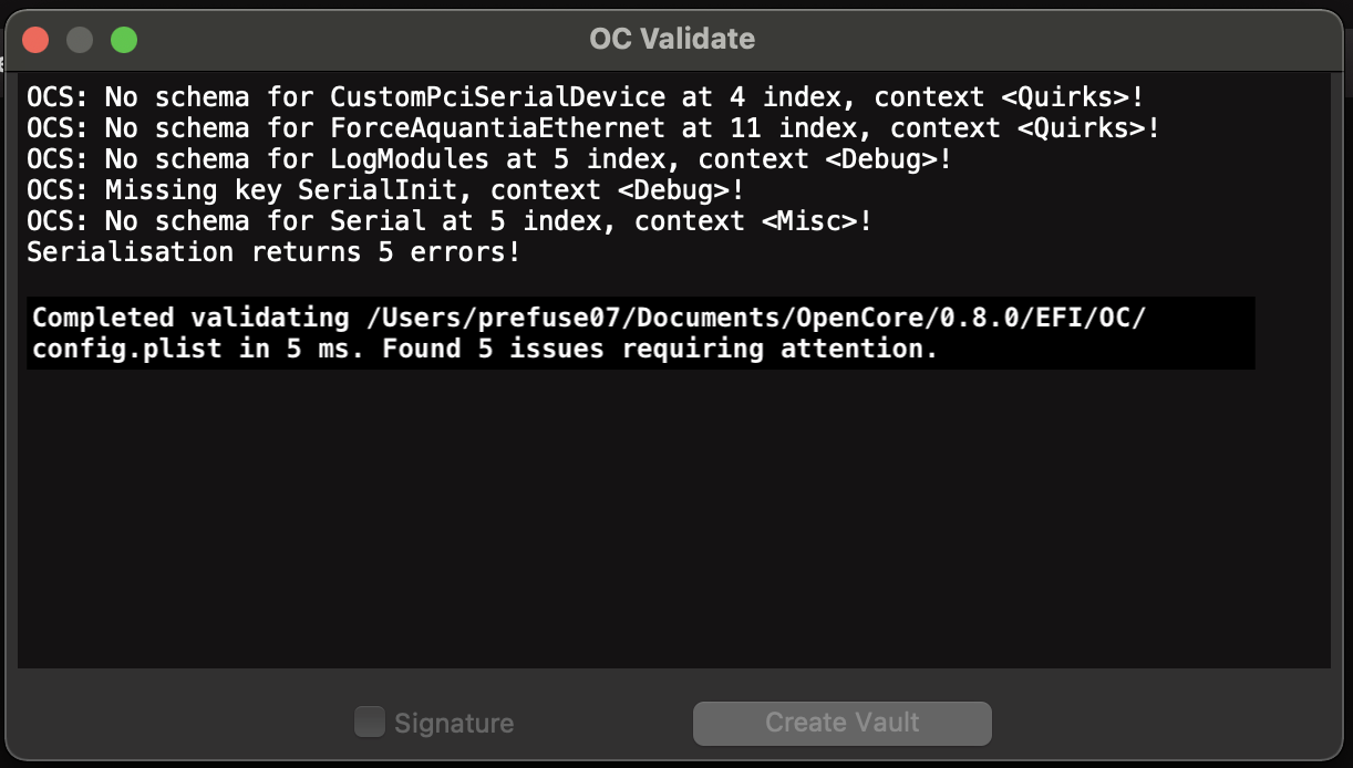

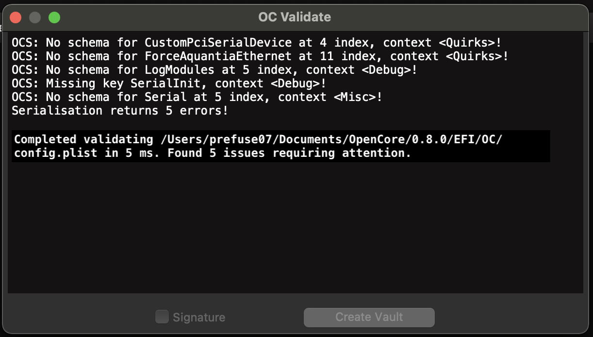

I am coming from 0.7.7, so when validating my config via OCAT, I am getting the following errors (which I suspect are some of the new additions that were not present in 0.7.7, because it runs absolutely perfect):
Any tips on what values I need to input into the 0.8.0 config for the errors being thrown above?
My 0.8.0 config is also attached, if that helps, and as always, I did use the updated config that you provide in page 1/the guide (I always do that when updating to a new ver).
Your config looks good. I think the problem is that OCAT is using an older version of ocvalidate. Note that if you ever want to update macOS ≥12.3, you'll need to add the ASPP-Override kext.

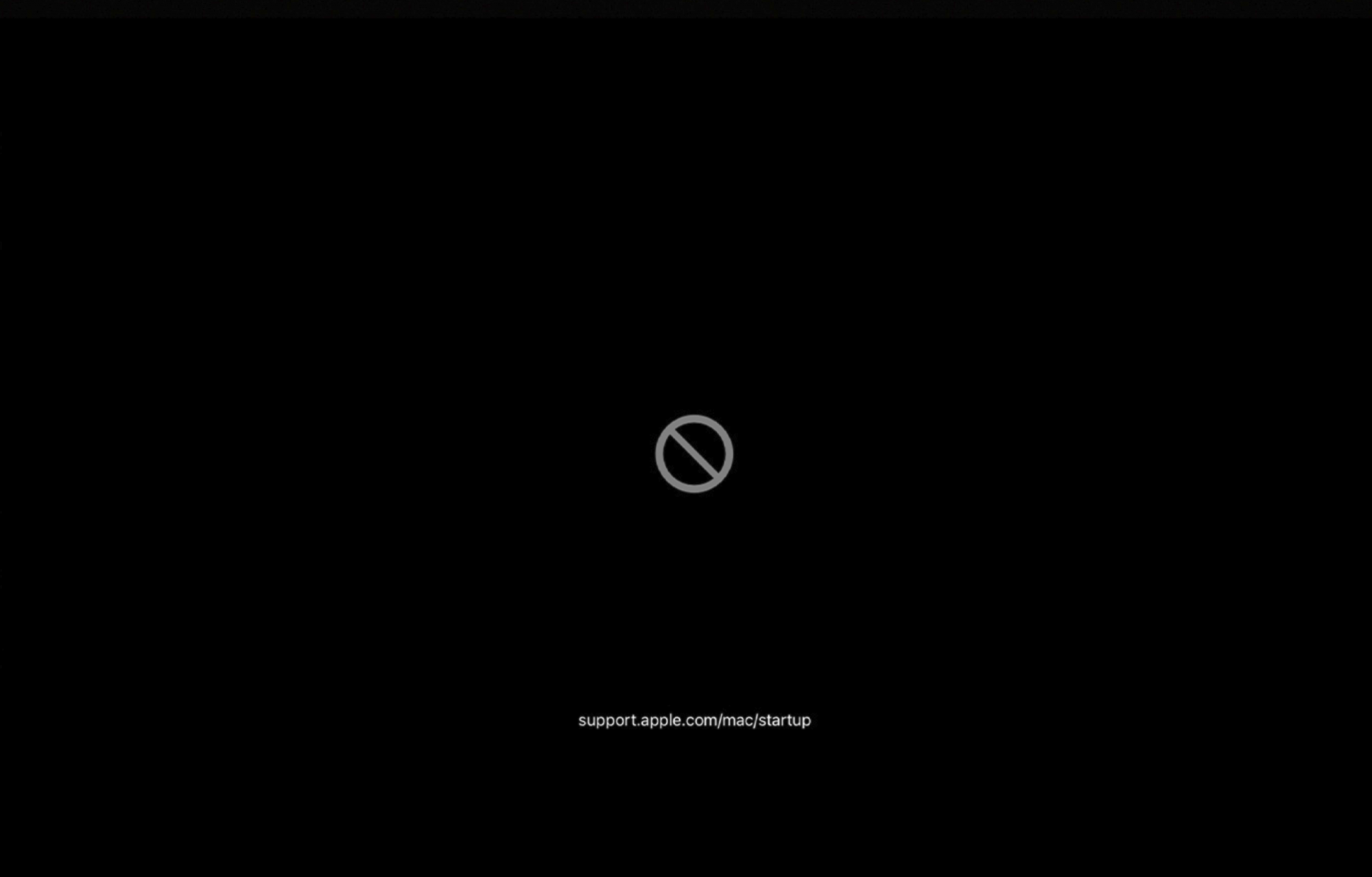

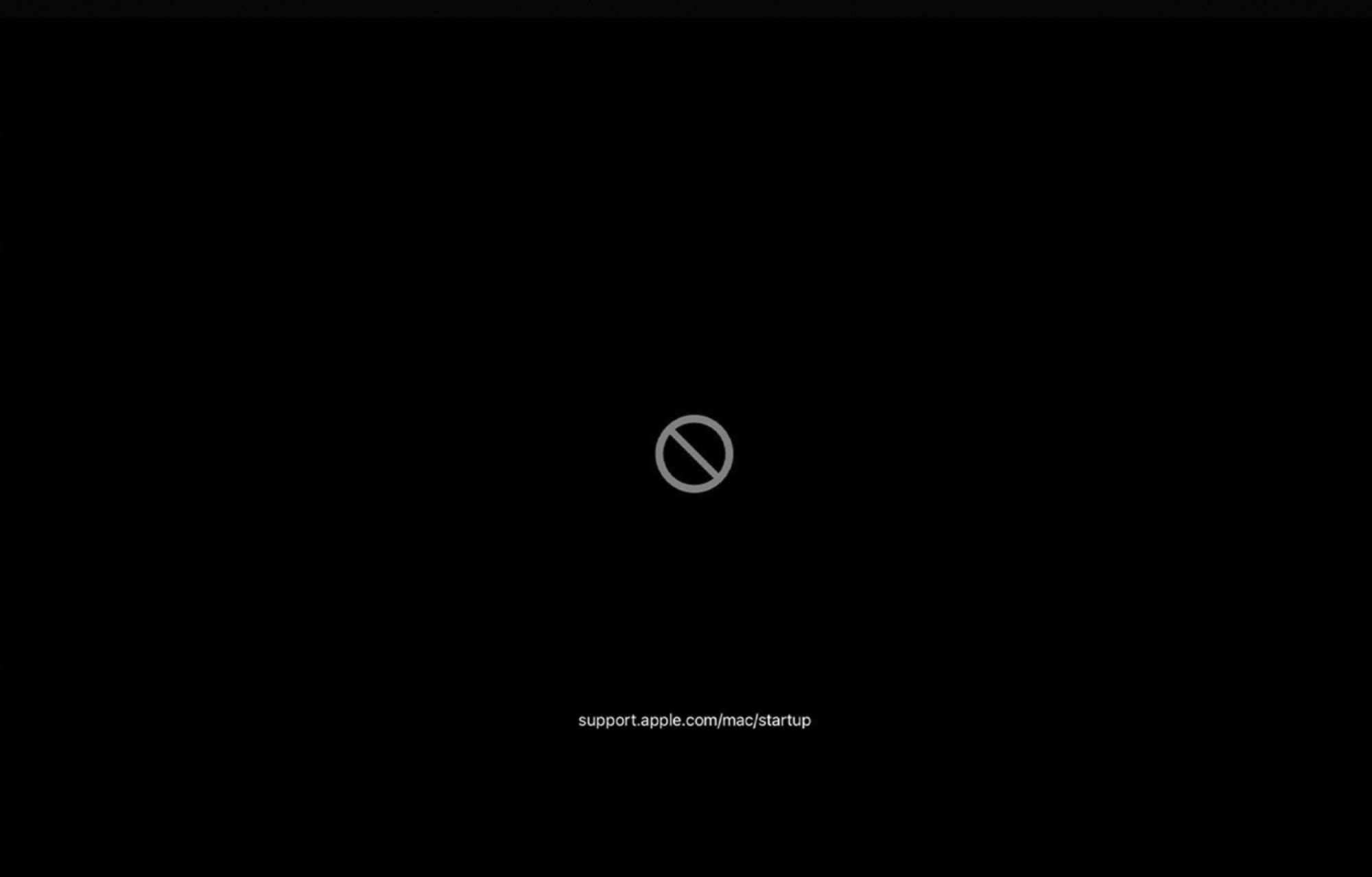

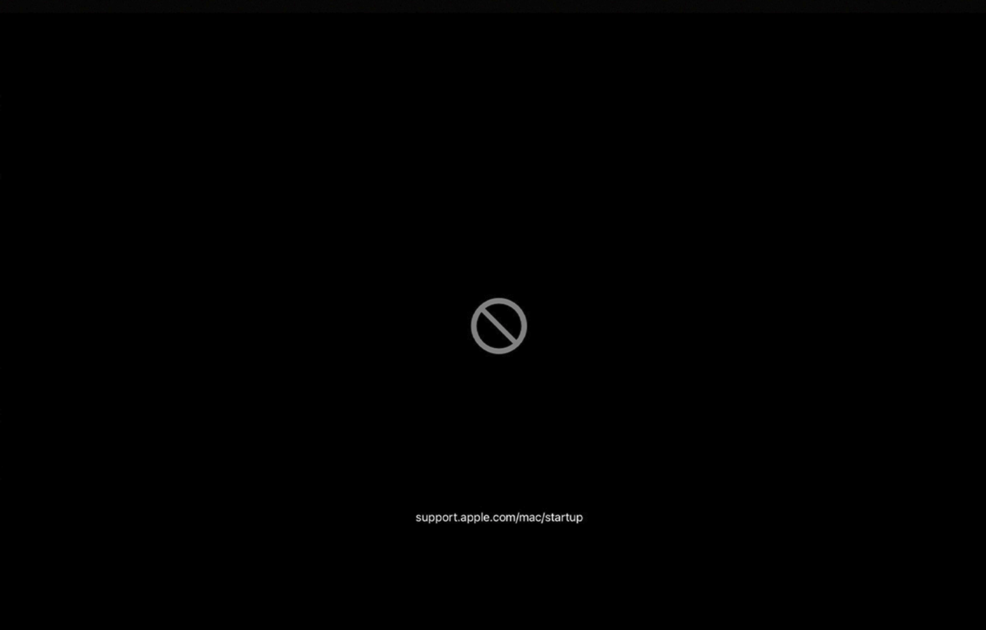

Trying to update to 11.6.5 isn't going so well, however... I've got SecureBootModel set to Default, Hybridization, and even tried enabling the VMM Flag, can't get past the Apple logo during boot after selecting MacOS Installer...
Do we need the ASPP-Override kext to update to 11.6.5, or just for Monterey?
Edit: After experiencing some weirdness (crossout @ boot, followed by: "apple.com/startup") Per this explanation , I think i'm just gonna hold off on 11.6.5 for now...

Well in the spirit of "take 2 aspirin and call me in the morning"...
You might try doing a deep NVRAM reset (5 chimes) and also reblessing your efi/OC install.....

yup, I did exactly that, and 0.8.0 is working perfectly, but i'm still holding off on 11.6.5 until I do more research -- that (/) + boot loop/kernel panic was scary as hell! (bricking is my biggest fear, even though I have a MATT card and rebuilt ROM that I regularly reflash).

Anyone else getting random prohibitory symbols after updating to 11.6.5? or perhaps on Monterey?
Was in Windows for a while, then tried to come back to MacOS, the apple logo was super slow in loading up, then ^ hit, and the computer was just stuck, so I had to do a manual reboot.
I booted into recovery and ran repair on my Mac SSD, and then rebooted and OC was finally able to load MacOS, but I read a post from @tsialex that this is common with 11.6.5 and 12.3.1?
I just reflashed my BootROM as part of my usual routine a few weeks ago, but now I'm wondering if I should do another deep NVRAM Reset and then reflash it again, now that I am updated to 11.6.5? Also thinking about setting SecureBootModel = Disabled, but I really don't think that's necessary..... and maybe not the root cause for this?...
In my previous tests, this happens only while you still have all the payload from the updates inside the VSS store, if you deep reset the NVRAM, or reboot with sudo nvram ResetNVRam=1, the payload is removed.
If you removed the staging and still have problems, my bet is on a config.plist error.
No need to re-flash if you successfully deep reseted the NVRAM, or did a reboot with sudo nvram ResetNVRam=1, and now have the expected VSS available space. If you don't want the trouble to check, you can always re-flash the never booted BootROM image and move on.
