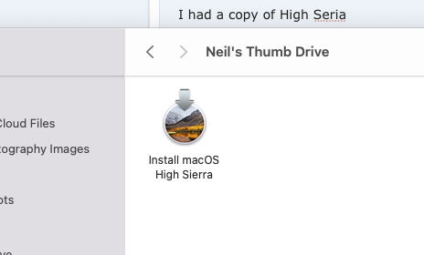

I had a copy of High Sierra in my Applications folder, I put that on a formatted thumb drive and was planning on using that to reinstall the older OS.........problem is I don't know the steps to follow to be able to do that
Search the web with "how to install high sierra from usb" you will get tons of answers, even YouTube videos.
You have to make a bootable installer for example with balenaEtcher, then boot from that usb stick and do the install process.

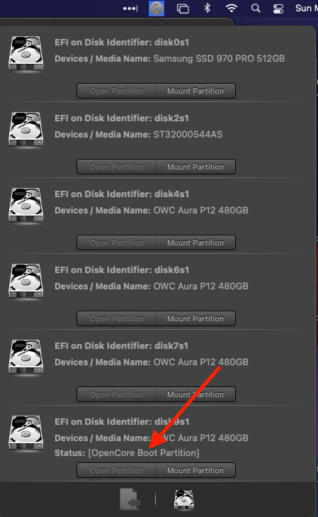

Did you verify that disk0s1 is actually your ESP with the "list" command first? The identifier can change from one boot to the next.
OpenCore configurator shows the drive with the bootloader, which can be easily mounted:
