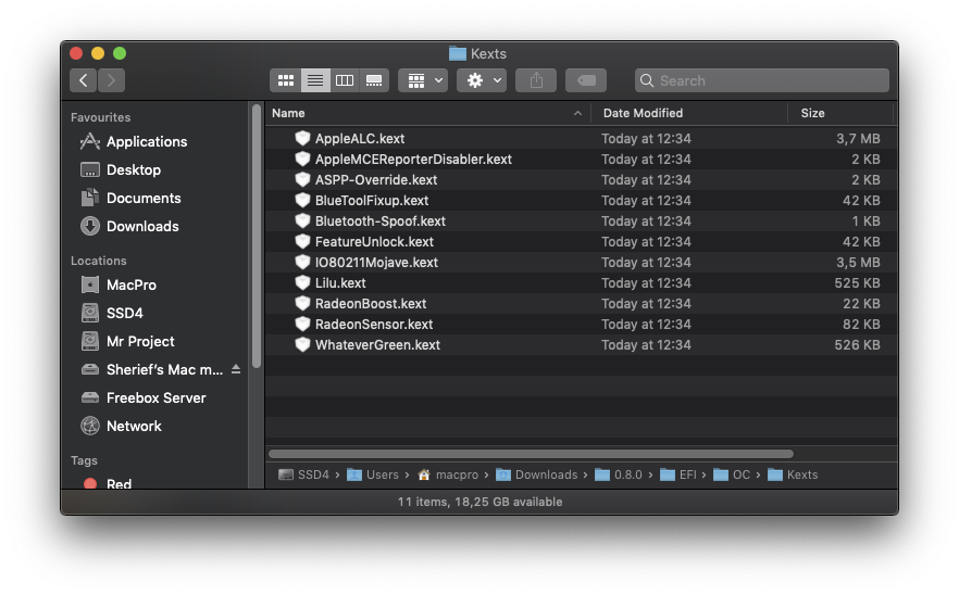

Second and most important question, since I'm in the OpenCore thread: I downloaded the latest Martin package, 0.8, and haven't installed yet. Looking at the kext folder, I'm amazed! What happened to it? Mine has 3 kexts, the new one has many more! (Wifi, bluetooth, etc). What's the purpose of them? Monterey? I'd rather keep things simple, as simple = stable in my world...

It keeps on growing to accommodate the plethora of possible scenarios. If simple is your thing, then I encourage you to create a minimal deliberate setup using post #1. If your wireless hardware is supported, then you should just need one extra kext (ASPP-Override) to update to the current version of Monterey.
Looking at the Kexts folder in 0.8, and doing some research, it seems that I can remove ASPP-Override, BlueToolFixup, Bluetooth-Spoof, FeatureUnlock, RadeonBoost and RadeonSensor if I'm going to stick to Mojave and Big Sur - I have a Vega 54 and I don't need Sidecar
Correct?

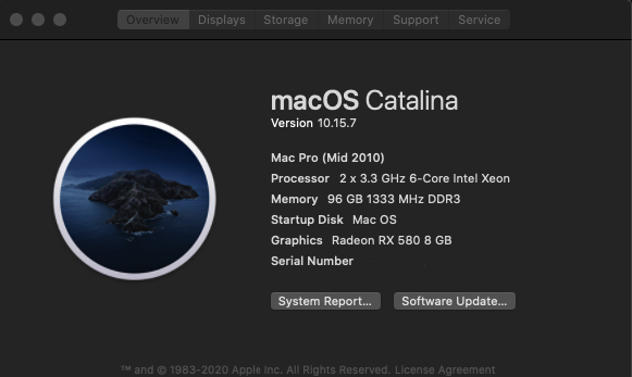

Hey there,
About 2 years ago with this communities help and by following this guide I was able to add Opencore, and run both Catalina and Windows running on my CMP 5,1. Thanks once again for that without this guide and the communities guidance I wouldn't have been able to do that.
I have been happily using my CMP in both 10.15 Catalina and Windows since then but haven't really done anything to update OpenCore or my Mac OS. Now after 2 years I have an incentive to upgrade my MacOS to MacOS Big Sur or Monterey if possible.
I get the prompts to upgrade to Monterey but is it that simple or will I need to make additional changes to OpenCore or the System configuration itself?
if I do need to do more than simple install the new OS and follow simple prompts is there a separate guide you could point me to too follow or a part of this amazing guide that I should follow?
Here are my current system specs if you need any other info let me know and probably let me know how to get that info for you as you can assume I am a little clueless
Thank you in advance for any assistance you can provide
