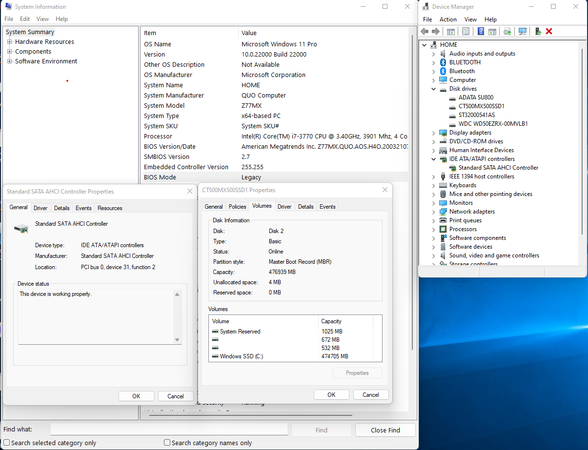

Still not clear. You need to elaborate. Here is a screenshot of Windows 11 in Legacy mode with AHCI controller.
