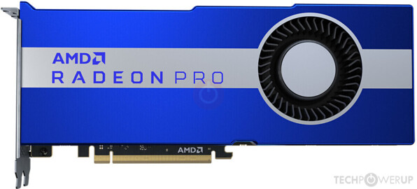

Hi all! I got a Radeon Pro VII
The latest version of Mojave cannot use it with acceleration, although the graphics adapter ID is in the kext plist. Only in Catalina I was able to get a acceleration
My question is does anyone have any idea how to get acceleration in Mojave?

There you go bud, for your personal knowledge, techpowerup has a very good GPU database 👍
Specs for:
Radeon VII
Radeon Pro VII
We Spoofed device-id to Radeon VII (0x66AF), but still it is identified as Vega card.
@h9826790 Can you please post your config file for Radeon VII with injected properties? Thanks.

If you want to spoof the GPU name, all you need is just
Code:
<key>model</key>
<string>AMD Radeon VII</string>
Of course, you can make it
Code:
<key>model</key>
<string>AMD Radeon Pro VII</string>
For info, it's better to keep the prefix AMD, otherwise, some software (e.g. VideoProc) may not able to show the GPU ident properly.

Thanks. This is the SSDT for Radeon VII Pro (it attaches through 3 bridges to GFX0):

I skipped the power table because it will be probably different (will it?).

Sure don't copy the PowerPlay table. Even another Radeon VII should test that settings before inject via OpenCore.
