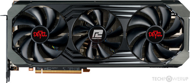

I'm having a black screen issue with my new 6900 XT. The bios rom was exported using GPU-Z and was then patched using Syncretic's patcher tool. I then flashed the card with amdvbflashWin successfully. The card works great in Windows 10 on the Mac Pro 5,1 but it "halts" around 50% progress bar in Monterey showing a black screen instead. It boots in Mojave but with unsupported graphics (as expected). When I boot into safe mode (-x flag) on Monterey the graphics card shows as "AMD Navi21 16 GB"
Lilu and Whatevergreen is included. I use @h9826790's 0.8.0 package, it worked perfectly fine with my previous card (5700 XT) which was natively supported though.
Here is my boot arg:
-lilubetaall -wegbeta agdpmod=pikera enable-gva-support shikigva=80 unfairgva=1 mbasd=1 -wegtree -no_compat_check no32exec=0
This is the card I use:

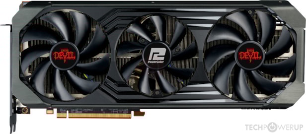

It's really a 6900XT or it's a 6900XTH that is yet incompatible with Apple NAVI drivers (different PCIe id)?
Ah OK so that's it. Is compatibility expected or should I just go for another card?
Can't answer that, maybe Apple will add it in the future.
Some people with hackintoshes spoofed the original 6900XT PCI id to make a XTXH card to work with the current NAVI drivers. You will also need to do the same thing. Search the usual hackintoshes forums for the recipe.
Thanks a lot, will take a look at that!
