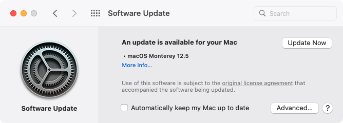

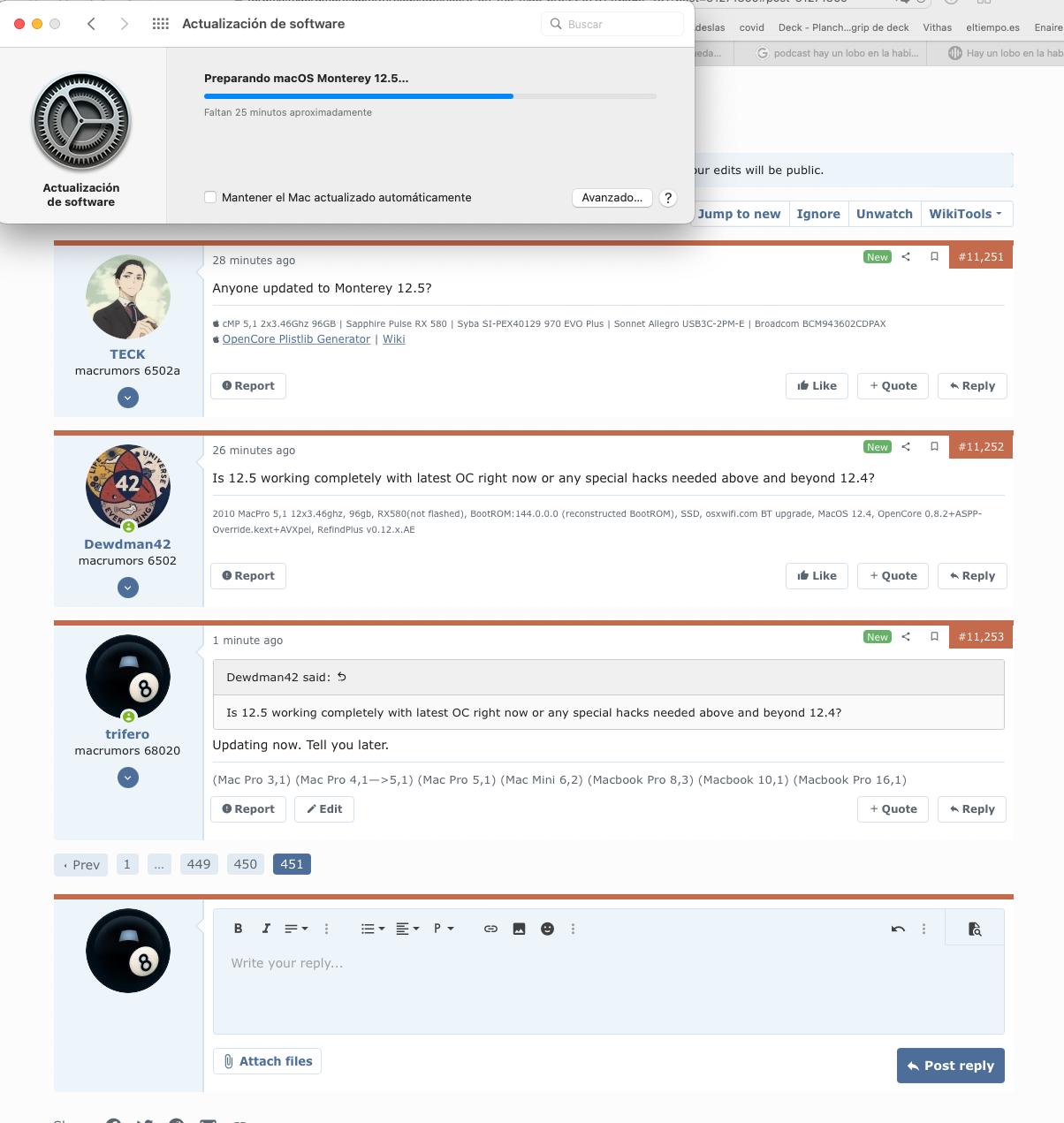

Is 12.5 working completely with latest OC right now or any special hacks needed above and beyond 12.4?
Updating now. Tell you later.

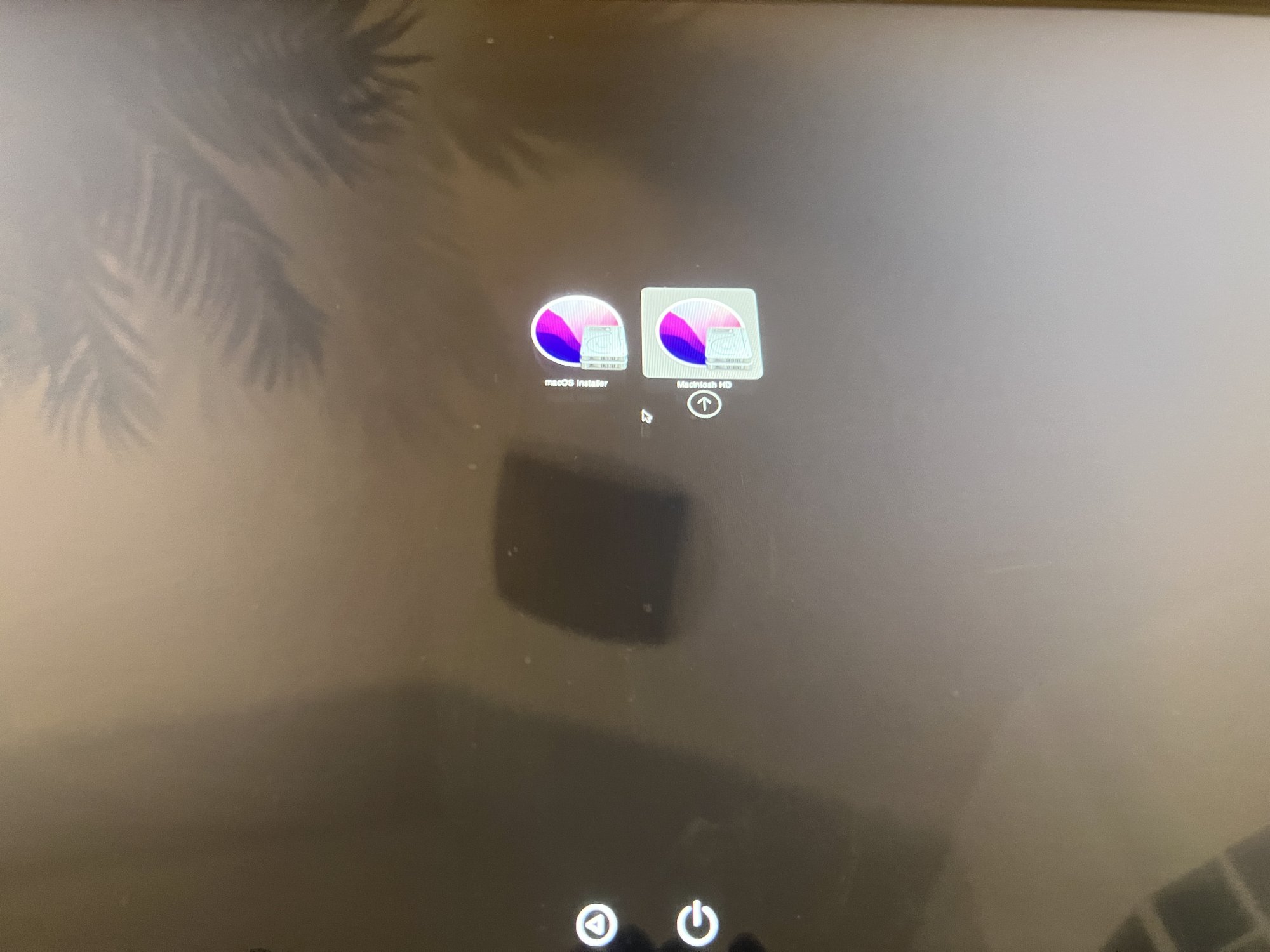

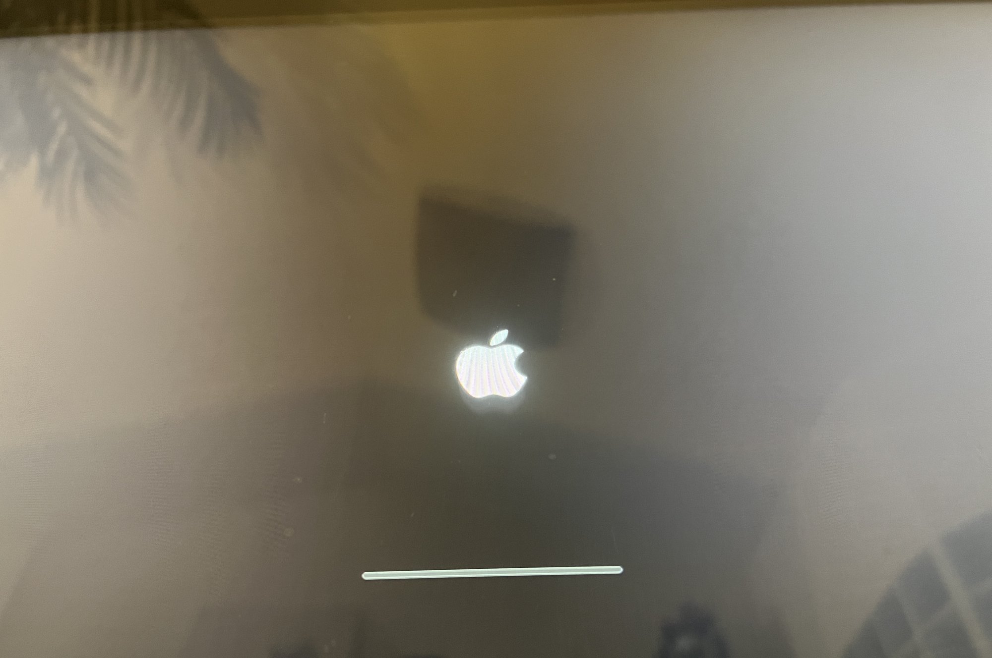

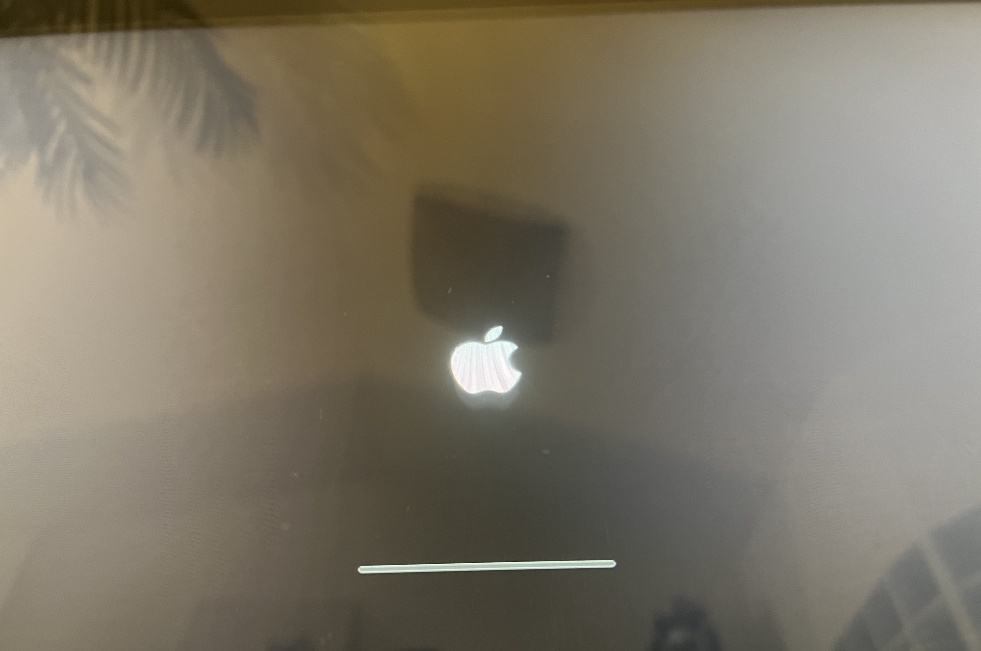

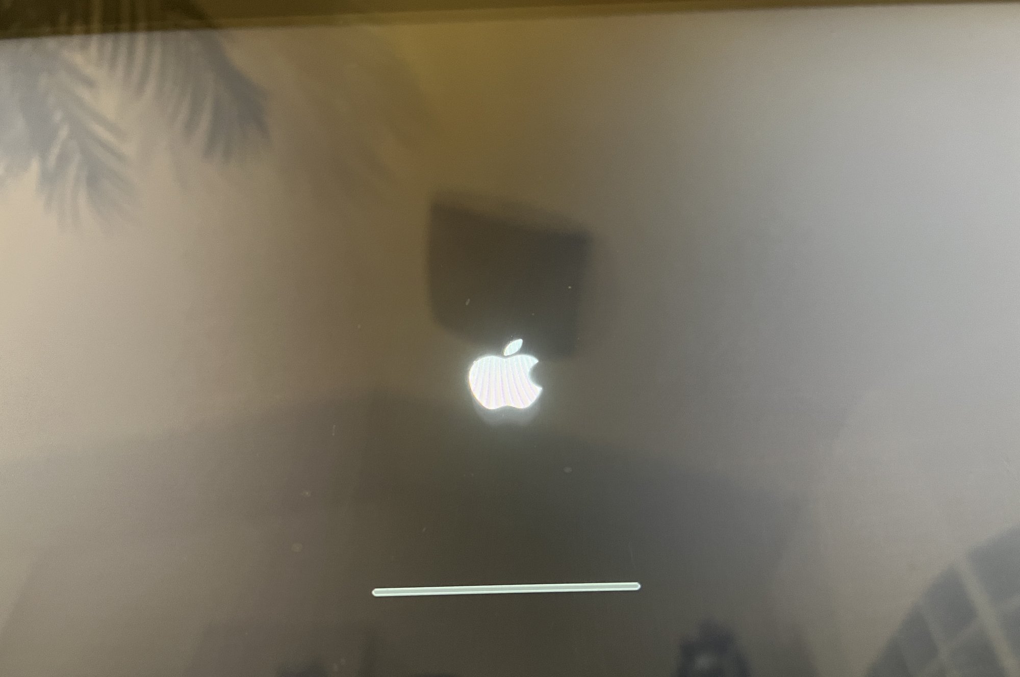

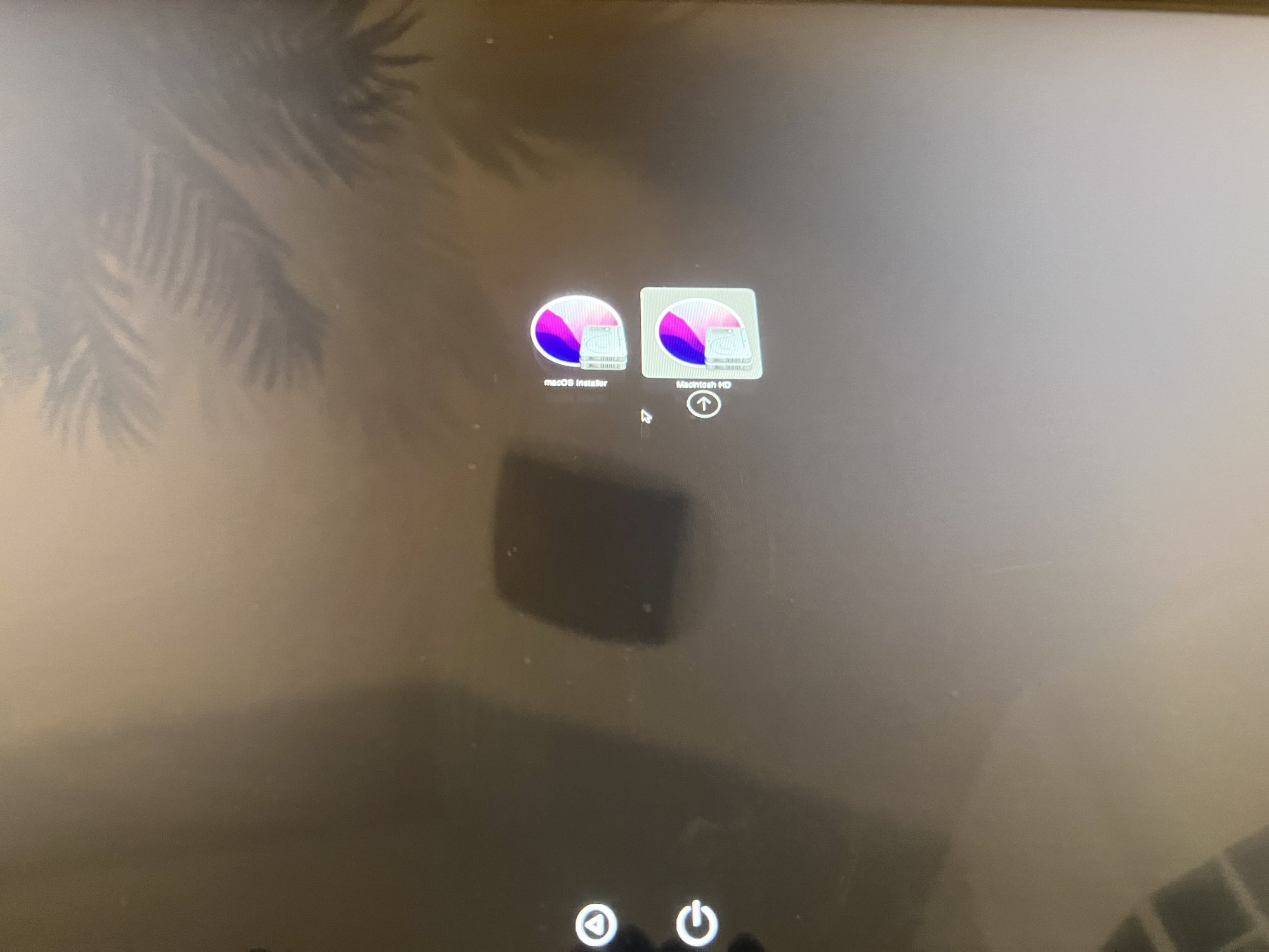

No luck updating. When reboots, boot from “macOs Installer” volume, as usual, but hangs and reboot again.
Tried to boot fron the usual volume, but an empty progression bar appears.
