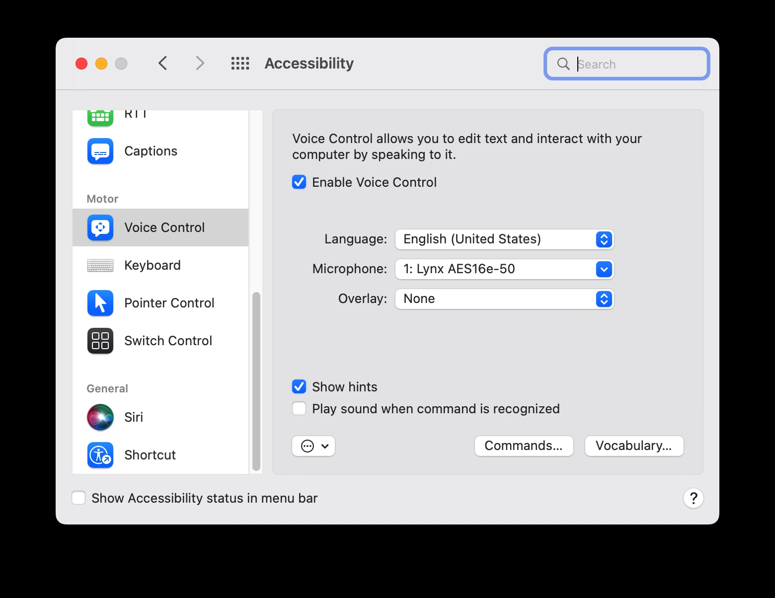

I have booted into 12.5 and seems to be working without bumping up the MaxKernel value of AVXpel. So that is good news, but I do know that there are certain usage patterns that have to be encountered in order for the missing AVX functionality to cause a panic.. I'm not sure what those test scenarios would be, in order to find out if 12.5 has somehow been fixed by Apple to not need AVXpel any longer.
I can't test AVXpel right now, but a simple test is to try enabling Voice Control (System Preferences > Accessibility > Voice Control). If the patch no longer works, then you'll get a panic (note that if you've never tried enabling it before, macOS might download some components first).
Reactions: PeterHolbrook
I enabled Voice Control, it downloaded some things and nothing panic'd. Guess either the patch works or Apple removed the dependency on AVX. One way or the other...
