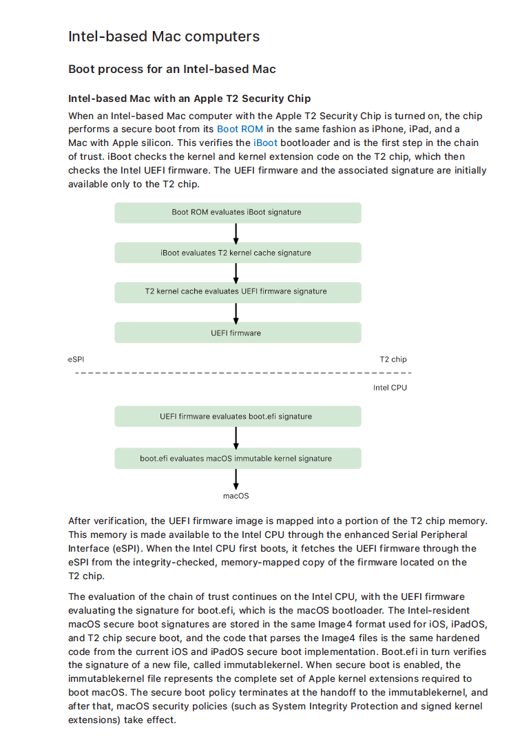

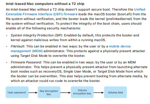

See near the bottom of this page: https://steipete.com/posts/kernel-panic-surprise-boot-args/
chunklist-security-epoch=0 -chunklist-no-rev2-dev — I link these together because they sound related, and they often show up in combination in random kernel panic reports. Apparently they have to do with EFI signatures.
My guess is that when you get a KP, MacOS inserts those boot-args into the next boot in order to display the crash report. Something like that...
"EFI signatures", what's that about..?
Something related to security:
Using an online signing server also provides better protection against rollback attacks than typical global signature approaches. In a global signing system, the security epoch could have rolled many times, but a system that has never seen the latest firmware won’t know this. For example, a computer that currently believes it’s in security epoch 1 accepts software from security epoch 2, even if the current actual security epoch is 5. With an Apple silicon online signing system, the signing server can reject creating signatures for software that’s in anything except the latest security epoch.
Additionally, if an attacker discovers a vulnerability after a security epoch change, they can’t simply pick up the vulnerable software from a previous epoch off system A and apply it to system B in order to attack it. The fact that the vulnerable software from an older epoch was personalized to system A helps prevent it from being transferable and thus being used to attack a system B. All these mechanisms work together to provide much stronger guarantees that attackers can’t purposely place vulnerable software on a Mac in order to circumvent the protections provided by the latest software. But a user that’s in possession of an administrator user name and password for the Mac can always choose the security policy that works best for their use cases.
