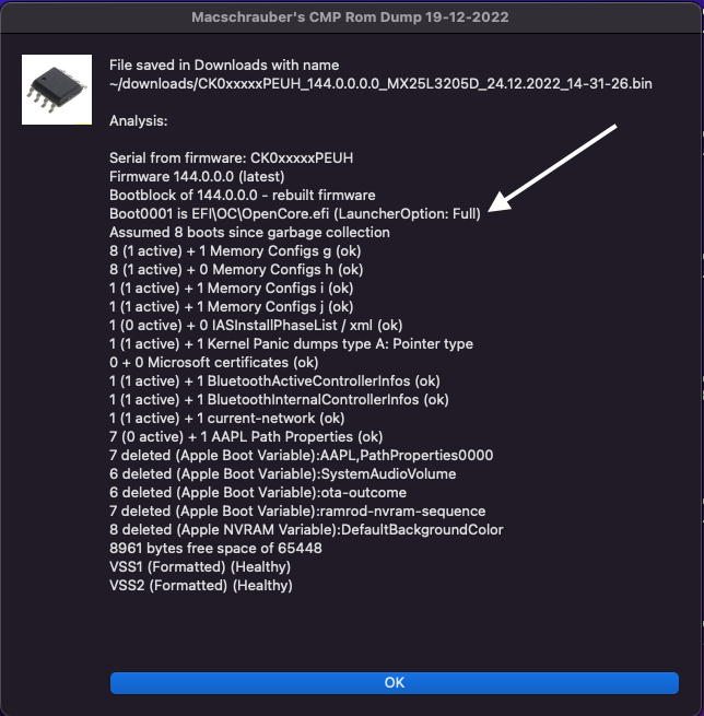

Dont forget to set LauncherOption from Full to Disabled. Or OC sets itself as the first bootloader in the NVRAM and RP will not start again.
Whats good for OpenCore allone is bad for chainloading OC.

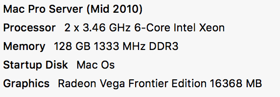

I'm planning to switch from Catalina to Big Sur on Mac Pro 2012 in March, and I starting to worry about my High Sierra installation. I read somewhere that booting to High Sierra can destroy Big Sur. I don't want to take out my hard drive with Big Sur when I want to use High Sierra.
My Mac Mini Server from 2010 with High Sierra isn't a powerful machine.
How can I solve this issue?

My dumper has a line for reporting LauncherOption:Full - as it's sometimes tricky to get it away.
