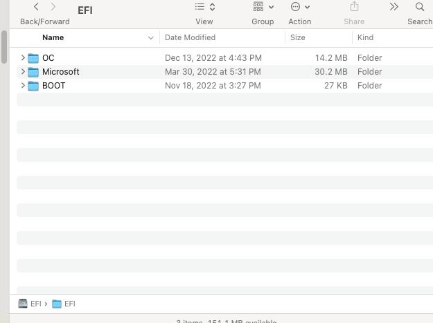

Does your Opencore efi folder contain the 'Microsoft" folder? Windows 11 is so snappy for me running off sata bay 2 not sure the NVMe route is worth it if you are just using it for occasional gamig which is what I use it for. This is my video on installing Windows 11 using rufus I already had windows 1o installed and put 11 on a new SSD

also my OC folder doesn`t contain any Microsoft stuff just Apple and OC as it should be i think at least looking at cdf´s tutorial in post1. On my Windows SATA SSD i have an EFI partition containing an EFI folder and inside is the Microsoft folder i think you are referring to.
try moving the microsoft folder to the opencore efi folder and remove it from the windows drive efi. If it's not in the opencore folder opencore won't see the windows drive from what I understand. My Window drives EFI does not contain a EFI folder at all. I asked about this earier today. see this thread. https://forums.macrumors.com/thread...-1.2356603/page-3?post=31899035#post-31899035
Actually, OC will find it regardless of which EFI partition contains the Microsoft folder. The idea for placing it in a different EFI partition is to prevent Windows from replacing the OC BOOT folder with its own version during updates.
Note: If you've let Windows install the EFI files automatically, then you might want to make sure that your BOOT folder contains the OC BOOTx64.efi file and not the Windows one!
Thats what i thought. I also tried having the Windows EFI files on other drives as well as together with the OC stuff. Didn’t affect anything and i’d rather keep my OC EFI clean for easy Updates…

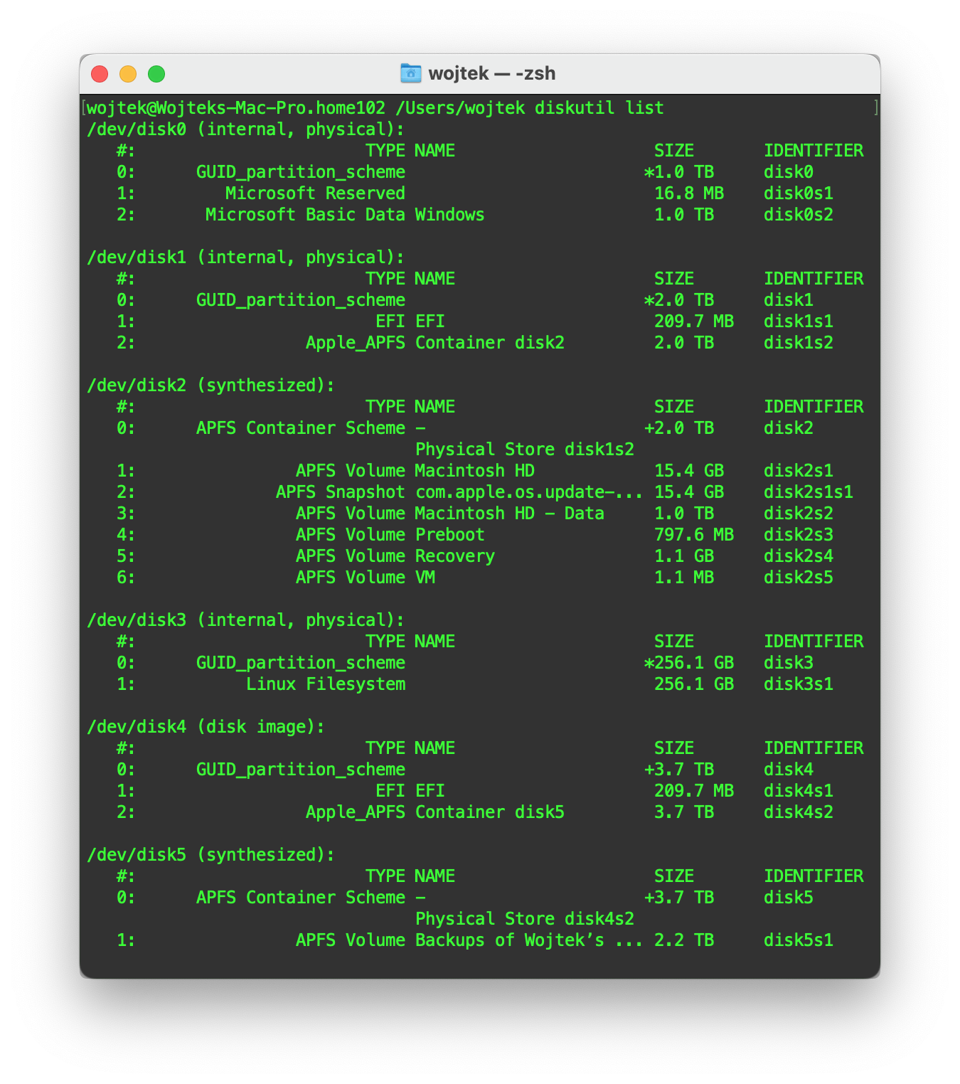

So it seems it might be a faulty “snapshot” i can see it in diskutility and its 0KB i can’t delete it and when i try to activate it finder crashes.
Any idea on how to fix this?
Maybe enable vmm for this to finish or something?
The presence of that volume is normal, and the possibility of the snapshot being faulty is another issue (which shouldn't affect Windows).
Ok but im sure something is weird with my macOS and i seem to remember having had this issue before and believe me it affected booting into windows.
When i open diskutility and look for my macOS Monterey it shows a greyed out macOS partition and a macOS - Data one. When i click on the greyed out one i see a message saying something snapshot aktive. When i rightclick the grayed out volume and say activate it. I can see a snapshot on the volume but i can’t delete it nor can i show it in the finder. Actually when i try to do anything with it finder starts freaking out and i will eventually be logged out of my account and back to my login screen. When i log back in the statusbar flickers and I’m thrown out again.
There is something f*d up for sure.
When i boot the recovery and perform a disk repair it checks that very snapshot but somehow finishes the check without doing anything about the snapshot
So is it better to have the "microsoft" folder live on the windows drive / efi instead of the opencore drive / efi ? The OC boot folder does have BOOTx64.efi in it. The microsoft folder has its own boot and recovery folders.
No, he just wrote it: "The idea for placing it in a different EFI partition is to prevent Windows from replacing the OC BOOT folder with its own version during updates"
You wont need the “boot” folder of the microsoft EFI at all just the “microsoft” folder ideally on the EFI partition of your windows drive. OC will recognize it and show it in the bootpicker
In terms of functionality for Windows, it makes no difference, but using a different EFI partition for Windows is a good idea to mitigate BootROM damage.
When using the same EFI partition, the OC folder EFI/BOOT is likely to get replaced by the Windows one, and this is a very bad thing. Now, it might not be immediately obvious that this has happened, because with LauncherOption=Full, OC redirects its blessing to EFI/OC/OpenCore.efi. But contrary to EFI/BOOT/BOOTx64.efi, this path is not a standard one, so after so after an NVRAM reset (a real one outside of OC), if the OC version of BOOTx64.efi has been replaced by the Windows version, then it is possible for Windows to boot outside of OC, damaging the Mac Pro’s BootROM! You can check whether the BOOTx64.efi file is the right one by searching the file for the string “OpenCore”.
In addition to using a different EFI partition for Windows, another safety measure is to keep only the Microsoft folder (so that the only EFI/BOOT folder on any EFI partition is the OC one). Of course, the solution isn’t bulletproof, because Windows can still recreate the BOOT folder (though it shouldn’t overwrite the OC one if it uses a different EFI partition). Therefore, after any Windows update, it is also a good idea to go look for this folder on the Windows EFI partition and to delete it.
I hope this clarifies things a bit!
If you installed Windows or Linux as intended (via OC boot) their disks will probably have no EFI partition at all (Windows on 1TB, Ubuntu on 256GB, MacOS on 2TB):
Right. I suppose that’s because they all use the OC EFI partition (maybe disk1s1 in your case)—look for a Microsoft or Grub folder there (grubless Linux is possible, but that’s another story!). Everything can still work in this case; you just have to keep on eye on that BOOT folder (as mentioned above).
