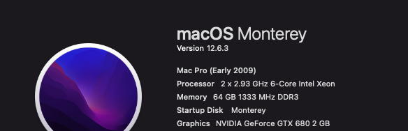

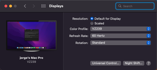

Not able to do screen mirroring post 12.6.3 upgrade. What am I missing here?

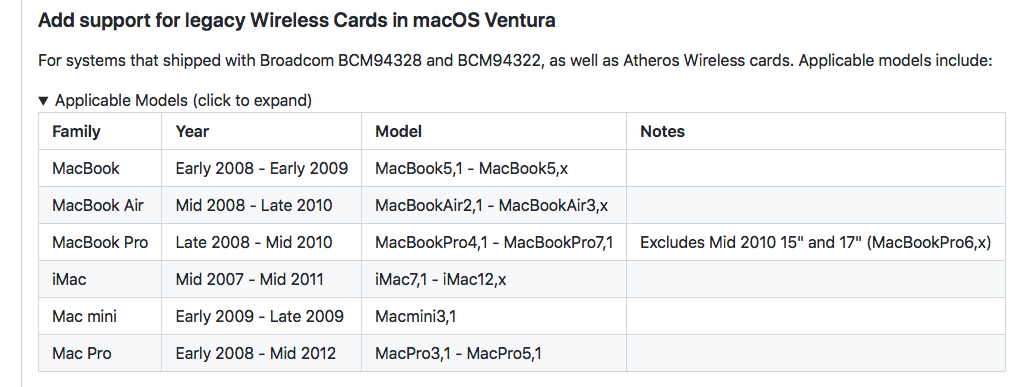

support for old bluetooth has been added to the ocpl - in that case, atheros.
I think it's just some kind of kext added?
Is there any hope in the minimum cdf configuration to add this?
