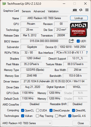

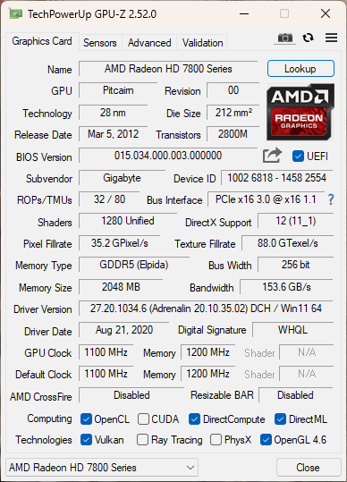

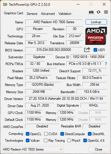

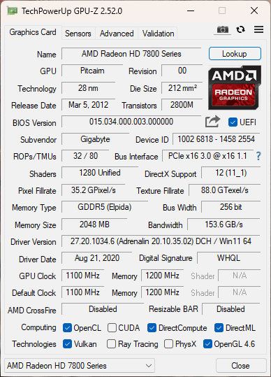

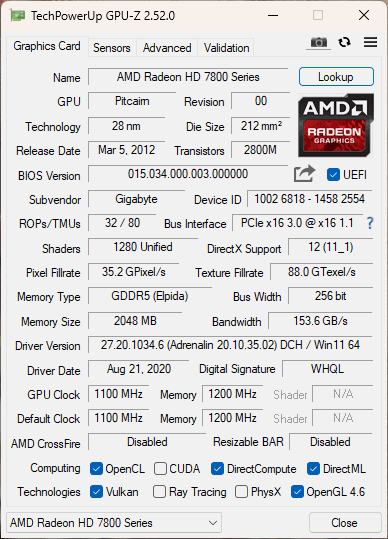

My GPU-Z attached
It's a Pitcairn... so about the factory firmware you mean the BIOS Gigabyte distributes?
With that i can run Mojave, if I understand correctly. Nice...
Thanks for helping
Yes, ok
I've already flashed it
So is it possible to run Mojave or higher with this?
In dortania's GPU buyer's guide it is listed as Monterrey compatible...

First of all, thank you all... I apprecciate every answer you gave me.
Ok, some news about the HD7870...
- @Macschrauber I've tried the verbose mode, it showed a critical error related to the GPU's vBIOS... and then stuck on smthing like "webcontentfilter triggered rebuild", sorry I didn't take a picture, it was late, I will try later again and take a phto if you can't tell me anything with this info...
Maybe I flashed the GPU wrong?...
- @Darmok N Jalad , I filtered the ROMs in Techpowerup like this and chose the newest one, did I do somthing wrong?
And @tsialex really thank you for your info... here is again my GPU-Z screenshot
If i understand correctly I have a Pitcairn GPU... so I should be able to install High Sierra natively...
the thing is that it ever boots (no OCLP, no patcher of any type...). I think it has something to do with the flashing as I told the other member, could it be?
The guy who sold the card to me flashed it with this ROM from Techpowerup, and I even was able to boot Mojave... but I had some issues, sometimes the screen got black, or sometimes I could only move and see the mouse symbol but the screen was frozen... That's why I'm trying to flash it correctly and installing again at least high Sierra.
Finally, I don't like the idea of getting rid of this card, it worked great with Sierra (and even Mojave as i told you, but with the bad flashing) natively, that and being a Pitacairn is why i think I flashed it wrongly...
so, to summarize:
- did I choose the correct ROM?
- if so, could I run High Sierra natively?
Again, thank you all for your patience...
