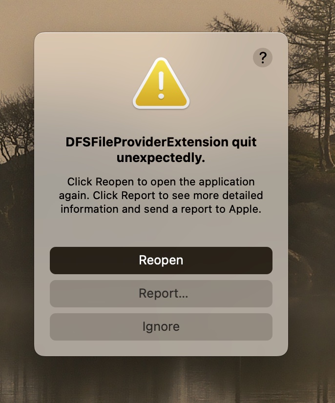

2. got this dfsfileproviderextension error on first login
turned off the computer. reset smc and nvram
MACOS 12.6.4 is working

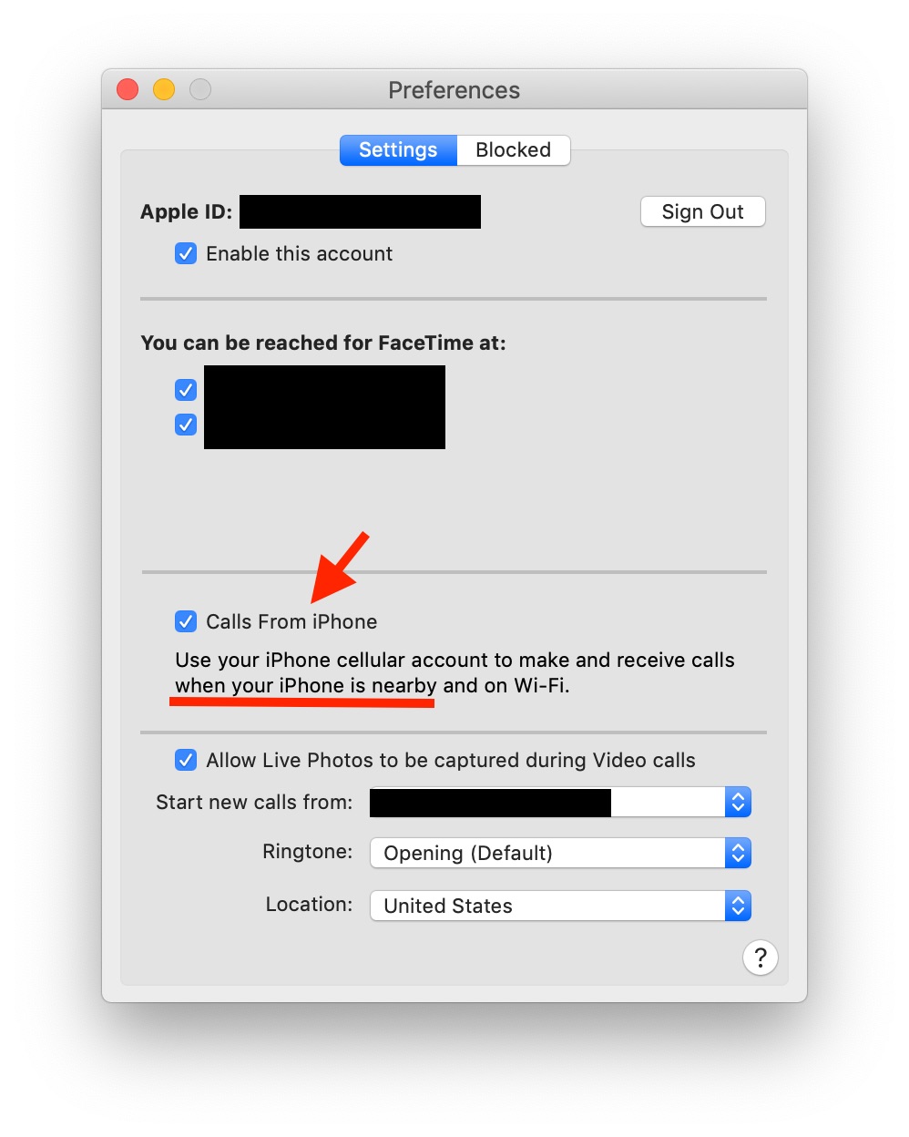

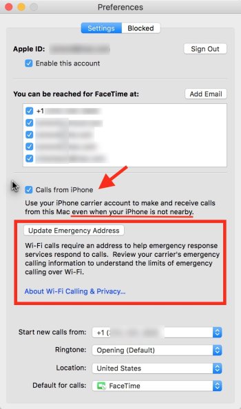

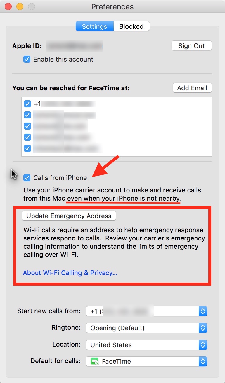

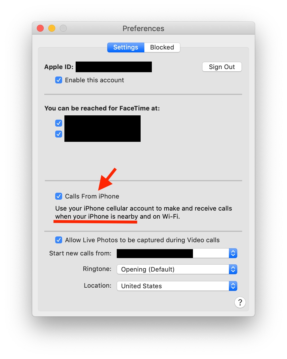

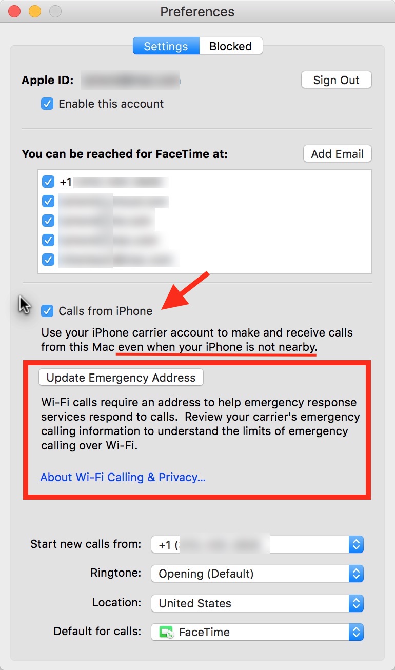

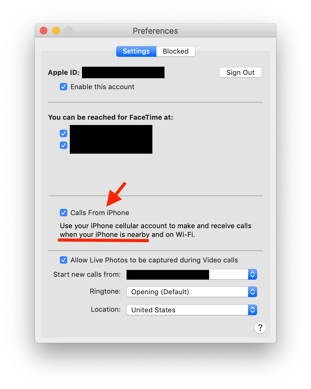

The easiest way to tell whether WiFi calling is available is to open FaceTime.app and go to Preferences. You will either see:
"...when your iPhone is nearby" (the basic version):

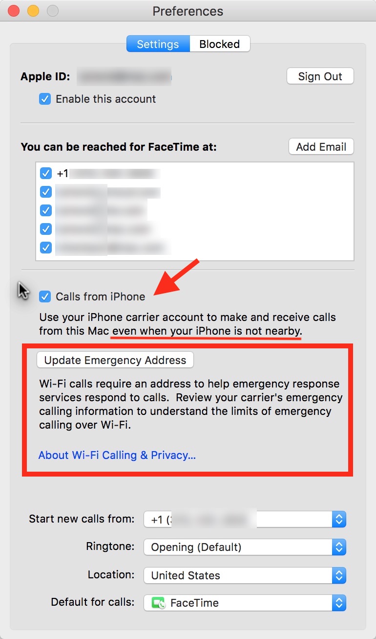

or "...even when your iPhone is not nearby" (also has a button to update your e911 address), which is WiFi calling:
First question: Has anyone managed to enable WiFi Calling (i.e. seeing that second version of FaceTime preferences) on their cMP via OpenCore? If so, can you share your config file?
Second question: Has anyone figured out how Apple determines how to enable/disable that feature? If it is based on a serial number lookup then is it worth trying to enable it? I've read that spoofing another SN could break other stuff that is more important (iMessage, etc.)

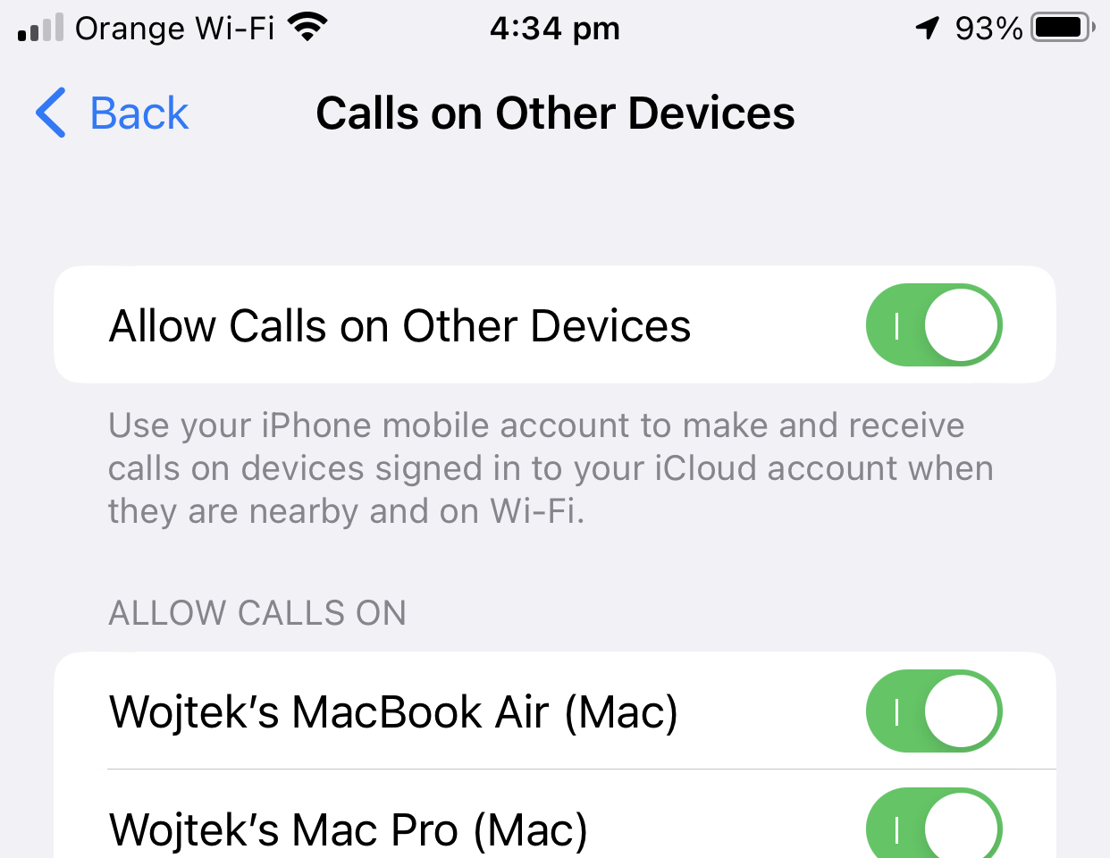

But regardless, I have those settings on my phone enabled, and my cMP is the only Mac that I have that does not show the ability to enable Wi-Fi calling. I think perhaps the only way to enable it would be to spoof the serial number of a >2012 Mac, as just spoofing the board ID doesn't seem to be enough.

Yes, it is definitely a carrier-dependent feature. You must first enable Wi-Fi calling on your iPhone (Settings > Phone > Wi-Fi Calling > Wi-Fi Calling on This iPhone), and then you must also enable "Add Wi-Fi Calling For Other Devices" on the same screen. Once those are enabled then your various Macs and iPads can be enabled for the feature.

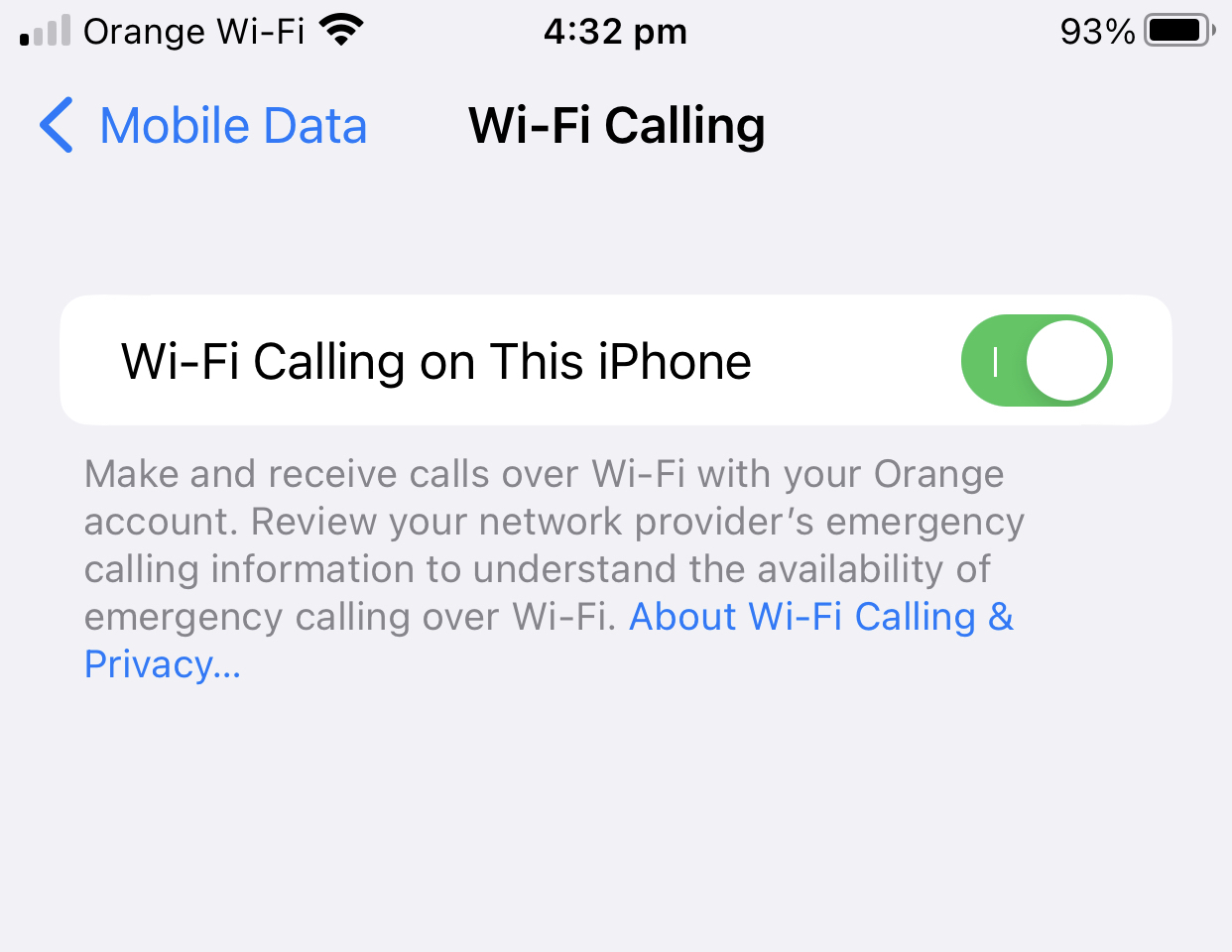

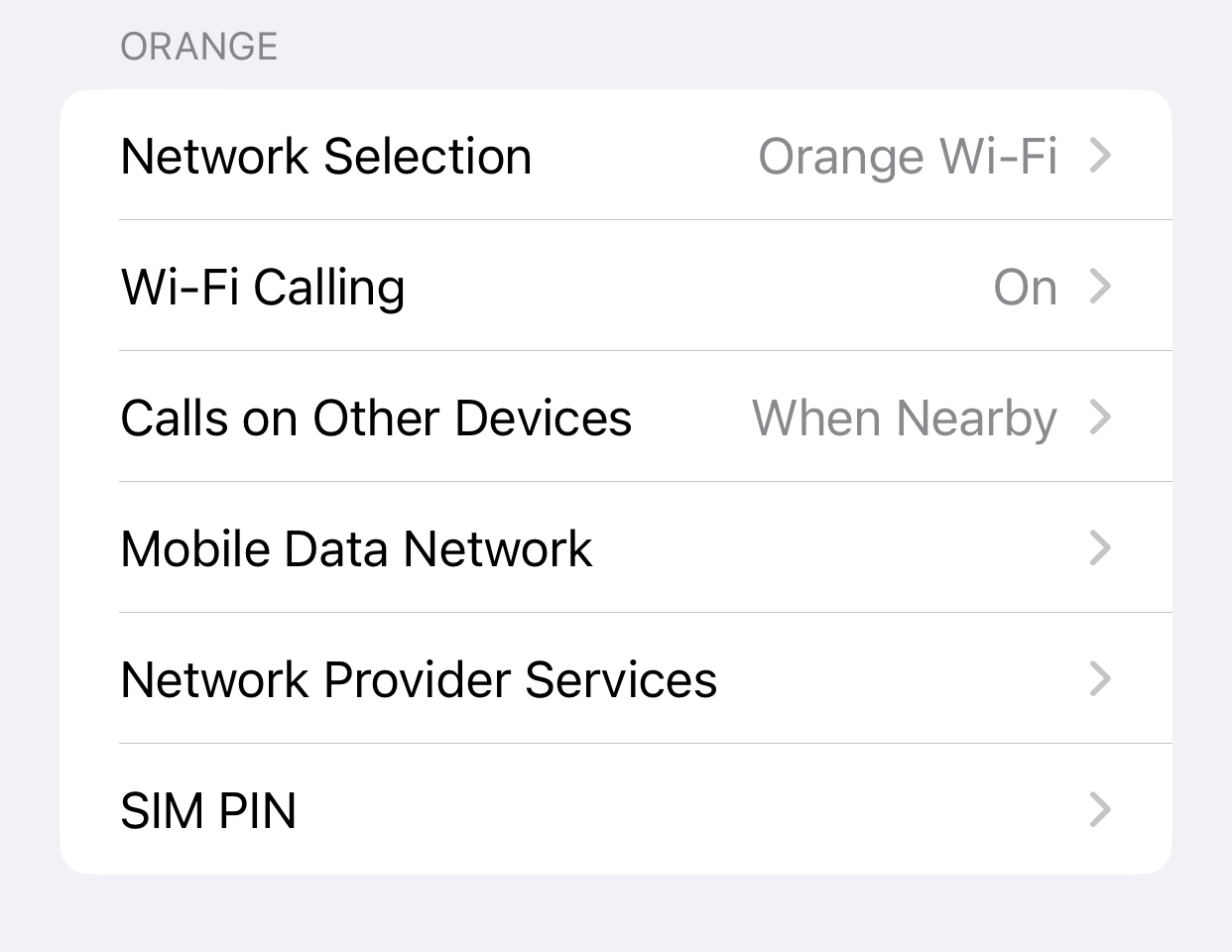

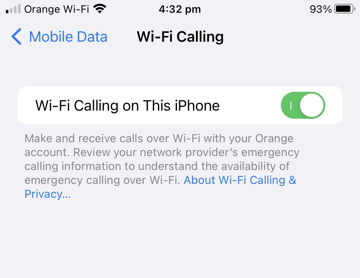

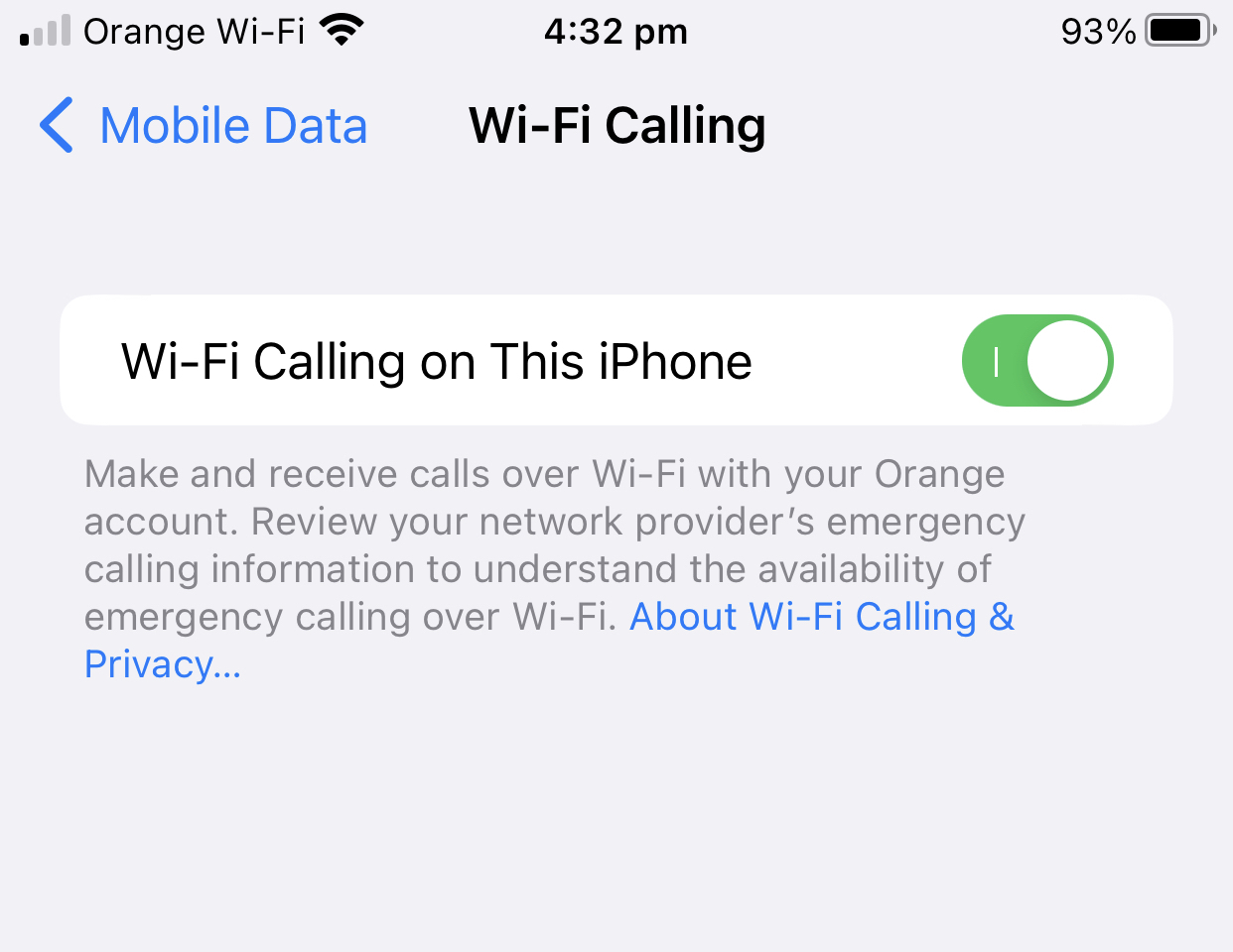

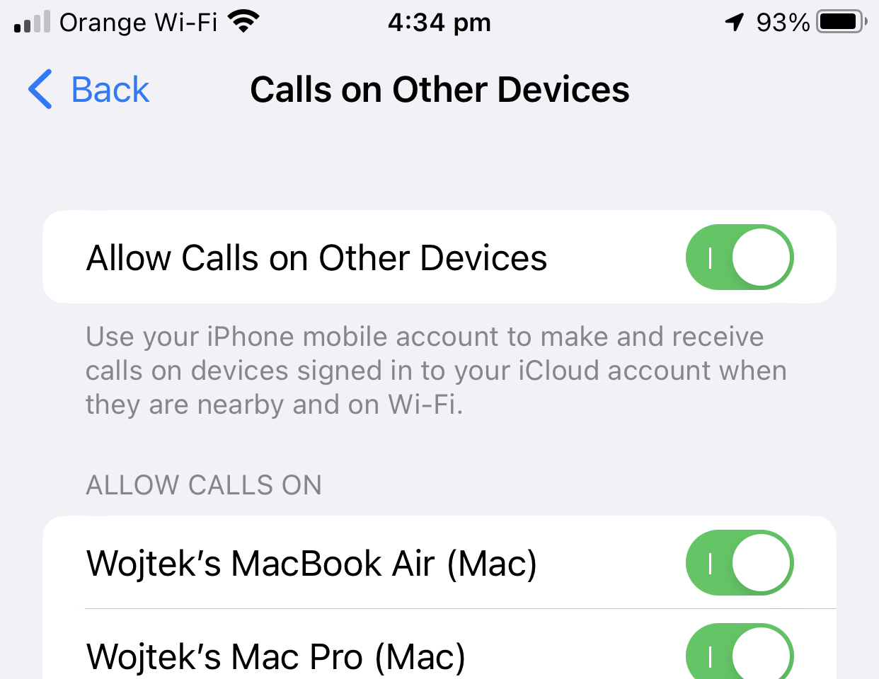

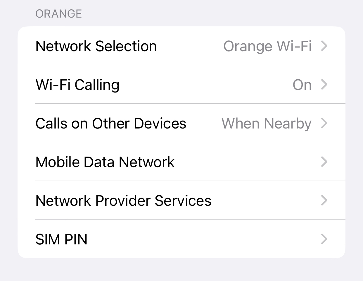

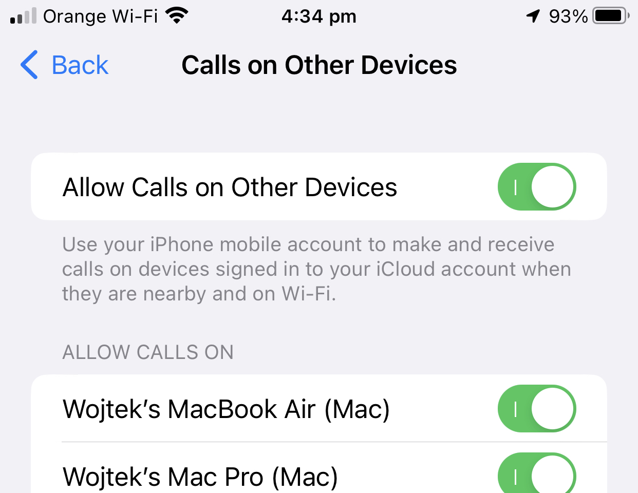

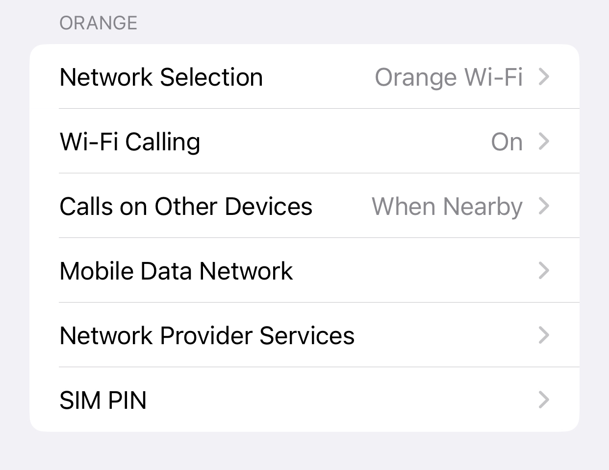

I do have Wi-Fi calling on my iPhone since my carrier supports it, however there is no setting "Add Wi-Fi Calling For Other Devices". There is only the usual "allow calls on other devices".
Possibly this is an US-only feature.

Yeah, I edited my previous post with a link from Apple where they detail the various features supported by different carriers.
In Europe, it looks like the only carrier offering "Wi-Fi Calling on supported iCloud-connected devices" is EE in the United Kingdom.
In Hong Kong, it is offered by carriers 3 and SmarTone.
