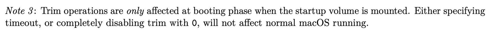

Anyway, I set SetApfsTrimTimeout=0 for a few months now. No issue so far, and can't feel any performance degradation. The following is from the latest OpenCore manual under the SetApfsTrimTimeout section.
If you really concern about it, may be you can set that to zero just for this "setup period". Once you finish the initial setup, and no need to reboot that often, you can set that back to 9999999.
Or, you may set that to 9999999 then make a reboot once every few weeks. So that the SSD at least will be manually TRIMed something like once a month.
