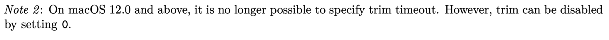

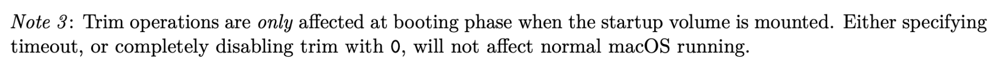

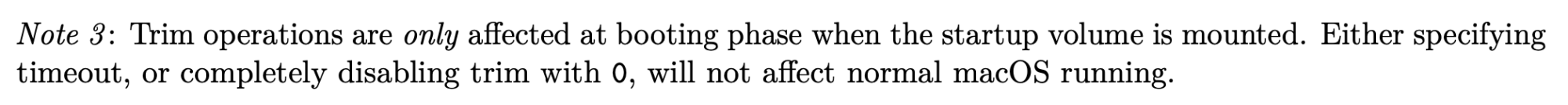

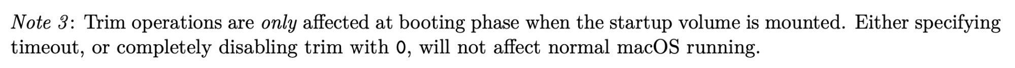

Thank you for all the info. That command took a long time to run. Here are the entries from my most recent boot yesterday evening:
Code:
2023-04-05 18:16:31.545915-0500 0x37f      Default     0x0                  0      0    kernel: (apfs) spaceman_metazone_init:191: disk4 metazone for device 0 of size 2693771 blocks (encrypted: 0-1346885 unencrypted: 1346885-2693771)
2023-04-05 18:16:31.545925-0500 0x37f      Default     0x0                  0      0    kernel: (apfs) spaceman_datazone_init:625: disk4 allocation zone on dev 0 for allocations of 1 blocks starting at paddr 56033280
2023-04-05 18:16:31.545931-0500 0x37f      Default     0x0                  0      0    kernel: (apfs) spaceman_datazone_init:625: disk4 allocation zone on dev 0 for allocations of 2 blocks starting at paddr 15400960
2023-04-05 18:16:31.545938-0500 0x37f      Default     0x0                  0      0    kernel: (apfs) spaceman_datazone_init:625: disk4 allocation zone on dev 0 for allocations of 3 blocks starting at paddr 23855104
2023-04-05 18:16:31.545944-0500 0x37f      Default     0x0                  0      0    kernel: (apfs) spaceman_datazone_init:625: disk4 allocation zone on dev 0 for allocations of 4 blocks starting at paddr 14581760
2023-04-05 18:16:31.645189-0500 0x75       Default     0x0                  0      0    kernel: (apfs) spaceman_scan_free_blocks:3172: disk4 scan took 0.099193 s (no trims)
2023-04-05 18:18:55.212482-0500 0x75       Default     0x0                  0      0    kernel: (apfs) spaceman_scan_free_blocks:3154: disk4 scan took 143.567278 s, trims took 143.340673 s
2023-04-05 18:18:55.212490-0500 0x75       Default     0x0                  0      0    kernel: (apfs) spaceman_scan_free_blocks:3156: disk4 116716482 blocks free in 323470 extents
2023-04-05 18:18:55.212497-0500 0x75       Default     0x0                  0      0    kernel: (apfs) spaceman_scan_free_blocks:3164: disk4 116716482 blocks trimmed in 323470 extents (443 us/trim, 2256 trims/s)
2023-04-05 18:18:55.212504-0500 0x75       Default     0x0                  0      0    kernel: (apfs) spaceman_scan_free_blocks:3167: disk4 trim distribution 1:53598 2+:54954 4+:105037 16+:51445 64+:20510 256+:37926
So what I don't understand is that with SetApfsTrimTimeout=9999999 (9.99 seconds) in my OC config, why then do I see "trims took 143.340673" seconds? Are multiple TRIM operations performed on each drive, with each one taking 10 seconds? That's the only thing I can think of.
I was confused at first because I don't even have a physical disk4 in my system (my four blades are disk0, disk1, disk2 and disk3), but from running diskutil list it seems disk4 is basically my disk0 1TB EVO 970 "synthesized". I guess that's an APFS thing?
None of the other drives appear to have been trimmed according to the logs--but then again there are no file operations taking place on those drives yet.
The bug may have existed before Monterey, but there are a lot of people who only noticed it after installing Monterey--so it seems it got worse with that OS release (I found discussions where people "solved" the problem by reinstalling Big Sur). And apparently the problem still exists with Ventura.
I guess I will use SetApfsTrimTimeout=0 to work around this problem--at least for now.
That's just a no/off switch in later macOS, you can't really make it 9.99s anymore.
Yes, it's a APFS thing.
e.g. This bug exist back in High Sierra, but if we run High Sierra with HFS+, rather than APFS. You will never see this long TRIM time issue.
Anyway, now you know that about 2.5 minutes was used to TRIM during boot. If you want to avoid that in this "setup period", you can simply set SetApfsTrimTimeout=0.

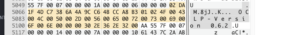

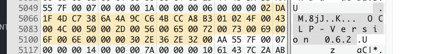

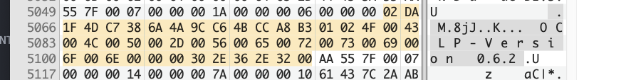

OCLP NVRAM variable (yes, it is a little on topic):
I just wanted to let the Dumper indicate the Version of OCLP and booted another package (MartinLo's) to compare.
OCLP NVRAM variable gets not deleted as the other packages does not know it. So if I once booted with OCLP and the next time with another package the OCLP version is still in NVRAM. So indicating it is useless.
Does it makes sense for you guys, especially @cdf, @h9826790 to clear those OCLP NVRAM variables in the default settings?
the pattern is:
Code:
Variable: 4d1fda02-38c7-4a6a-9cc6-4bcca8b30102:OCLP-Version (OpenCore Variable)
StartID:  55aa (Valid)
State:    7f (Normal)
Unknown8: 00
Attr:     00000007 (NON_VOLATILE, BOOT_SERVICE_ACCESS, RUNTIME_ACCESS)
NameSize: 26
DataSize: 6
DataType: looks like NULL-terminated ASCII
Data:
00000000: 30 2e 36 2e 32 00                                0.6.2.
the pattern is:
Code:
State:    7f (Normal)
Unknown8: 00
NameSize: 26
DataSize: 6
Data:
UEFI variable log does not include some messages and has no performance data. To maintain system integrity, the log size is limited to 32 kilobytes. Some types of firmware may truncate it much earlier or drop completely if they have no memory. Using the non-volatile flag will cause the log to be written to NVRAM flash after every printed line.
Warning 1: Certain firmware appear to have defective NVRAM garbage collection. As a result, they may not be able to always free space after variable deletion. Do not enable non-volatile NVRAM logging on such devices unless specifically required.
Seems like this has to be disabled on cMP. But just recording the version of OC or OCLP should not waste that much space?

its not about space, but if I want to report what flavor of OC (and OCLP model/setting) was booted recently an old setting what stays in NVRAM is not helpful.
So if you use new revision OCLP it does not overwrite the old one? Normally if that GUID is added to the delete section it should replace the old one.
cdf
macrumors 68020
Jul 27, 2012
2,256
2,583
I don’t think it makes sense for various OC packages and configs to have to account for one other. How about recommending an NVRAM reset before running the dumper?
Reactions: Bmju
Macschrauber
macrumors 68030
Dec 27, 2015
2,980
1,487
Germany
Yes, it does. Like all NVRAM variables it gets the delete flag and a new one is stored when it changes.
But it gets not the delete flag when the user decides to change the OpenCore flavor (OCLP, MartinLo or MyBootMgr). So the benefit of showing OCLP version, model and setting is limited - if not saying incorrect.
The advice cleaning NVRAM before dumping will hide some problems what the Dumper wants to show as a side effect. People might not see problems with false headers for example. Also some will lose settings they need, for example users of non or chain loaded OpenCore bootloaders.
startergo
macrumors 603
Sep 20, 2018
5,021
2,282
Okay how about deleting only the specific variable like:
Code:
sudo nvram -d 4d1fda02-38c7-4a6a-9cc6-4bcca8b30102:OCLP-Version
Is this not going to work?
the pattern is:
Code:
State:    7f (Normal)
Unknown8: 00
NameSize: 26
DataSize: 6
Data:
I think we can stay objective and factural in this matter.
First of all, what's this NVRAM variable actually means? If it only means "the last OCLP verion that's installed", but nothing about if that still exist, then your tool may only tell the user about this fact.
The problem is not only if the user switch to cdf or my way to run OpenCore, but also if they completely removed OpenCore from the cMP and fallback to some natively support OS (e.g. Mojave). Then cdf and me won't able to do anything, and your tool will still report "your Mac is running OCLP ver.xxx" which is obviously wrong in that case.
So, I don't think it's a good idea to report OCLP version base on this NVRAM variable (if this parameter won't be removed automatically even OCLP not exist anymore).
Or you may simply make your tool to report "OCLP ver.xxx singature exist in NVRAM", just like "MS cert in the NVRAM".
In fact, if the user follow my guide to install my pre-configured (for 5,1) OC package. The very 1st step is "3x NVRAM reset". So, even there is nothing in my package to remove that variable, but somehow, the installation procedures should remove that.
Macschrauber
macrumors 68030
Dec 27, 2015
2,980
1,487
Germany
yep, I will think that over and check out if there is another variable what indicates last time OC boot like one of the bootx variables. OCLP does start out of a kinda faked system folder on the esp for example.
I sometimes get questions from users what install all kind of OpenCore variants and it would be nice to see from the dump what kind was booted recently.
I think it's OCLP's config.plist that puts the OCLP-Version in NVRAM so someone could remove that and still be using OCLP. You might want to look for stuff that is setup by the OpenCore.efi.
There's boot properties in /chosen node of IODeviceTree plane of ioreg.
nvram variables are in /options node of IODeviceTree plane of ioreg and output of nvram -p but only the Apple ones.
