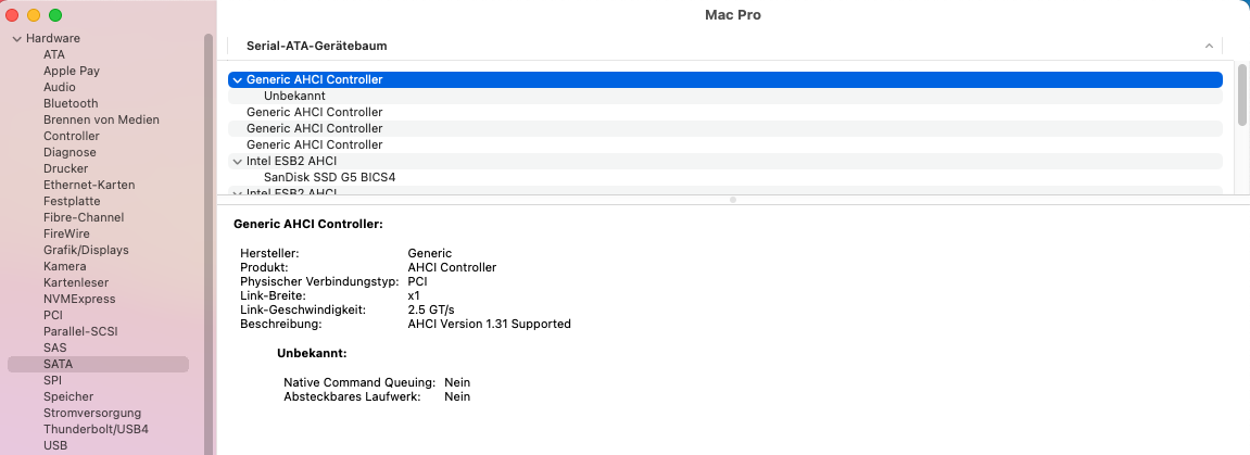

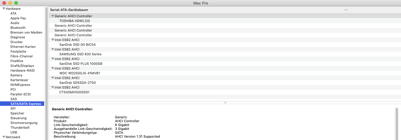

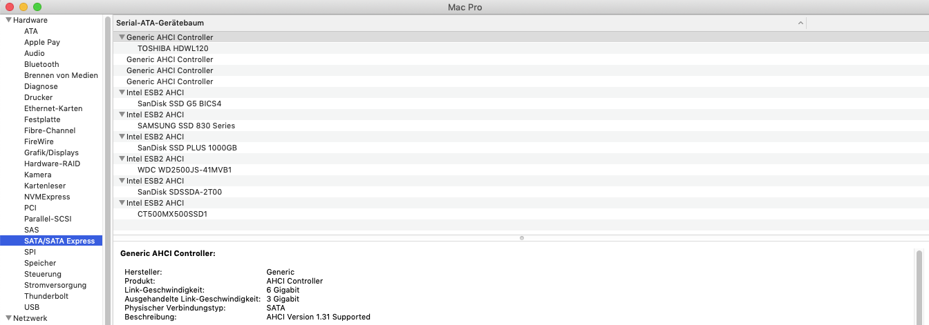

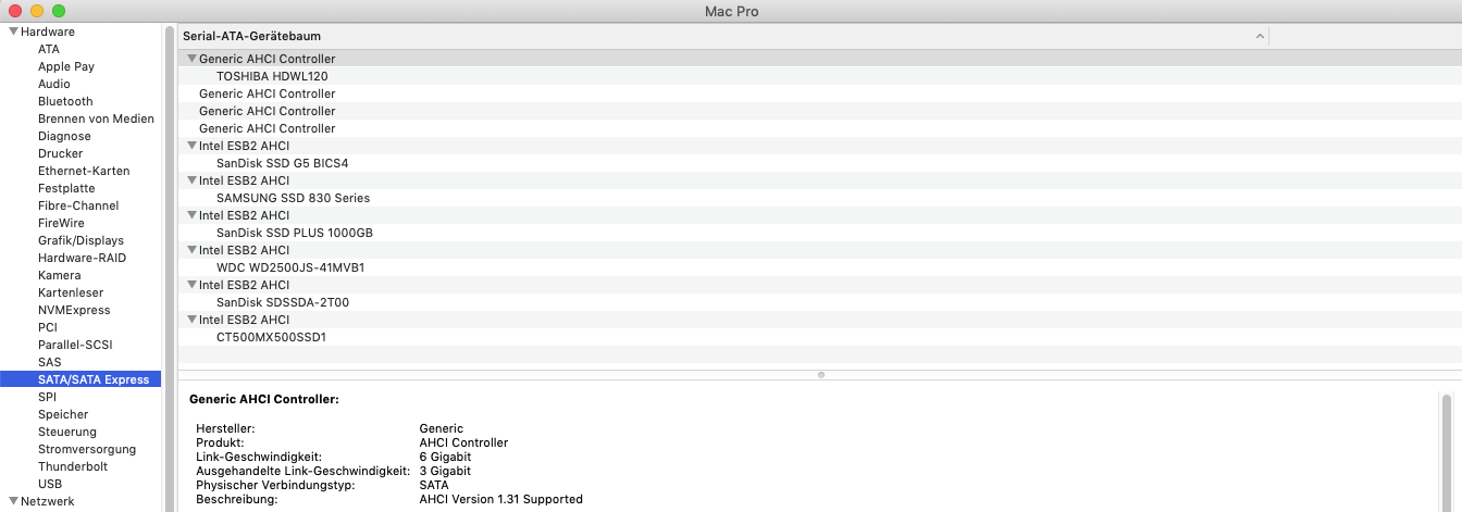

Hello guys, I'm currently running OpenCore REL-091-2023-04-03 on my Mac Pro 3,1 which I have installed with the aid of OCLP. It certainly is a fantastic piece of software and works great on my beloved Mac Pro for the most part but I do have issues with two of my PCIe cards. One is a Sonnet 2 port eSATA card and the other card is a generic 2 port SATA controller card sitting in the mini PCIe slot (my Airport card is in a riser card with external antennas for better reception – so that's why). I checked and both cards use the ASMedia 1061 chip which works great in patched Mojave and Catalina (dosdude1 hacked installs). However, when I boot Mojave, Catalina or Big Sur with OpenCore said 2 cards cease to work. I do have some basic understanding of hackintoshing and poked around the config.plist but I don't really know what to change there ...
System Profiler after booting a hacked Mojave and Catalina (dosdude1) install:

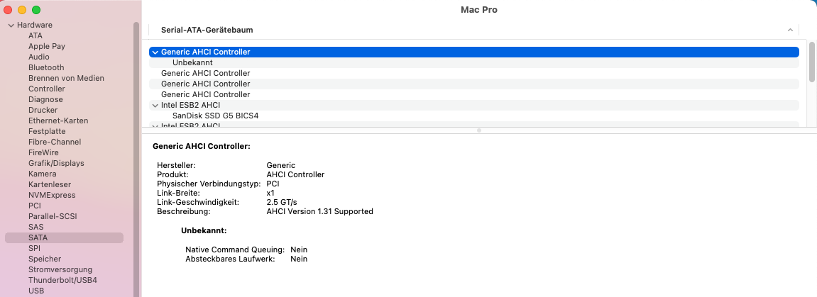

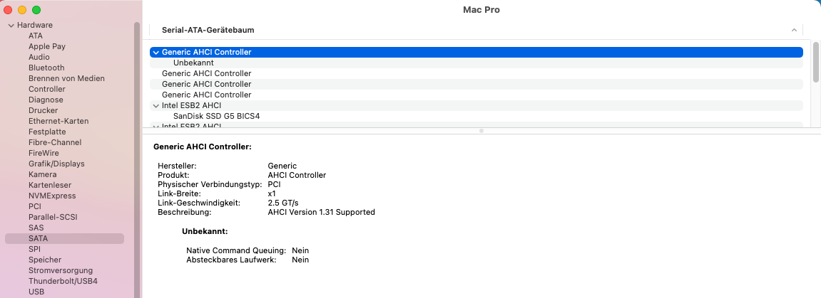

System Profiler when any of my installed macOS versions are booted with OpenCore:
Basically the issue is that none of my drives are recognized (except the ones on the Mac Pro's logic board of course). Third party SATA controllers do not seem to work for whatever reason.
Anyone got an idea on how to fix this?
Thanks!

This thread is about a different opencore setup not OCLP. The opencore legacy patcher discord will be able to help you more that we can
