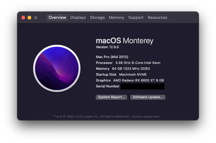

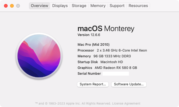

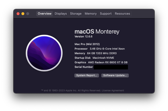

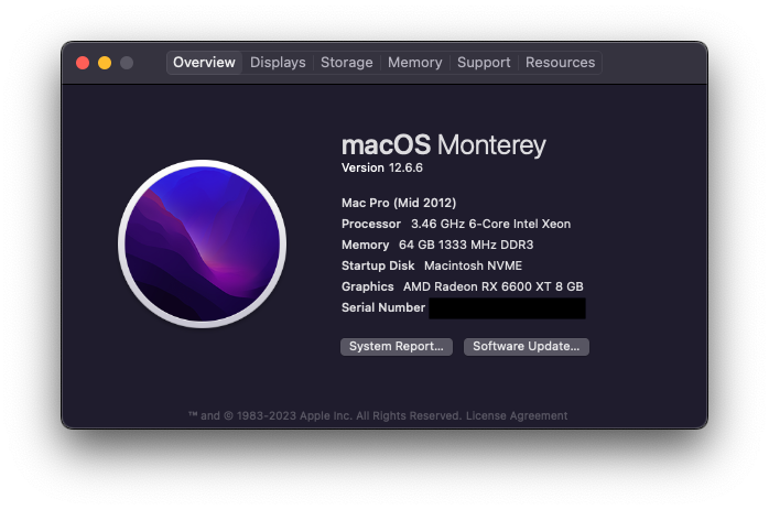

No problem with 12.6.6 here, OCLP 0.6.5. It's a long update, but just be patient.
No issues also, with the Plistlib generator, running on OC 0.9.2. The update was actually very fast for me.
