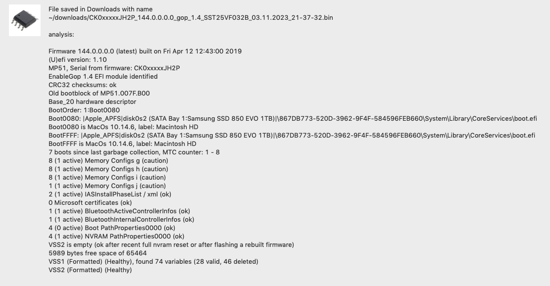

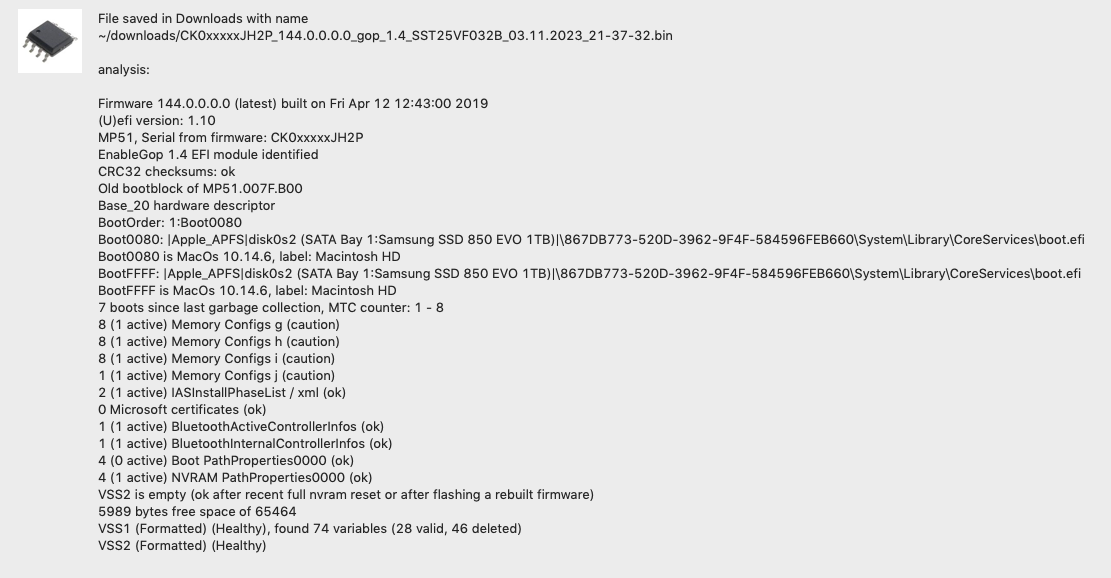

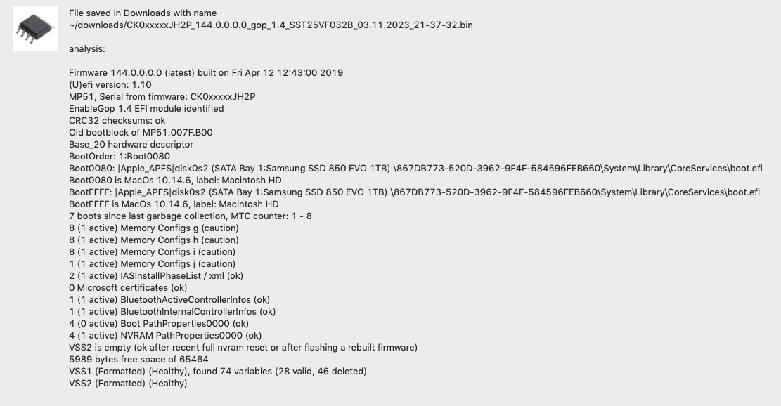

You may first use Macschrauber's ROM dump tool to check if EnableGOP is correctly flashed into the cMP.
If yes, then the XFX card is known to have firmware compatible issue on the 5,1. You may need to flash the graphic card as well in order to have a working GOP.
But isn't the whole point of this procedure NOT have to flash individual graphics cards at all?
The idea is to provide boot screen on the cMP by using UEFI GOP. Most of the modern graphic cards have a working GOP from factory now, but some cards don’t. Therefore, you may still need to flash the card occasionally.
This especially likely required when buying used card. Because any modification to the VBIOS will basically disable the GOP. Therefore, if the previous owner modded the card’s VBIOS (e.g. for mining), then the GOP will be disabled, and a cMP user will need to flash the card with a factory ROM that has functional UEFI GOP in order to see the boot screen.
So, in the old days, we need to flash the card with a customised ROM. But nowadays, you may need to flash a factory ROM into the card.
Anyway, from your screen capture, EnableGop 1.4 is there. So, it should the card’s issue.

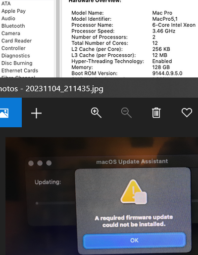

Thanks in advance. I've upgraded before to Big Sur three years ago, and had to revert for a project I had to finish, and certain plugins weren't working, so I've done this before.
Anyhow I done something wrong.

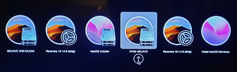

I have OpenCore mounted on my slot 1 spinner ( MOJAVE )
Tried twice. I booted up on the spinner (Mojave), then I ran the Monterey installer on the NVME PCIe, and when I go through the install process, on reboot it gives me an error. A required firmware update could not be installed.
I first downloaded Ventura and quit the install and created a boot-able USB for the future. Then I installed Monterey and I also created a boot-able USB. I now noticed my previous firmware 144. was replaced by 9144.0.9.5
I'm trying to install Monterey.

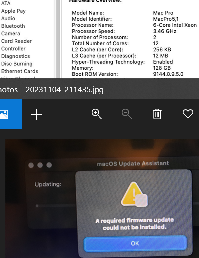

Error. A required firmware update could not be installed.

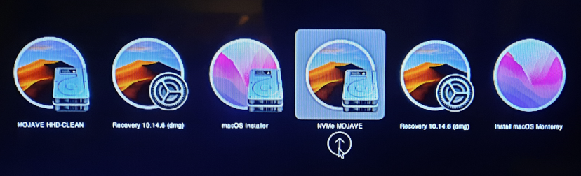

Note, when it reboots Opencore tell me to select a drive, perhaps I'm not picking the right drive?
Maybe I have TO disable SIP again?

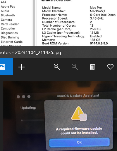

Enable VMM, and disable SMBIOS spoofing.
If you keep SMBIOS spoofing, you may get that firmware update error.

One more thing if I may. Now the I have Monterey installed on my NVMe. How do I get back to the Plist to change back the settings as recommended ?
It's no longer visible, unless I boot back into my spinner (MOJAVE)?

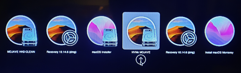

Cool, so I'm in Monterey and run opencore off the USB stick?
The reason I asked is when I went to boot back into Mojave on the spinner where I ran opencore and went to change it back, Cpuid1mask & SMbios, it showed it already reverted back to the original setting, unless I'm not looking at the right spot?

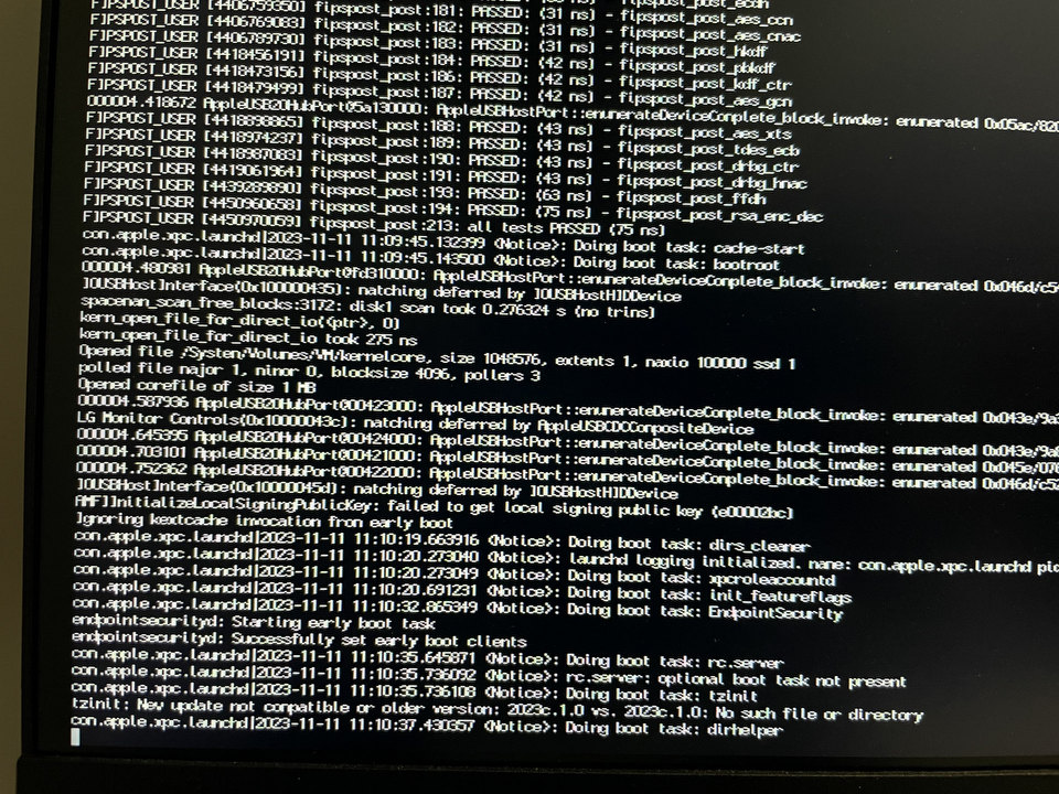

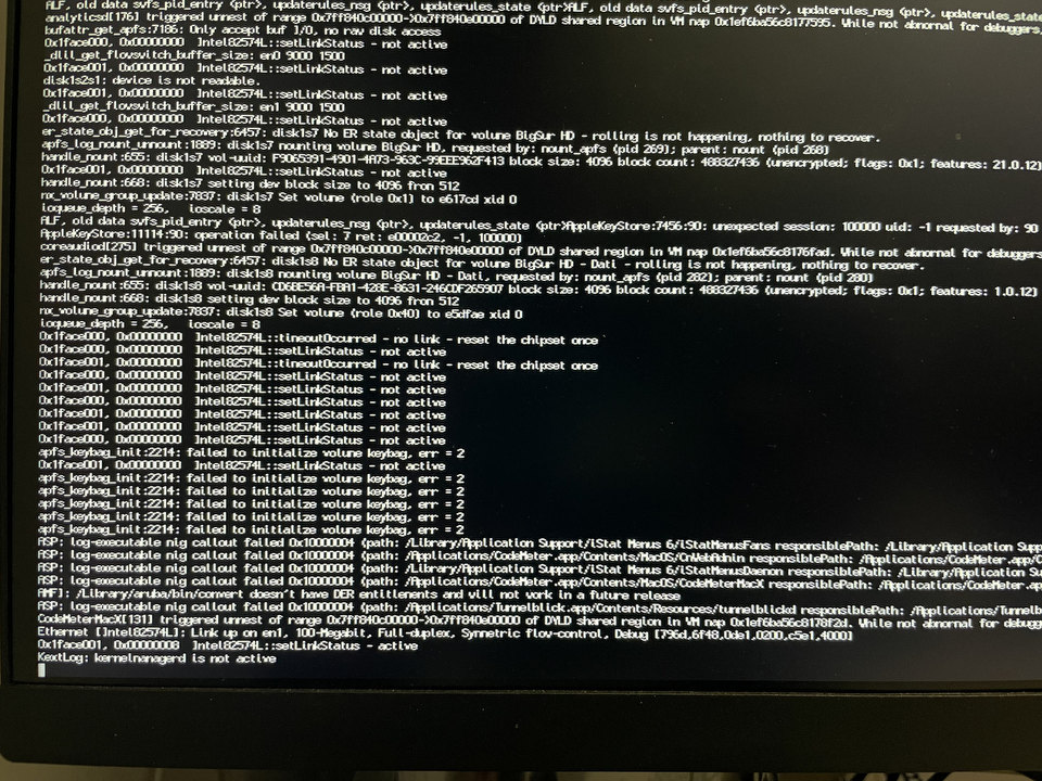

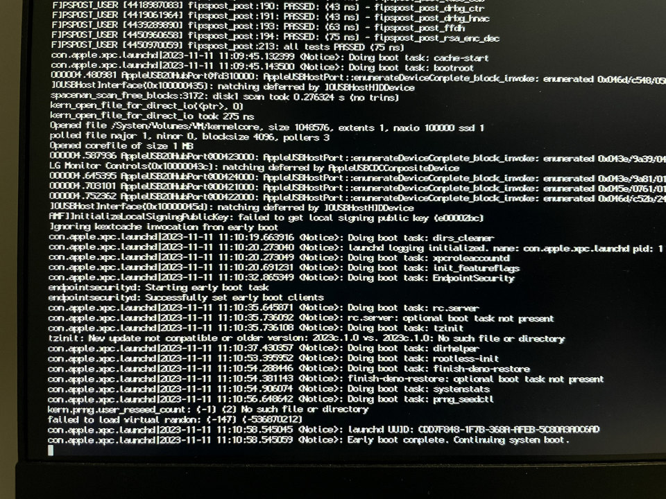

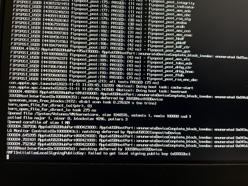

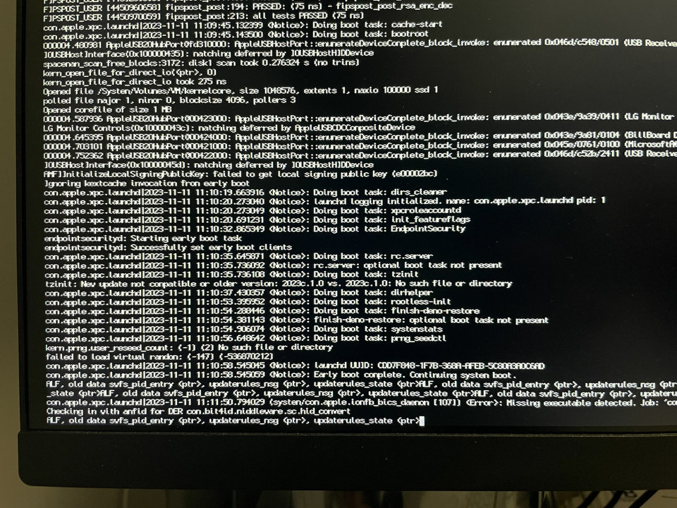

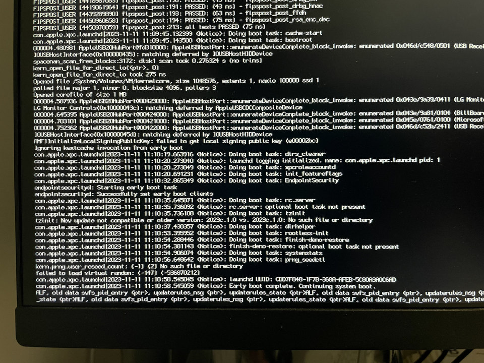

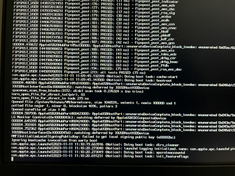

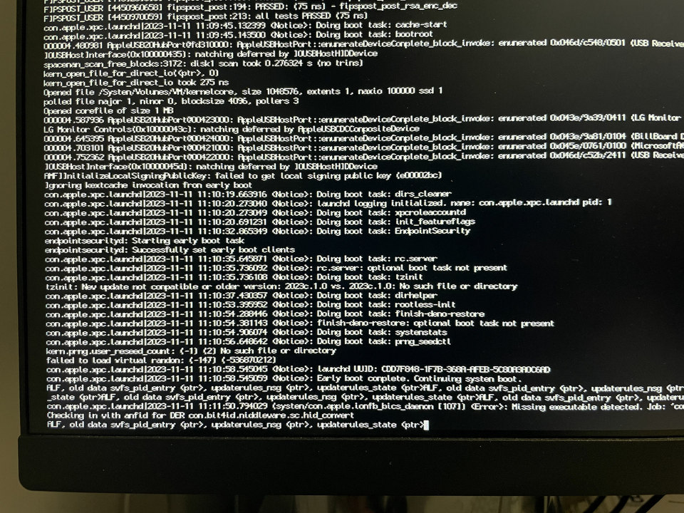

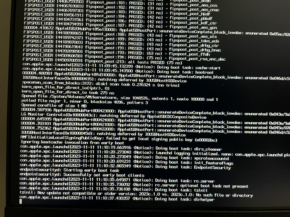

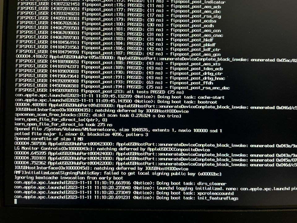

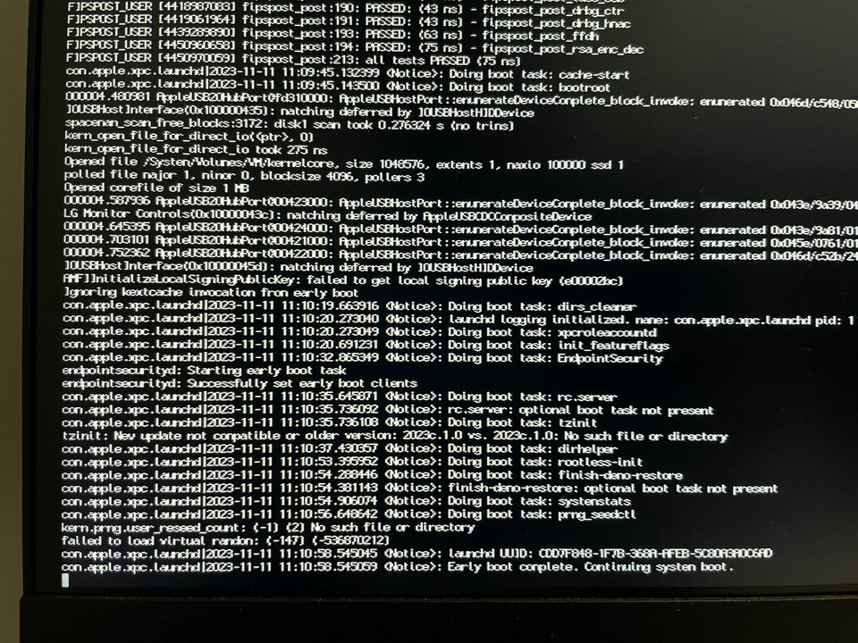

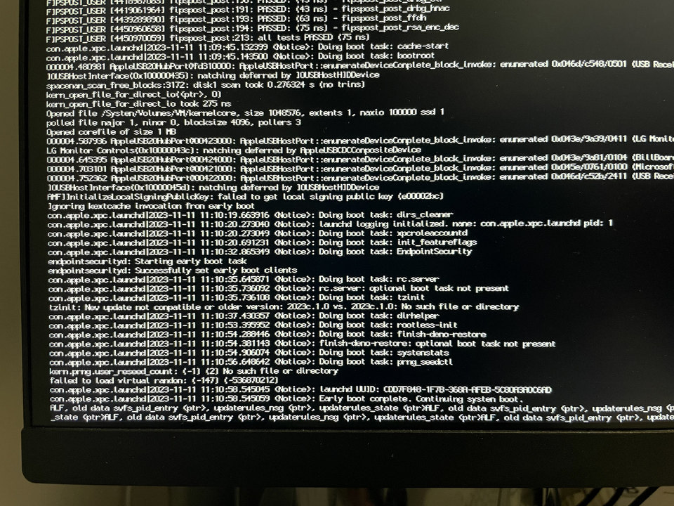

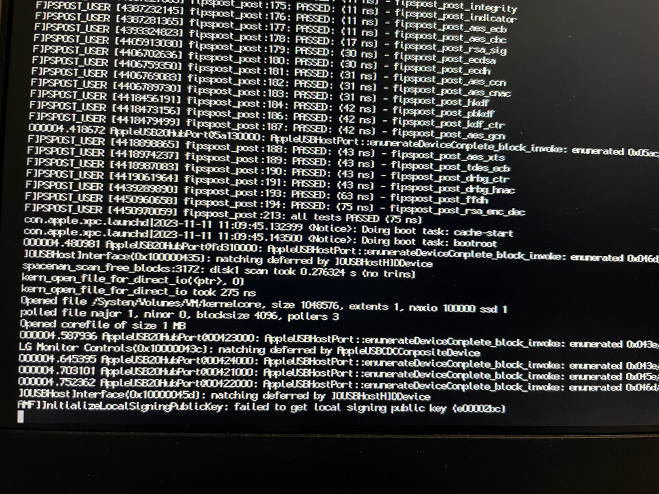

Hi. In my case I just upgraded from BigSur 11.7.10 to Monterey 12.7.1, using Monterey installer from may Application folder. All went fine, but after the upgrade was done (I didn't watch it while upgrading), I noticed that my MacPro needs much more time to boot. OC Picker appears normally (after 12-13 sec.), but after selecting Monterey volume for boot, progress bar increases normally until about 1/3, and then becomes terrible slow… it needs about 4’45” to arrive to 1/2. After that, Apple logo and progress bar disappears replaced for some seconds from an all-black screen and then from login window, after which all seems to work flawless.
With BigSur, for which I reserved an APFS container in the same drive (nVme Samsung SSD 970 EVO PLUS), boot time after selecting to boot with it in OC Picker is about 1 minute. So Monterey needs about 5 times the time used by BigSur. Once booted up, Monterey 12.7.1 seems to work very well, and disk performance seems also as good as they are with BigSur (measured with BlackMagic Disk Speed Test).
To troubleshoot the issue, I upgraded OpenCore from 0.91 to 0.96 editing config.plist from scratch, and I made some verbose boots, hoping to see one step that need particularly long time, but I found that many steps need much time. I toke some picture from all steps that toke more then 10” (some of them toke even 30”), bath I noticed even many other steps that toke between 5” and 10”, and all together brings boot time to about 5 minutes.
Can someone help me to troubleshoot this issue? I attach the pictures I toke during last verbose boot and OC config file.
Some ideas:
  • FirmwareFeatures and FirmwareFeaturesMask should be added to PlatformNVRAM not SMBIOS. This misconfiguration prevents using the vanilla installation method, so you have to resort to the VMM flag. Also note that a mix of installation methods 1 and 2 (see post #1) can result in a faulty installation.
  • Make sure that all kexts are updated to the latest versions.
  • Try disabling AVXpel.
  • If possible, try disabling audio assist. AudioDxe can cause a delays (though that should really only affect the OC boot picker).
  • Concurrent APFS installations (Big Sur and Monterey) have proven to be problematic (updates should be fine, though).
  • Some hardware component may be at fault.
Some ideas:
OK, this was an oversight. But in OC 0.91 config.plist, FirmwareFeatures and FirmwareFeaturesMask were correctly added to PlatformNVRAM, and and startup times was anyway insanely long with Monterey.
Yes, when I decided to try to upgrade OC too (hoping it patches the issue), I downloaded all components from scratch.
Maybe one of the above suggestions also has to do with long startup times, but I've found that the issue will magically disappear by setting SetApfsTrimTimeout to 0. With SetApfsTrimTimeout 0, startup from OC picker is much faster, even compared what it was with BigSur (and I guess with Catalina, as I don't remember huge difference with BigSur). Now my MacPro, from click on Monterey container in Boot Picker to loginwindow needs only 25 seconds. That's less then half the time it used with BigSur and previous configuration!
