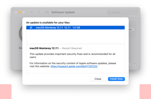

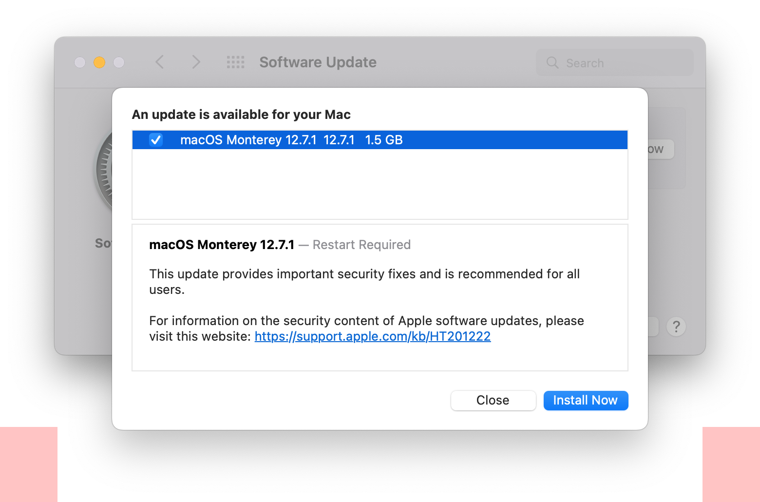

I have Option 2 configured (Hybridisation of board-id) and was offered:
Clicked on More Info... and was offered incremental update of 12.7.1 :
Installed without any issues.

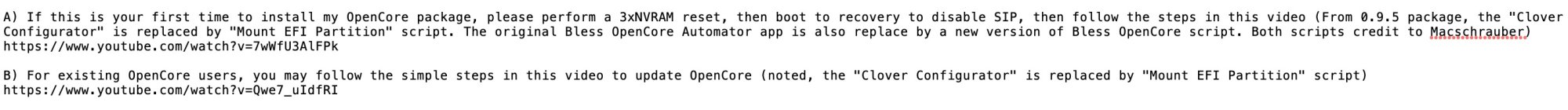

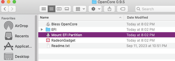

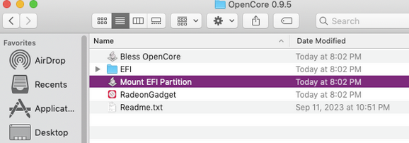

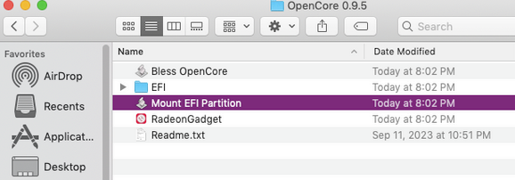

Please forgive me,
I downloaded martin's package 9.5 and it's missing the Clover configurator.
Needing Monterey. Am I do something wrong ?
A couple of years ago I just followed his video, but missing Clover ?
Okay I GOT the drive blessed, WOW. I made it seem harder that it was.

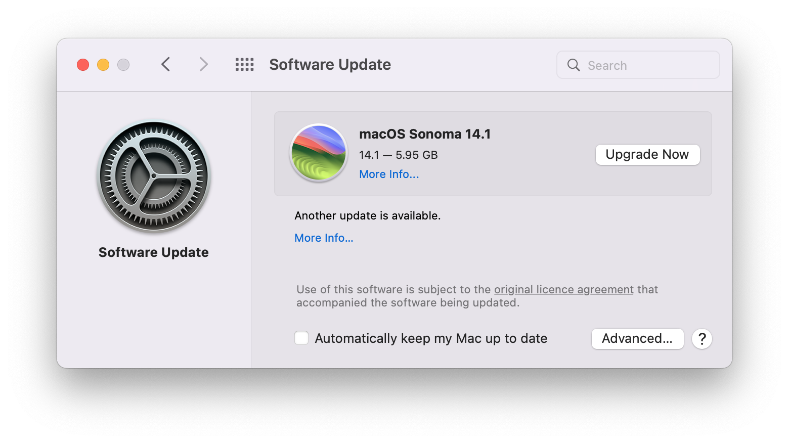

shows Sonoma for update. I need Monterey, went to advance and didn't see an option. Apple store?
You need to read Martin's instructions for updating OS - temp change to the CPUID and UpdateSMBIOS entries in the config file. Then after reboot you should see Monterey under the "other updates" twirler if you don't see it now. Change back when done and reboot again.
One way of downloading macOS installers is through OCLP. Download their app and through it you'll be able to download Sonoma, Monterey, Big Sure. Be sure you edit the config.plist as prescribed by Martin before launching the macOS Monterey installer though, and reverting those edits after Monterey and other macOS updates have been installed.
