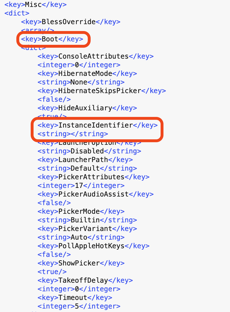

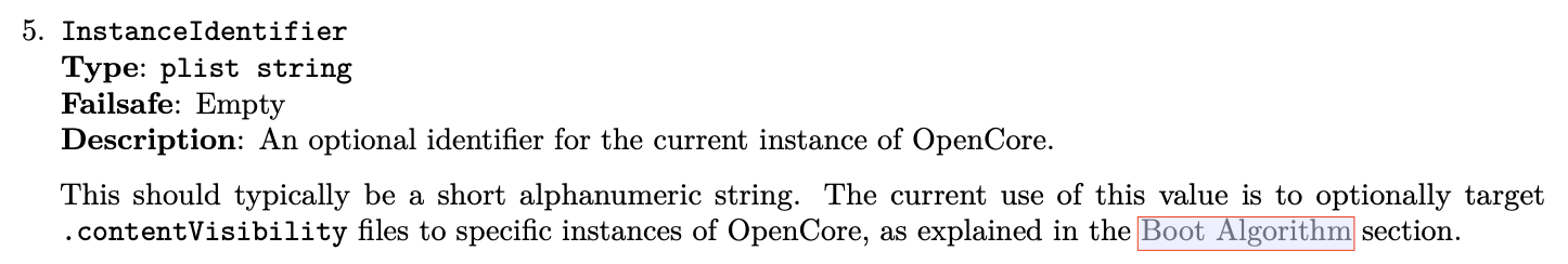

Going through the steps to upgrade from 0.9.3 to 0.9.5 and runnning ocvalidate gives the message
OCS: Missing key InstanceIdentifier, context <Boot>!
Serialisation returns 1 error!
Completed validating config.plist in 1 ms. Found 1 issue requiring attention.
Can't see any reference to InstanceIdentifier in the text so not sure what I need to do to fix (ocvalidate on the 0.9.3 setup was clean). Any pointers would be appreciated.
If you search the OpenCore manual, it will give you this.
Then if you further search the sample config. It will show you this

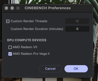

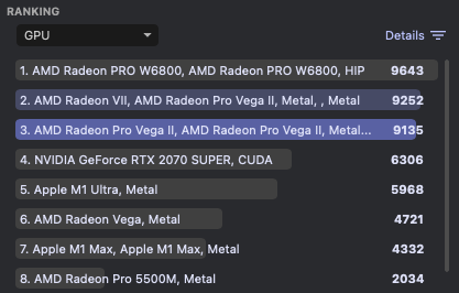

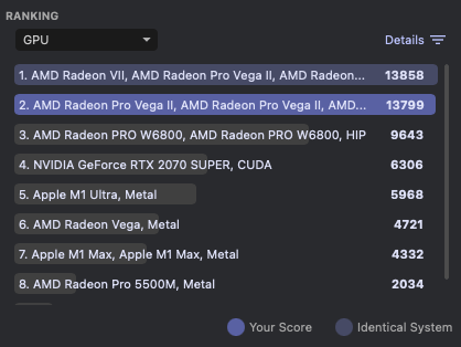

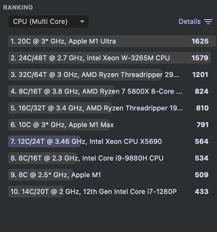

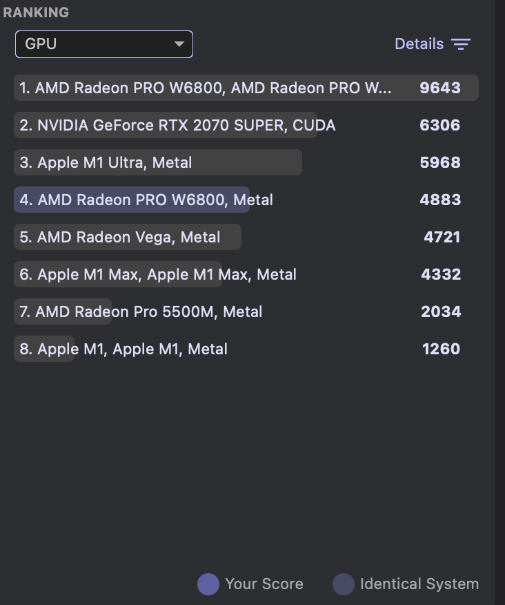

Another interesting observation - I remember someone asked if Cinema4D would work on a Mac
Yesterday I downloaded Cinebench24 - it did not start on my cMP on Windows without AVX
and on Mac OS my MacPro showed not very outstanding results, although it beat the M1 in terms of scores, but obviously lost to the M1Max, although it was ahead of some almost modern Intel

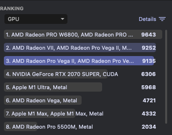

and the score for the W6800 GPU showed MacOS 1/2 of the W6800 for Windows (on computers that support avx-my test for Windows did not start)

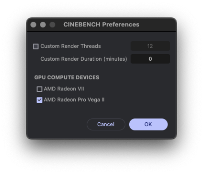

I'm gonna try cinebench 2024 with 3x VII. Downvolting of the VIIs would be totally necessary for that.

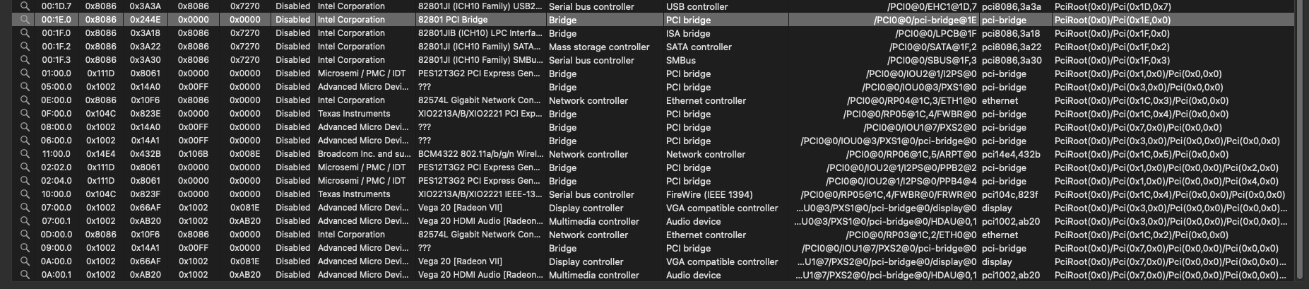

Should be, but the device property injection base on PCI path. Which means, assuming your cMP's device PCI path is identical to my cMP, then only the Radeon VII in slot 1 is downvolted.
If you have three cards, you should get all three card's PCI path, then apply the code to them one by one.
Technically, even not all of them are downvolted yet, the card won't draw too much power during boot. And you should able to boot with three Radeon VII, then downvolt them accordingly. Just don't stress all three cards at once until you finish downvolt, and tested them one by one (many benchmarks allow you to stress only a particular card).

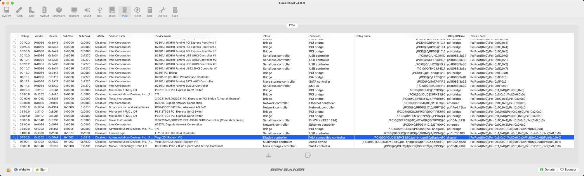

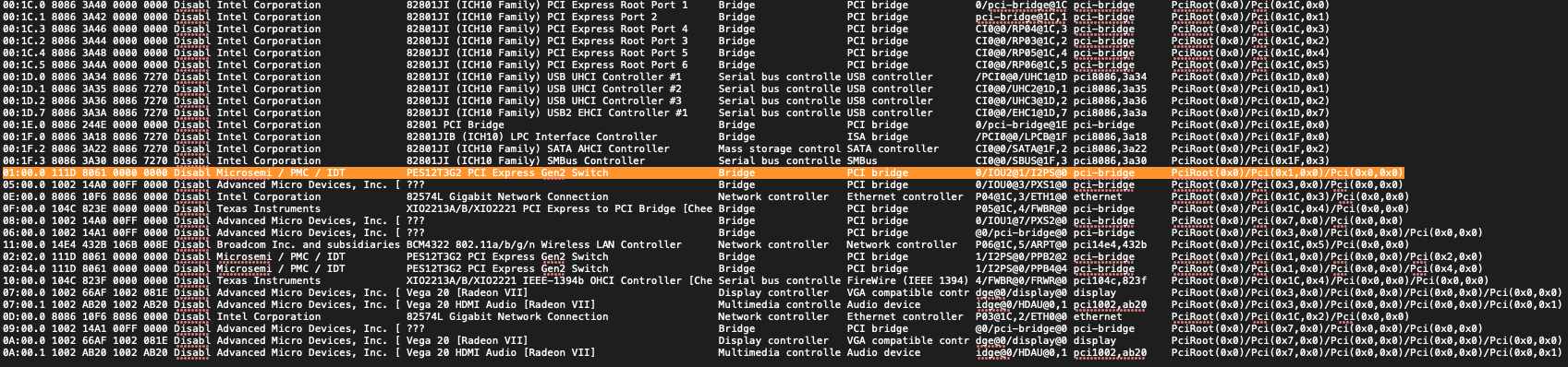

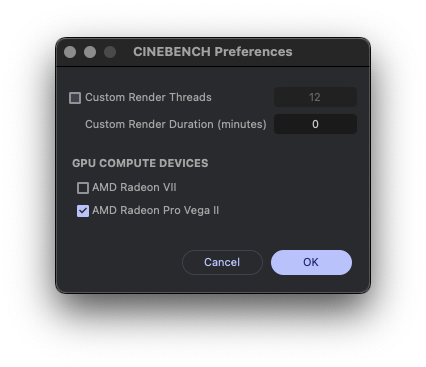

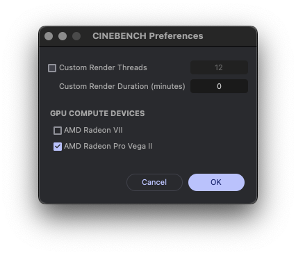

I managed to move OC and ESP to 2.5" SSD, mounted EFI partition from it, modified accordingly. I think it's in effect for PCIe1 VII, because CB2024 shows me this in it's prefs:
So the other GPU has changed to Vega II, previously it presented itself as a VII.
Now to the other slot, and later the third slot if I only could understand the PCIe path logics. Seems a little cumbersome to me at first at least.
Downloaded GFXutil, but didn't get any wiser with that output or numbering logic:

I still hope this is an appropriate thread for my questions. These questions do arise from using open core as a bootloader and an injector of device properties - and what else.. 🙄
How do I interpret the PCIe tree shown in my above post, to point OC plist properties to right devices installed (or not installed) in my cMP PCIe compartment. Is this a changing figure to take care of, or permanent and so repeatable between same kind of Macs. I guess the former, otherwise it would not be so damn difficult.
If I point to a PCIe device with wrong arguments, or values, what would happen. I'd give Radeon VII specs to a Inateck USB card. I really don't know how the thing works. It is exceptionally fascinating though, it would be fantastic to have time to dive in there and study a little bit more about all this.

There are only two 66af (the Radeon VII's Device ID) entry in your list. And one of them has same device path as my sample code (which should be the slot 1 in cMP). So, you should able to identify the other one is the 2nd Radeon VII.
Anyway, you can also get the device path by using Hackintool. This presentation may be easier.
Once you get the device path, you can simply re-insert that downvolt code once more, but just change the device path. Something like this

I think it's OK to discuss your problem at here. As long as we focus on how to get the device path, and how to apply the code in OpenCore config. But not focus on how to get the PowerPlay table, or how to figure out the minimum stable voltage.
Thanks again, downloaded Hackintool, looking at it now (PCIe device list).
PCIe slot1 x16: PciRoot(0x0)/Pci(0x3,0x0)/Pci(0x0,0x0)/Pci(0x0,0x0)/Pci(0x0,0x0)
PCIe slot2 x16: PciRoot(0x0)/Pci(0x7,0x0)/Pci(0x0,0x0)/Pci(0x0,0x0)/Pci(0x0,0x0)
PCIe slot3 x4: not needed in my config as of now
PCIe slot4 x4: ?
Further, I'd guess the path to 3 and 4 differs from slots 1 and 2, because they are behind another switch, and thus they share the available x4 lanes.
So I am turning towards those Texas Instruments or Microsemi bridges. Could I conduct the path to slot 4 if I knew which bridge those 3 and 4 are behind?
Or do I only get to see the appropriate full PCIe path after I insert the VII in cMP?
Maybe I'll just put something in slot 4, and I'll check what differs from this time.
edit: Or most propably it's an intel switch, when I think about it again:
edit2: I tend to trust tsialex on this, so it would be the: Microsemi / PMC / IDT switch.

Ok the last one worked, I now see 2x Radeon Vega II in CB2024. Result is a mere 150 pts less than last test with a VII and Vega II (Vega II is spoofed that is), with which I believe Vega II was dovnvolted and VII was not. Not a big difference in score.

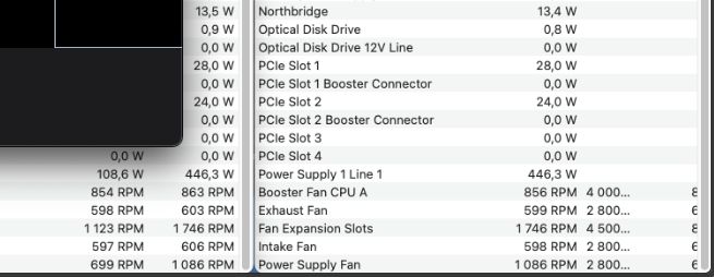

Power draw max 450W total during test.
Now I need to install the third VII in cMP and find out the PCIe tree to it with gfxutil or hackintool, and then downvolt that too through the config.plist.
ps. Thanks to OC helper guys and especially to developrs, Great work!
edit. Ok, I have found it. The last PCIe path to cMP slot 4 is:
PciRoot(0x0)/Pci(0x1,0x0)/Pci(0x0,0x0)/Pci(0x4,0x0)/Pci(0x0,0x0)/Pci(0x0,0x0)/Pci(0x0,0x0)
So for all you guys installing 3x VII in your cMP, here is the "DeviceProperties" part for your config:
<key>DeviceProperties</key>

Downvolted 3x VII in a cMP 2009 with Dual Pixlas mod: CB2024 achieved 13799 points. So in the ballparks of a single nVidia RTX 3080, and little less than a RTX 4060 Ti. On par with 7900 XT. And about 1.6x as fast as a Apple ASi M2 Ultra GPU (8668 pts).
I'll call it a day for now.
