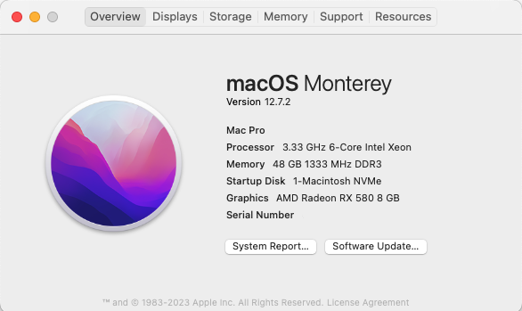

@crjackson2134 your config looks good. I'm really surprised your Monterey installation isn't booting. Can you confirm that if you add the VMM flag to this very config, your installation will boot. Also, just to make sure: It looks like your graphics card is installed in Slot 2. Is that right?

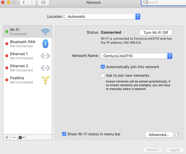

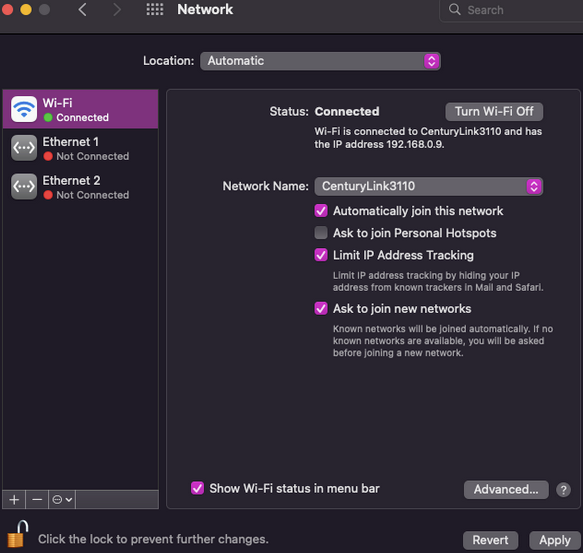

I having an issue not being able to quit my audio program Pro Tools. Just hangs on the spinning ball.
I am using a firewire device for the input and from what I noticed in Mojave in the network tab you can clearly see my firewire device, but in Monterey it's not listed?
My question being if the firewire device is not listed in the Network tab, could that be why it doesn't see it to shut down the program?

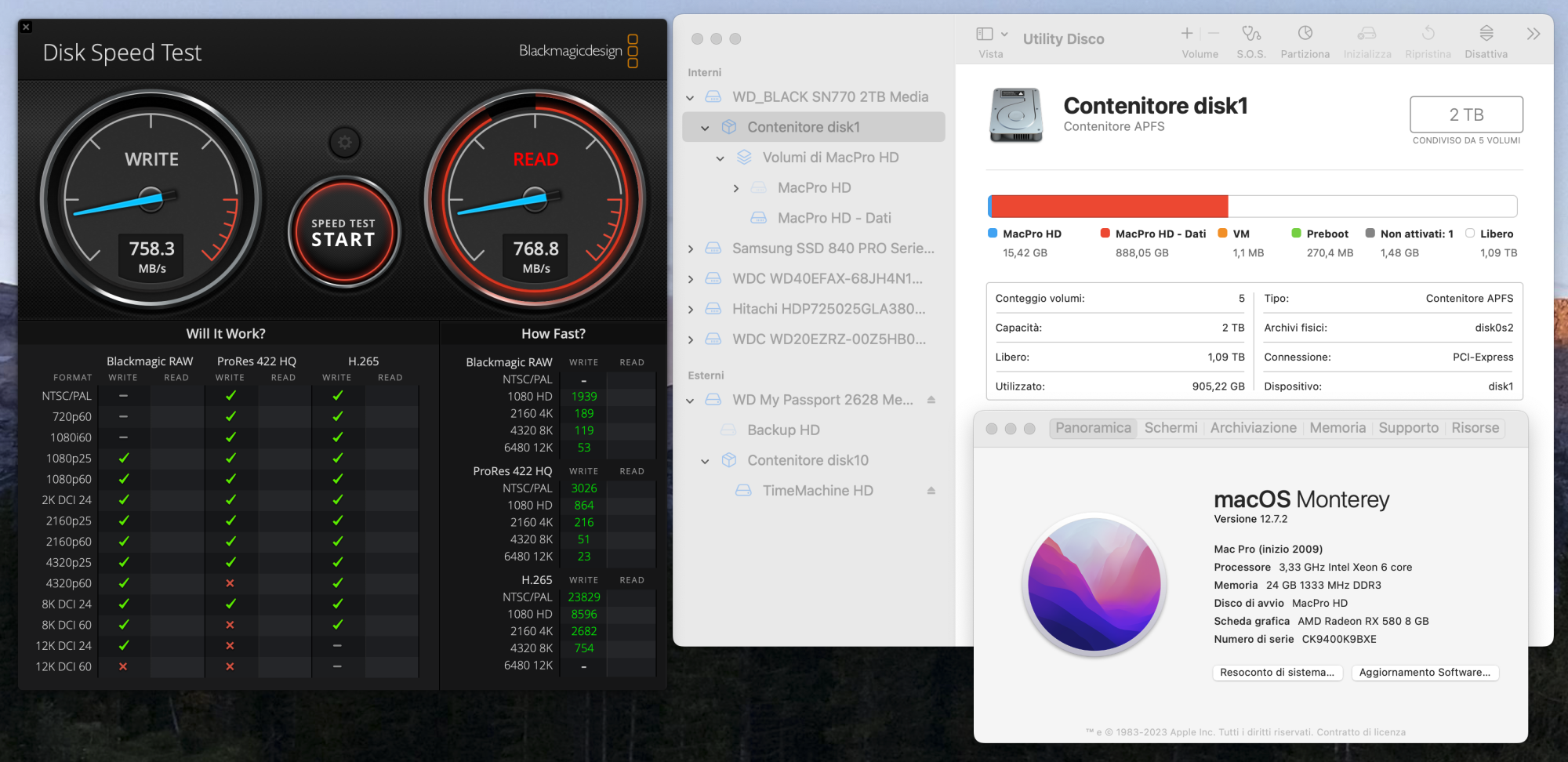

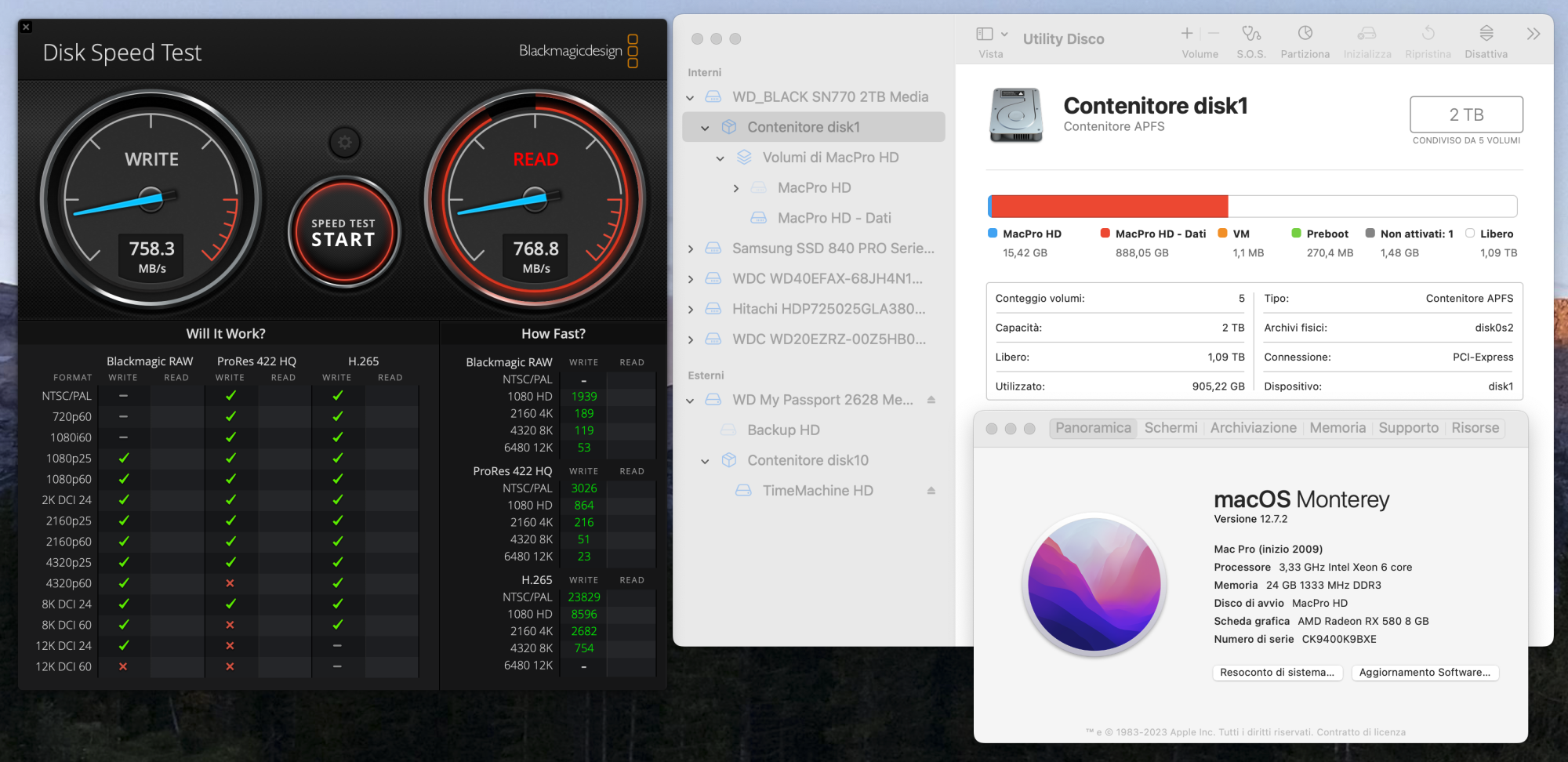

Hi. Does someone use a WD Black SN770 NVMe SSD on his cMP here? I got one to replace my Samsung 970 EVO plus that seems to be disliked in Monterey. With SSN some issues seems to be disappeared, but speed measured by Blackmagic Disk Speed Test are really worse. Even I measure it in Monterey booting from SN770, even I measure it from Mojave (booted from another device). About half of the speeds measured with Samsung 970 EVO plus.
Known issue with a MacPro5,1 when installed to slots 3 or 4:
The issue seems to be with MacPro5,1 IDT PCIe v2.0 switch that share the southbridge PCIe lines to slots 3 and 4, since when installed to slots 1 or 2 the SN770 blade works correctly at 5GT/s.
The SN770 works perfectly fine when installed to a MacPro6,1.
Correct throughput when installed to a MacPro6,1:
diskspeedtest-png.2042217

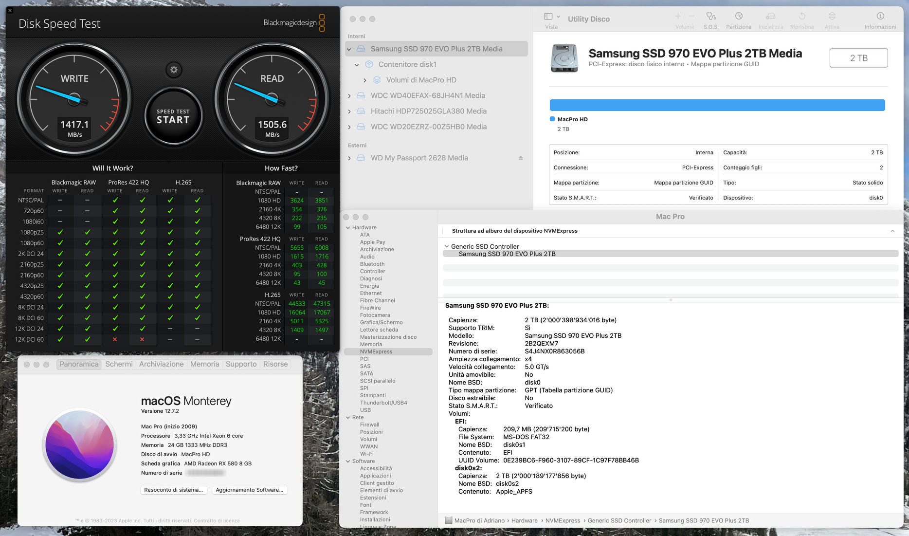

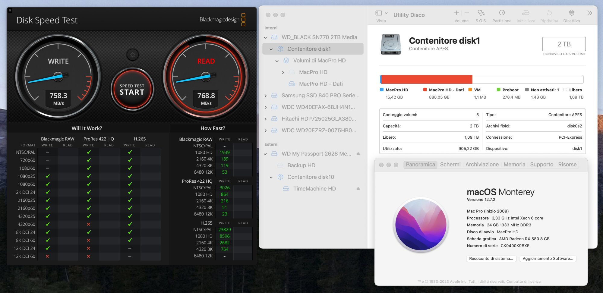

OK, thanks. I'll try to move it to slot 2, even it's really near to the Radeon RX580 fans... for Samsung SSD there isn't any speed difference. Here it's in the slot 3 with the same adapter I used for SN770.
