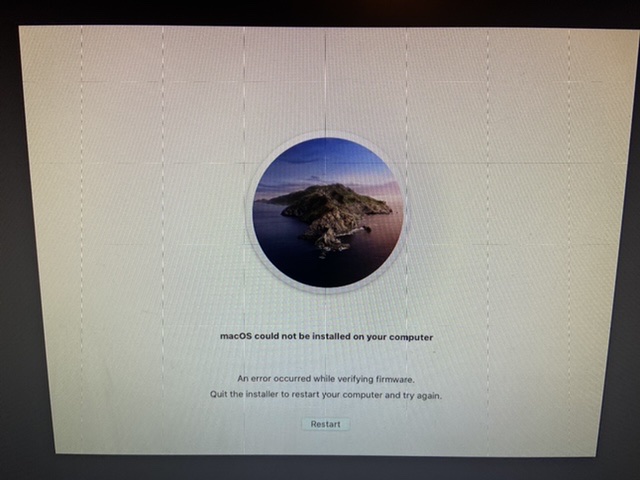

Trying to install Catalina on my old dual socket 4,1 and running into problems. I updated to Mojave and 144.0.0.0.0. I installed Open Core. I created a modified APFS disk EFI disk with the VMM flag set and tried to install Catalina to the drive but the installer complained that it couldn’t verify my firmware so wouldn’t install on and APFS disk. The dialog wanted me to choose an HFS+ disk. So I repeated open core step on HFS+ and installed Catalina to it. The Calalina installer go t further this way but after reboot and some time I’d get the same firmware not verified message. Any clue what I’m doing wrong here?
Are you injecting SMBIOS? If so, don't.

I guess not. I followed the directions better today and I got it to install on an APFS disk. I was trying to import from #1346 of the AMD Accel thread but when I repeated steps in this guide from fresh 0.5.6 release with downloaded config from #1 it allowed me to install Catalina.
h9826790
macrumors P6
Apr 3, 2014
16,656
8,587
Hong Kong
My package at there is for HWAccel.
“Able to run Catalina” is just a bonus. And that package doesn’t allow for Catalina installation natively.
For that package, you have to turn ON VMM flag, and turn OFF SMBIOS spoofing for Catalina installation.
And after Caralina installation, please revert the config plist file.
