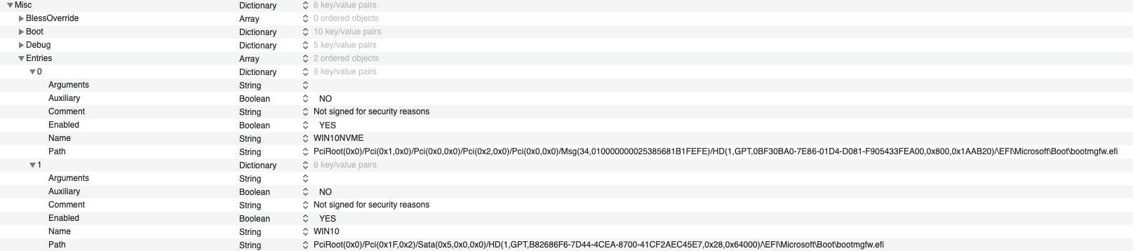

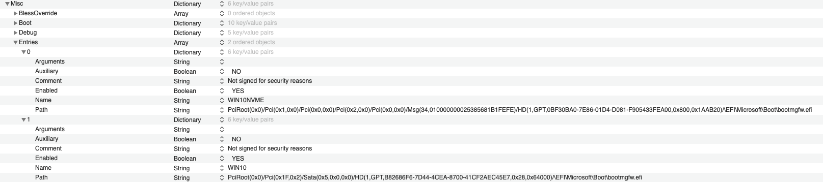

When you boot your EFI Windows in a debug OC version with logging enabled, when you open the log file you will see something like this:
Code:
PciRoot(0x0)/Pci(0x1F,0x2)/Sata(0x5,0x0,0x0)/HD(1,GPT,B82686F6-7D44-4CEA-8700-41CF2AEC45E7,0x28,0x64000)/\EFI\Boot\bootx64.efi
in the OC picker it will appear as WINDOWS same as in the regular Apple bootpicker. Apple will boot any external/internal drive which has a valid bootloader in \EFI\Boot\bootx64.efi.
If you modify this entry like this:
Code:
<key>Entries</key>
        <array>
            <dict>
                <key>Arguments</key>
                <string></string>
                <key>Auxiliary</key>
                <false/>
                <key>Comment</key>
                <string>Not signed for security reasons</string>
                <key>Enabled</key>
                <true/>
                <key>Name</key>
                <string>WIN10</string>
                <key>Path</key>
                <string>PciRoot(0x0)/Pci(0x1F,0x2)/Sata(0x5,0x0,0x0)/HD(1,GPT,B82686F6-7D44-4CEA-8700-41CF2AEC45E7,0x28,0x64000)/\EFI\Microsoft\Boot\bootmgfw.efi</string>
            </dict>
        </array>
OC boot picker will show another entry called WIN10 as defined in key Name for the same drive.
If you rename \EFI\Boot\bootx64.efi to \EFI\Boot\bootx64.efi.bak
The WINDOWS boot entry will disappear from OC bootpicker as well as from the normal Apple bootpicker (if you have a card which can show you the Apple bootpicker). cMP firmware is looking only for this entry\EFI\Boot\bootx64.efi and if it can't find it, it will never boot from that partition.
If you rebuild the bootloader through recovery, chances are that the file will be recreated. Same might happen during Windows upgrade. At this moment this is still a speculation, because I did not test rebuild/upgrade yet.

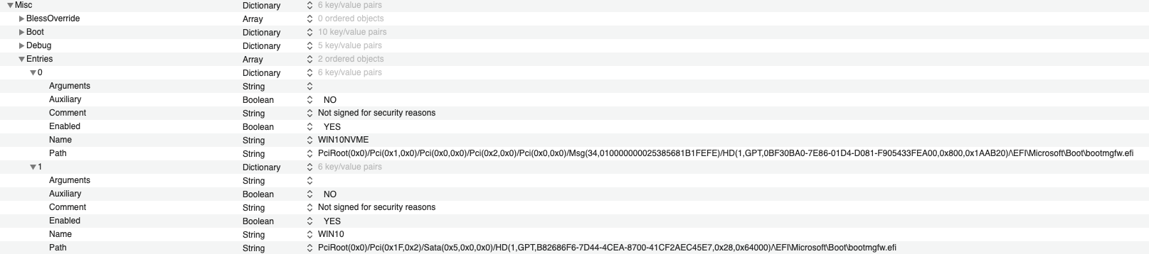

Code:
Code:
<key>Entries</key>
        <array>
            <dict>
                <string></string>
                <false/>
                <key>Comment</key>
                <key>Enabled</key>
                <true/>
                <key>Name</key>
                <key>Path</key>
            </dict>
        </array>
I think I understand now. So in your config snapshot above, that is actually two different windows installations?
In the screenshot yes. 2 different partitions with 2 different Windows drives. One is on SATA 3 alongside Mojave and the other - on its own NVME drive.
