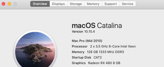

Updated to 10.15.4 and Handoff started working. Weird. I also have internal speakers already. I did change my config to the default in this thread. No issues with update so far. Fingers crossed.

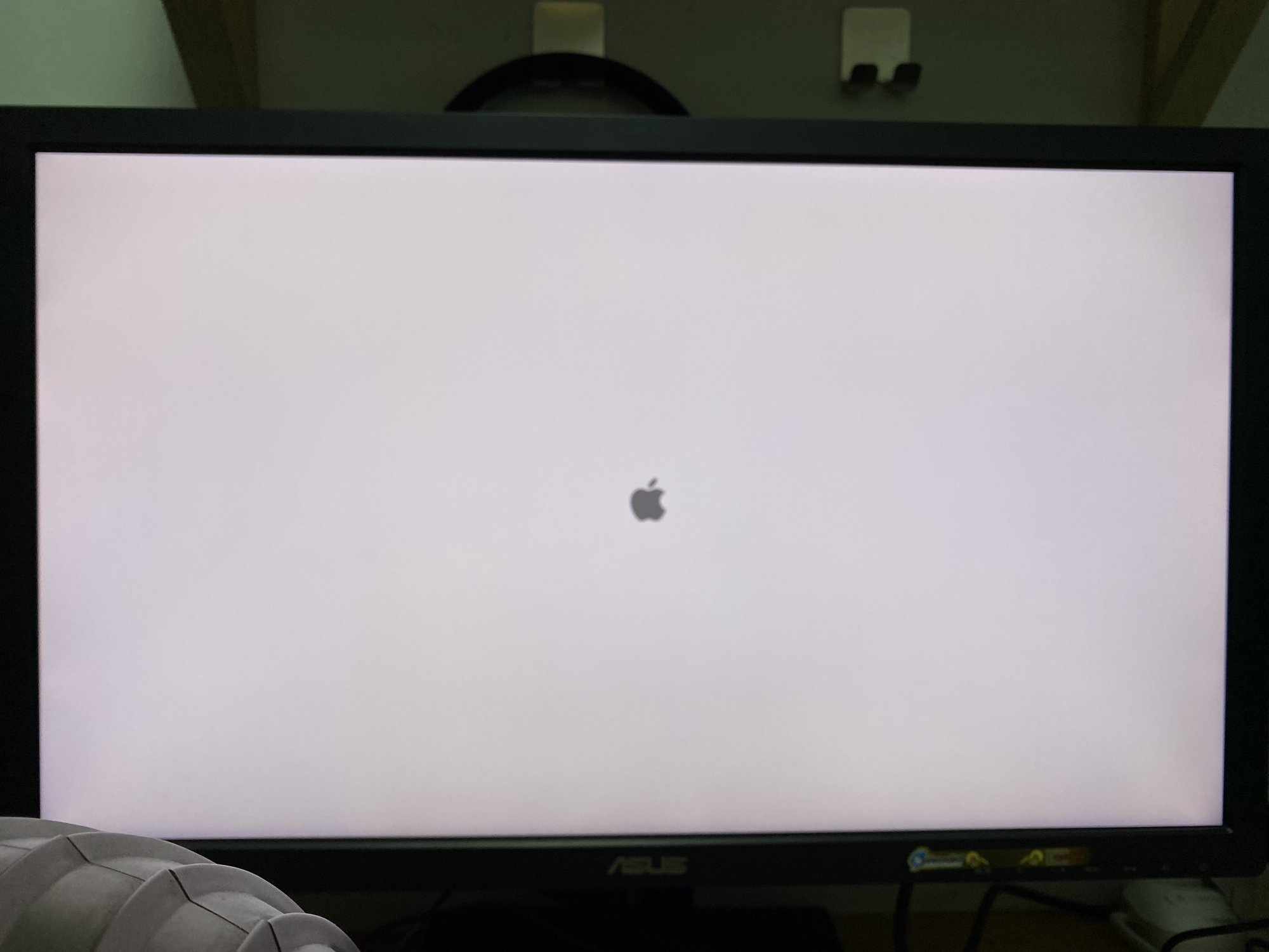

update the current state:
Drive:
1. SATA SSD Bay1 (Catalina OS installed and success boot from boot menu)
2. Intel NvME SSD (Catalina installed from 1 OS use upgrade from Mojave) (Open core EFI contained)
3. Kingston SATA PCIE SSD (contain Data and Catalina installation program)
4. USB drive with Mojave installation program
Situation:
1. Open Core boot menu exist, can see the boot option
Boot Menu
-1. SATA SSD Bay1 (Catalina OS installed and success boot from boot menu)
-2. Recovery of 1
-3. Intel NvME SSD (Catalina installed from 1 OS use upgrade from Mojave) (Open core EFI contained)
-4. Recovery of 3
-5. Reset NvRAM
2. The EFI folder in drive 2, edited Config to allow installation of Catalina
3. Boot from SATA SSD of Catalina is success
4. Boot from Drive 2 Intel SSD fault to boot and freeze in apple logo like above image
Installation process:
1. Open core installed in drive 2 as it is original Mojave boot disk.
2. fault boot from drive 2, remove all drive rest NvRAM and boot from Mojave USB
3. install Mojave in Drive 1 (SATA SSD Bay1)
4. Edit config file Upgrade Drive 1 to Catalina (SATA SSD upgraded to Catalina)
5. keep config setting, upgrade Drive 2
6. Drive 2 still boot fault, freeze after boot menu
Now I can use open core to boot to SATA Bay, what should I do if I can boot from NvME SSD?
MACPRO FIRMWARE is 144.0.0.0.0
I have seem the Preboot of Drive 2 in CoverConfig
Please advice if I have done anything wrong
Thanks!

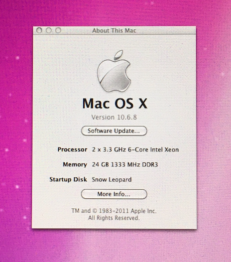

Just curious, anyone has OSX drive laying around? I sold my Yosemite drive already, too lazy to make another one just run a "test for fun".
Theoretically, we can now boot Snow Leopard on 5,1 via OpenCore boot screen with RX580 (or some other non supported GPU like Radeon VII etc). Of course, no acceleration will work, but we should able to see the screen, and use it (at least should work for some simple stuff).
Anyone want to try?
Confirmed. Snow Leopard through OC with an RX 580 works beautifully.

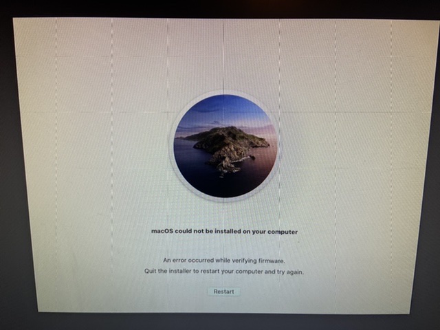

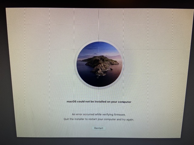

Trying to install Catalina on my old dual socket 4,1 and running into problems. I updated to Mojave and 144.0.0.0.0. I installed Open Core. I created a modified APFS disk EFI disk with the VMM flag set and tried to install Catalina to the drive but the installer complained that it couldn’t verify my firmware so wouldn’t install on and APFS disk. The dialog wanted me to choose an HFS+ disk. So I repeated open core step on HFS+ and installed Catalina to it. The Calalina installer go t further this way but after reboot and some time I’d get the same firmware not verified message. Any clue what I’m doing wrong here?
You 100% follow the steps in post #1?
