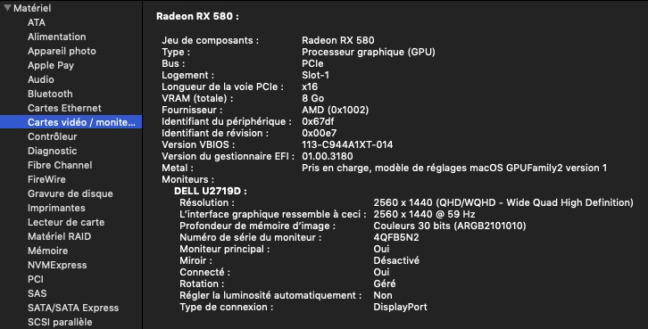

I have a 4K screen with a wired keyboard and a RX580. I cannot make the bootscreen show, while holding the Esc or Option button. I can go to recovery screen with the 4K screen, I just don't get the bootscreen? Is there a specific way to do it? @cdf
Thanks
Thanks
Try UIscale 02
Thanks
Please make sure your card still with the factory ROM. Recovery Partition can always work regardless boot screen ability.

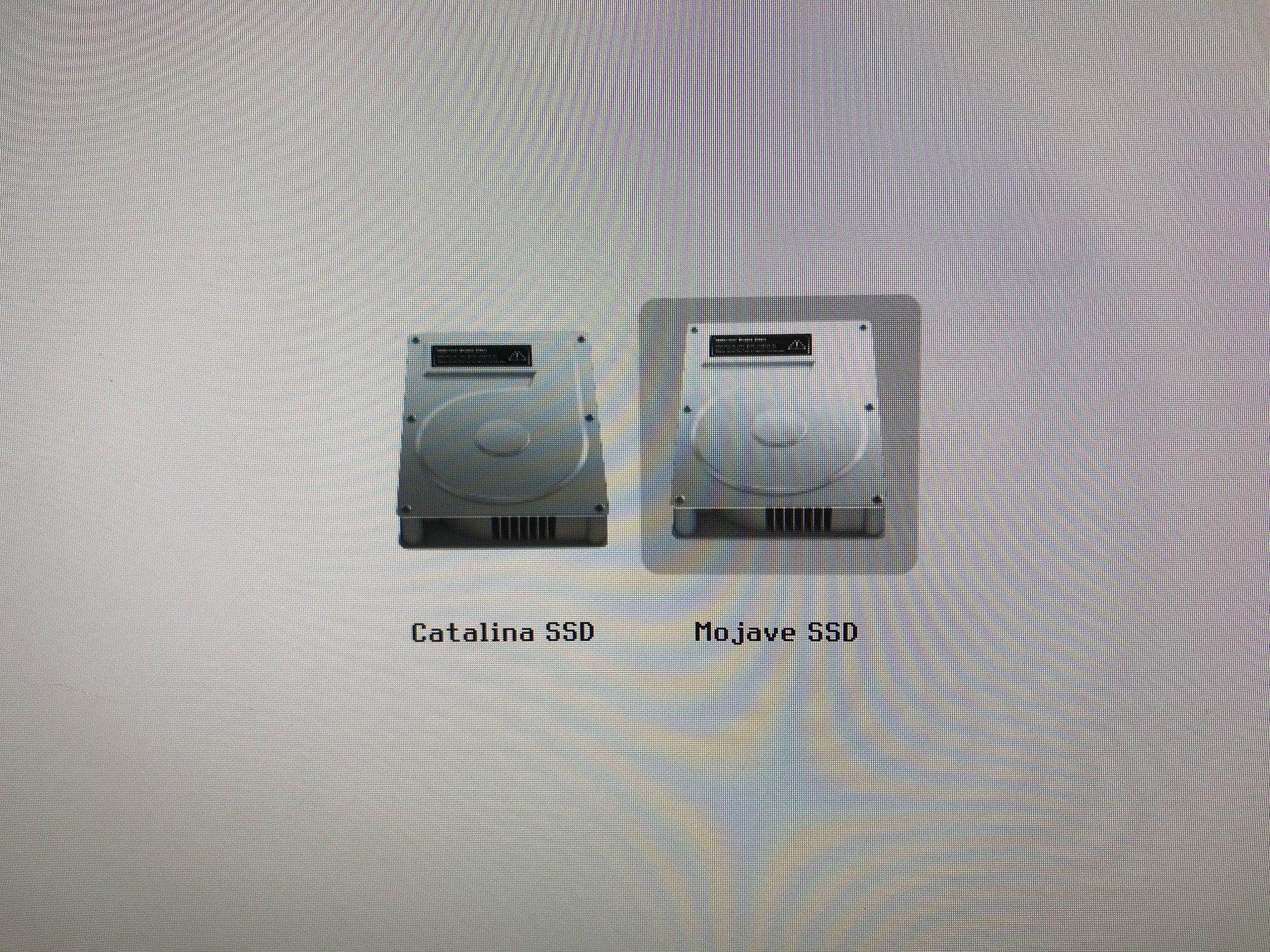

I do this all the time, I just don't use the boot pickers in macOS or Windows. Take a look back at this post; that's the version of OC I'm still using right now. For me it boots with the three options shown in the video (Mojave, Windows, Catalina). To set the default, when the OC boot picker appears just select the one you want as default and hit CTRL-RETURN. If you want to temporarily boot into one or the other, just choose it and hit RETURN as normal.
I usually leave it with Windows selected as default, so if that's the OS I'm using that day, when I walk away and it decides to randomly auto-update it's at least sat at the correct OS with the updates partially complete, rather than defaulting to Catalina, where I'd then have to reboot and wait for the Windows updates to finish.
And to be clear, it's rEFInd which is handling the boot of Windows in CSM mode - OC can't boot CSM Windows, but it can boot rEFInd, which in turn can boot CSM Windows. It's chainloading; not supported by OC IIRC, but it works perfectly for me.
Follow the instructions in #1 to drop the .zip file contents into an EFI partition and bless the partition. Reboot. It's really that easy.

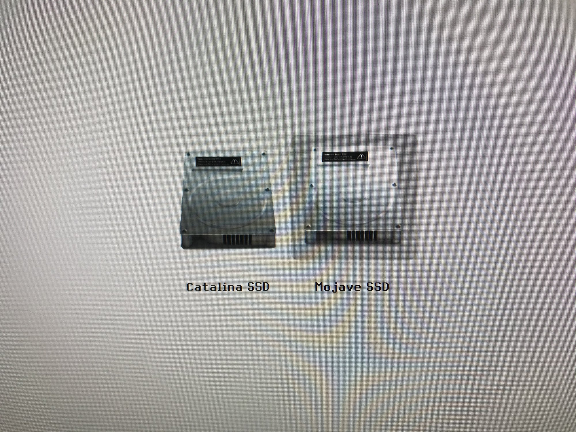

Here is the video to shows how it actually looks in the NdkBootPicker
It's extremely simple, remove the wallpaper in the latest NdkBootPicker 0.1.8, which should makes NdkBootPicker only use the default lightgrey background. (For info, I also set ConsoleAttributes to 112 and PickerAttributes to 1, even that shouldn't do anything in this case.
And use my icon in post #1801 to replace all required icns (e.g. os_mac.icns or os_win.icns)

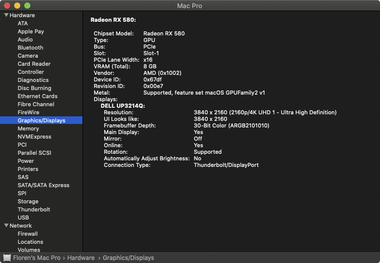

I have a factory unmodified RX580, purchased brand new from Amazon.com, not a 3rd party seller.
I have an SSD in Slot 1 and a NVMe on Syba PCIe.
Thanks
I have same issue as you with original rom for RX580 I can't see bootpicker.
I have a factory unmodified RX580.
Please perform the following tests
Test 1:
1) boot your cMP with OpenCore that should have boot picker
2) once you hear the boot chime, press the up arrow on the keyboard a few times (e.g. 10 times, about 2 times per seconds should be good enough)
3) wait for a minute or 2 (this is to ensure that the boot picker is actually there, but your cMP won't continues to boot to OS after time out)
4) power off the monitor, wait for 5 seconds, power on the monitor (NOT sleep, but real power cycle it)
5) if still nothing display, please power cycle the monitor one more time.
If you still can't see the boot picker, you can press enter to continue to boot. (Or shutdown the Mac etc)
Test 2:
1) Boot to desktop
2) reboot your cMP, but keep your monitor awake to check if you can see the boot screen (it usually can be done by keep playing the monitor's menu)
Reactions: TECK
