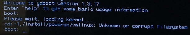

I have got MintPPC installed on a 500MHz Powerbook G3 Pismo with 1GB RAM and a 40GB HDD using your 32-bits MintPPC (G3, G4) .iso burnt onto a CD as trying to boot the installer from a USB flash drive was too convoluted and time consuming.
Using the the ‘c’ key after the boot chime does not work, giving the error message shown in the attachment, using a CD-R and a CD-rw disk burnt at different speeds using different burning software.
The solution is to boot into Open Firmware by holding down the “Command,” “Option,” “0” and “F” keys simultaneously as the Pismo boots, and then at the 0 > prompt, type
boot cd:,\install\yaboot
and then press Return/Enter.

Thank you, your error message is exactly what I experienced with the MintPPC CD on my PowerBook G4, and as for my Pismo it wouldn't boot at all.
I now know to try booting in OF ;)

Sorry, I meant the Pismo won't boot the MintPPC CD at all. I will try OF some time.

Thanks for the info how to boot the 32-bits installer from CD. I added your information to the official instructions.
