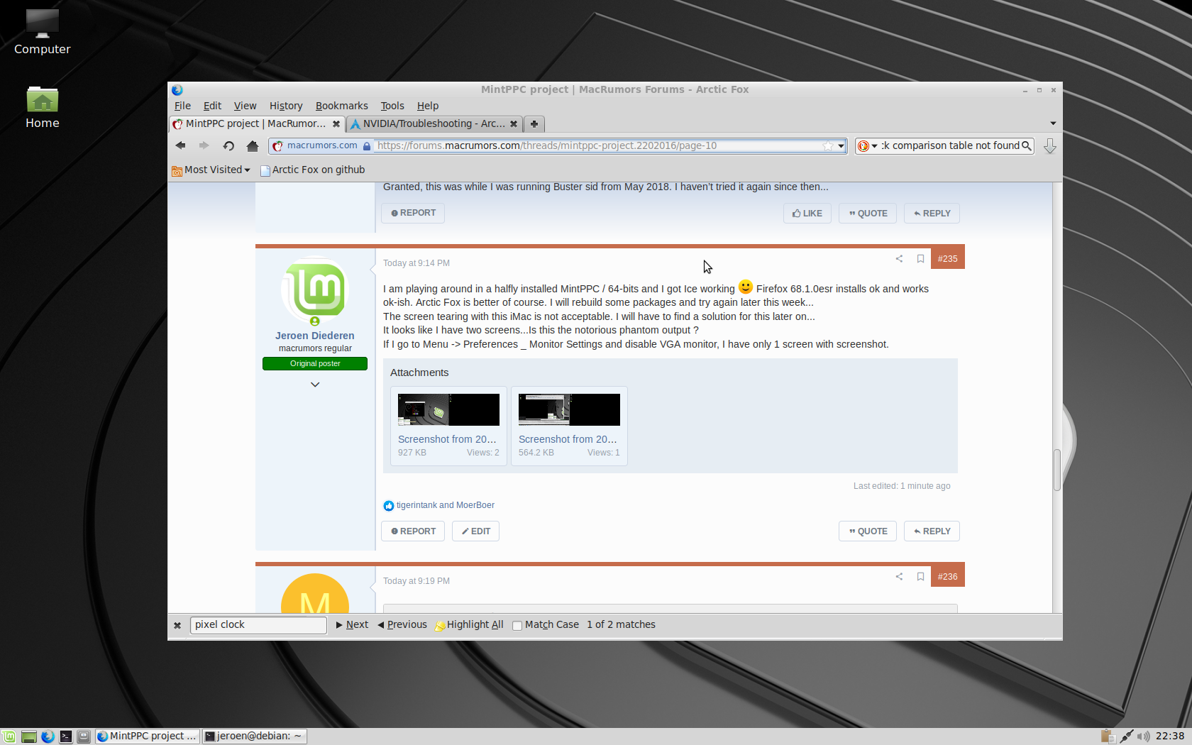

I am playing around in a halfly installed MintPPC / 64-bits and I got Ice working :) Firefox 68.1.0esr installs ok and works ok-ish. Arctic Fox is better of course. I will rebuild some packages and try again later this week...

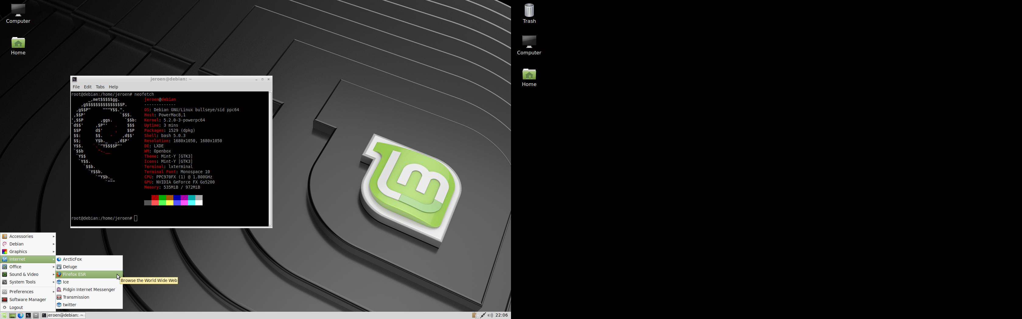

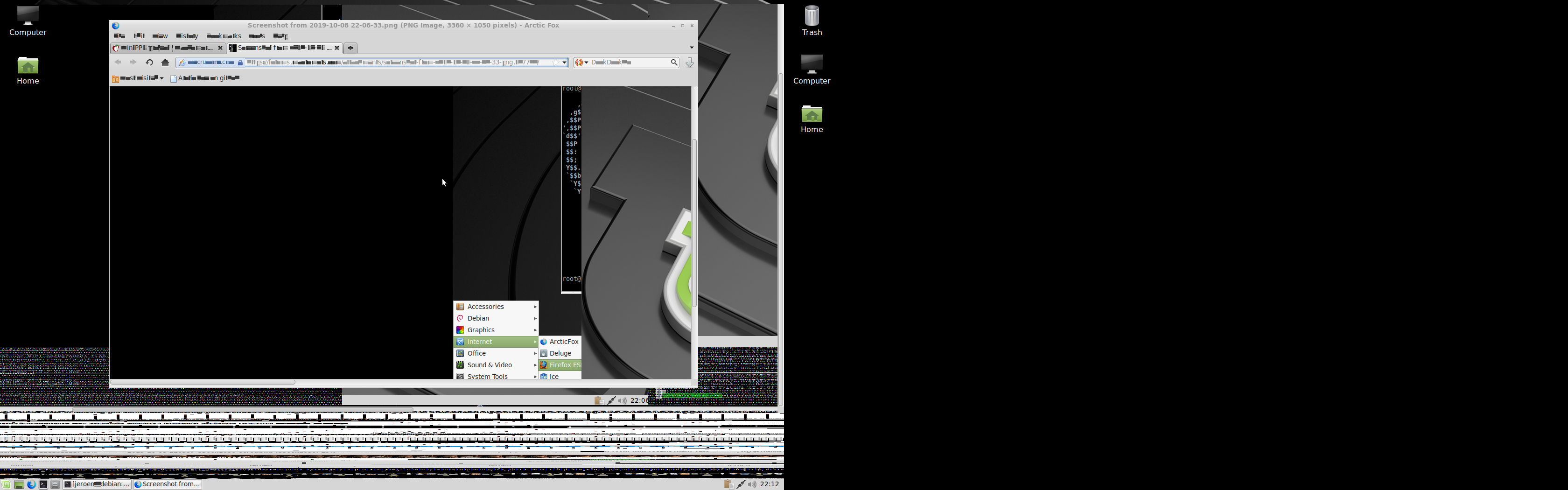

The screen tearing with this iMac is not acceptable. I will have to find a solution for this later on...

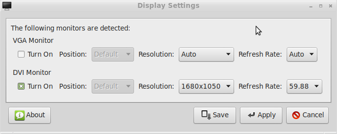

It looks like I have two screens...Is this the notorious phantom output ?
If I go to Menu -> Preferences _ Monitor Settings and disable VGA monitor, I have only 1 screen with screenshot. The Monitor settings as attached give me 1 screen and NO screen tearing :)

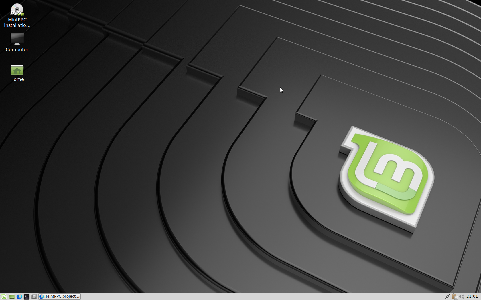

MintPPC / 64 works now. You can try it out. The only things that do not work are Software Manager (could not be installed due to missing libraries in the ports) and gnumeric (broken in the ports). I will try to fix this in the coming time. For now, I call it alpha testing time. See http://mintppc.nl Installation instructions for details. Good luck. Be aware that Nouveau does not work completely for the Nvidia card and screen tearing is seen when opening things like Arctic Fox up fullscreen.

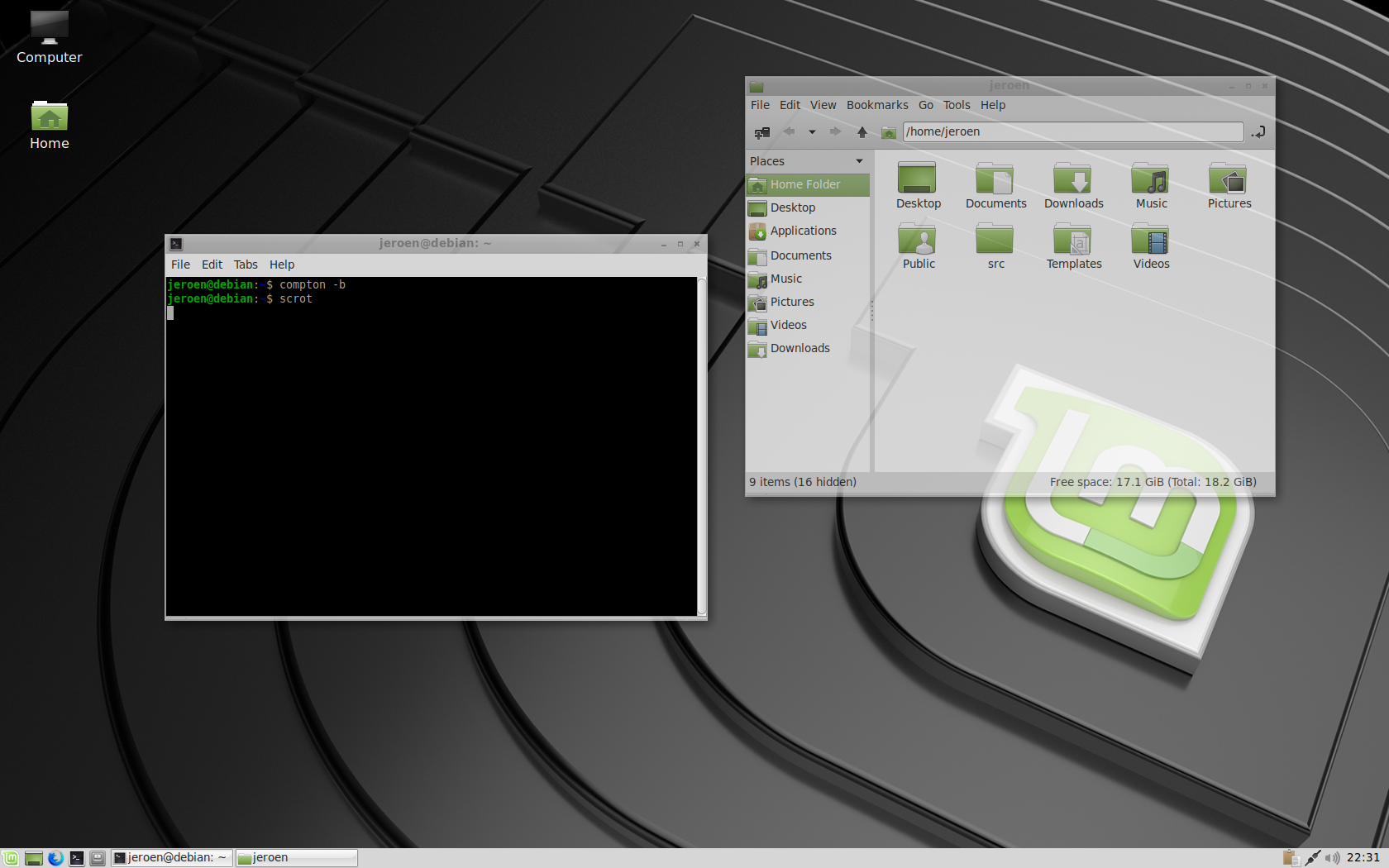

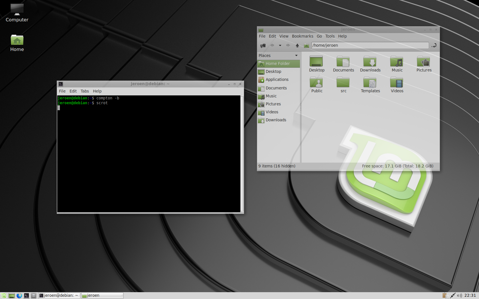

Moving round windows and displaying them becomes better by using compton and compon-conf. You get nice transparent windows too, see screenshot. Unfortunately, screen tearing is still there...Update: compton destroys my xorg.conf solution as posted below. Forget about compton then for nVidia.
Reactions: z970
Oh man, I think I solved the screen tearing issue more or less. I use an xorg.conf file I found on a bug report against xserver-xorg-video-nouveau, and it seems to be working !!! Even better, I only realize it now...I was the one who filed the bug report and found this solution hahahaha, LOL

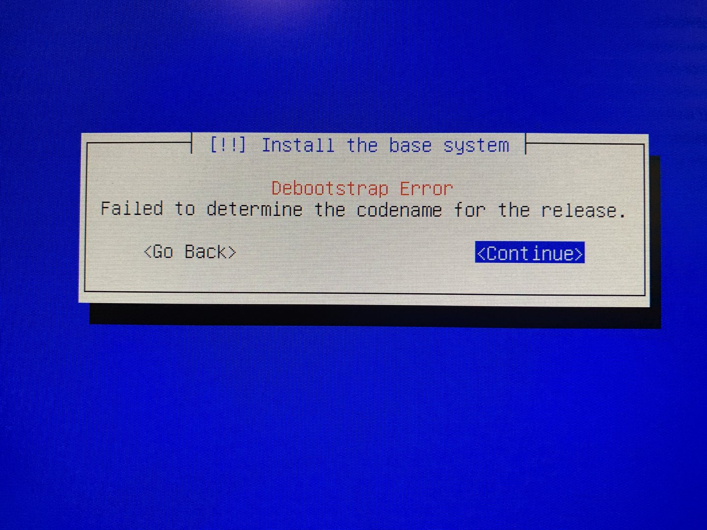

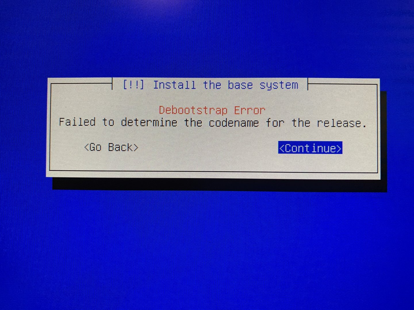

I've tried the new image ( booting from USB ), and while installing, just before the base system, I get this error
Weird, I have never seen this error myself. I'd be interested to see the log report. If you go back to the installer menu there is an option to look at the log file (look at sys). Basically the installer opens up a webserver and you can access it from another computer. Please past the relevant part here.
On a side note, I couldn't get my iMac G5 to install MintPPC as it does not see the cdrom as a repo. You might want to burn the iso on a CD, boot from it and try again.
You should also bear in mind that this is Debian sid, which can break all the time.

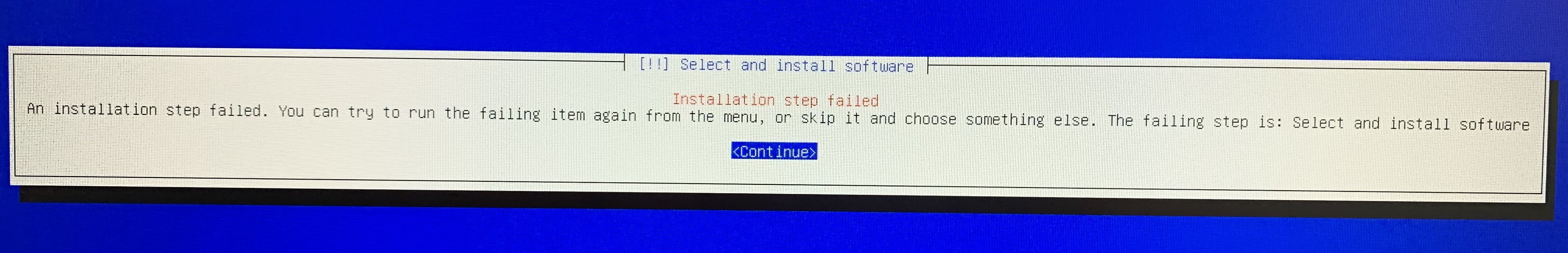

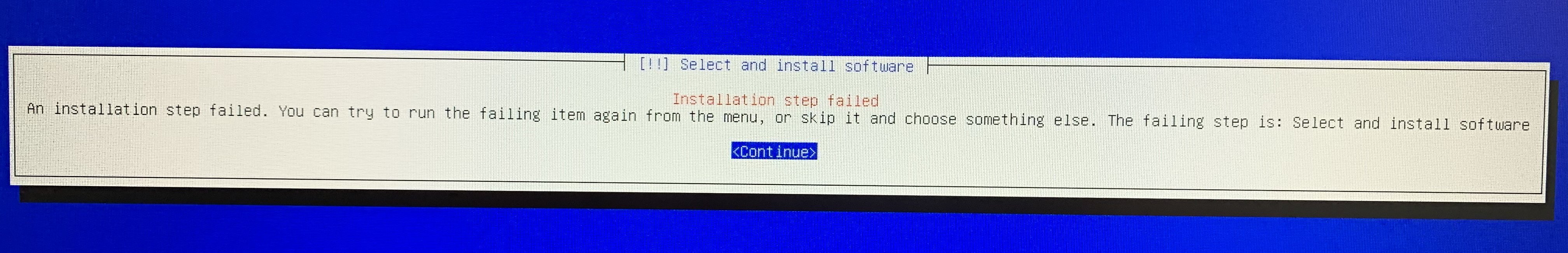

I'm getting this now at the end of the software installed ( pulled from the internet )

Here you go @Jeroen Diederen
Code:
Oct 10 08:17:48 in-target: Get:1 cdrom://[Debian GNU/Linux 10.0 _Sid_ - Unofficial ppc64 NETINST 20190716-06:06] sid/main ppc64 libiw30 ppc64 30~pre9-13 [23.0 kB]
Oct 10 08:17:48 in-target: Err:2 http://ftp.ports.debian.org/debian-ports sid/main ppc64 libglapi-mesa ppc64 19.2.0-1
Oct 10 08:17:48 in-target:   404  Not Found [IP: 149.20.4.15 80]
Oct 10 08:17:48 in-target: Err:3 http://ftp.ports.debian.org/debian-ports sid/main ppc64 libgl1-mesa-dri ppc64 19.2.0-1
Oct 10 08:17:48 in-target: Err:4 http://ftp.ports.debian.org/debian-ports sid/main ppc64 libglx-mesa0 ppc64 19.2.0-1
Oct 10 08:17:48 in-target: Err:5 http://ftp.ports.debian.org/debian-ports sid/main ppc64 mesa-va-drivers ppc64 19.2.0-1
Oct 10 08:17:48 in-target: Err:6 http://ftp.ports.debian.org/debian-ports sid/main ppc64 mesa-vdpau-drivers ppc64 19.2.0-1
Oct 10 08:17:48 in-target: Get:7 http://ftp.ports.debian.org/debian-ports sid/main ppc64 openssh-sftp-server ppc64 1:8.0p1-7 [52.1 kB]
Oct 10 08:17:49 in-target: Get:8 http://ftp.ports.debian.org/debian-ports sid/main ppc64 runit-helper all 2.8.14 [6,192 B]
Oct 10 08:17:49 in-target: Get:9 http://ftp.ports.debian.org/debian-ports sid/main ppc64 openssh-server ppc64 1:8.0p1-7 [375 kB]
Oct 10 08:17:50 in-target: Get:10 http://ftp.ports.debian.org/debian-ports sid/main ppc64 task-ssh-server all 3.55 [908 B]
Oct 10 08:17:50 in-target: Get:11 cdrom://[Debian GNU/Linux 10.0 _Sid_ - Unofficial ppc64 NETINST 20190716-06:06] sid/main ppc64 gettext-base ppc64 0.19.8.1-9 [123 kB]
Oct 10 08:17:51 in-target: Get:12 cdrom://[Debian GNU/Linux 10.0 _Sid_ - Unofficial ppc64 NETINST 20190716-06:06] sid/main ppc64 libedit2 ppc64 3.1-20190324-1 [101 kB]
Oct 10 08:17:51 in-target: Get:13 cdrom://[Debian GNU/Linux 10.0 _Sid_ - Unofficial ppc64 NETINST 20190716-06:06] sid/main ppc64 ca-certificates all 20190110 [157 kB]
Oct 10 08:17:51 in-target: Get:14 cdrom://[Debian GNU/Linux 10.0 _Sid_ - Unofficial ppc64 NETINST 20190716-06:06] sid/main ppc64 dosfstools ppc64 4.1-2 [97.0 kB]
Oct 10 08:17:51 in-target: Get:15 cdrom://[Debian GNU/Linux 10.0 _Sid_ - Unofficial ppc64 NETINST 20190716-06:06] sid/main ppc64 hfsutils ppc64 3.2.6-14 [76.7 kB]
Oct 10 08:17:51 in-target: Get:16 cdrom://[Debian GNU/Linux 10.0 _Sid_ - Unofficial ppc64 NETINST 20190716-06:06] sid/main ppc64 libwrap0 ppc64 7.6.q-28 [60.5 kB]
Oct 10 08:17:52 in-target: Fetched 434 kB in 4s (103 kB/s)
Oct 10 08:17:52 in-target: E
Oct 10 08:17:52 in-target: :
Oct 10 08:17:52 in-target: Failed to fetch http://ftp.ports.debian.org/debian-ports/pool-ppc64/main/m/mesa/libglapi-mesa_19.2.0-1_ppc64.deb  404  Not Found [IP: 149.20.4.15 80]
Oct 10 08:17:52 in-target: Failed to fetch http://ftp.ports.debian.org/debian-ports/pool-ppc64/main/m/mesa/libgl1-mesa-dri_19.2.0-1_ppc64.deb  404  Not Found [IP: 149.20.4.15 80]
Oct 10 08:17:52 in-target: Failed to fetch http://ftp.ports.debian.org/debian-ports/pool-ppc64/main/m/mesa/libglx-mesa0_19.2.0-1_ppc64.deb  404  Not Found [IP: 149.20.4.15 80]
Oct 10 08:17:52 in-target: Failed to fetch http://ftp.ports.debian.org/debian-ports/pool-ppc64/main/m/mesa/mesa-va-drivers_19.2.0-1_ppc64.deb  404  Not Found [IP: 149.20.4.15 80]
Oct 10 08:17:52 in-target: Failed to fetch http://ftp.ports.debian.org/debian-ports/pool-ppc64/main/m/mesa/mesa-vdpau-drivers_19.2.0-1_ppc64.deb  404  Not Found [IP: 149.20.4.15 80]
Oct 10 08:17:52 in-target: Unable to fetch some archives, maybe run apt-get update or try with --fix-missing?
Oct 10 08:17:52 in-target: tasksel: apt-get failed (100)
Oct 10 08:17:56 main-menu[209]: (process:11476): dpkg-divert: warning: diverting file '/sbin/start-stop-daemon' from an Essential package with rename is dangerous, use --no-rename
Oct 10 08:17:56 main-menu[209]: WARNING **: Configuring 'pkgsel' failed with error code 1
Oct 10 08:17:56 main-menu[209]: WARNING **: Menu item 'pkgsel' failed.
Oct 10 08:20:30 main-menu[209]: INFO: Modifying debconf priority limit from 'medium' to 'low'
Oct 10 08:20:30 debconf: Setting debconf/priority to low
Oct 10 08:20:31 main-menu[209]: INFO: Falling back to the package description for brltty-udeb
Oct 10 08:20:43 main-menu[209]: INFO: Falling back to the package description for brltty-udeb
Oct 10 08:20:43 main-menu[209]: INFO: Menu item 'save-logs' selected
It seems that debian ports is getting updated again. I would try again tomorrow.
I wish someone could tell me how to repackage an official Debian netinstall cd. I would then be able to pull a stable snapshot of Debian ports and use it into the iso, so we would not be dependent on a broken Debian port anymore.
I am looking into 'debian-cd' now. This is the official software to produce installation images like business card, netinstall, CD or DVD.
