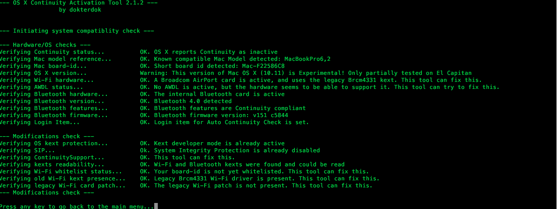

Upgraded from 10.10 to 10.11 (Official release)
MBP Mid-2010 15 Inch
Previously running CAT 2.0.0 in 10.10 = Flawless.
Now running CAT 2.1.2 = Wi-fi: no hardware installed.
Steps i did:
1) recovery terminal: csrutil disable
2) reboot to normal desktop, ran CAT 2.1.2
3) Wi-fi: no hardware installed
Tested other things:
1) recovery terminal: nvram bootargs=rootless=0

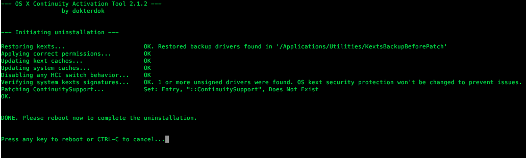

To get recover my wi-fi issue:
1) removed after patch & backup folder containing: io80211family.kext and iobluetoothfamily.kext
2) ran CAT 2.1.2 UNINSTALL option (App would reacquire the driver directly from recovery HD instead)
3) Wi-fi working, but without CAT features.
Please help !!! I believe the drivers in io80211family.kext has something wrong ?
When wi-fi no hardware installed, the bluetooth works. I am able to hotspot with my iPhone for internet.

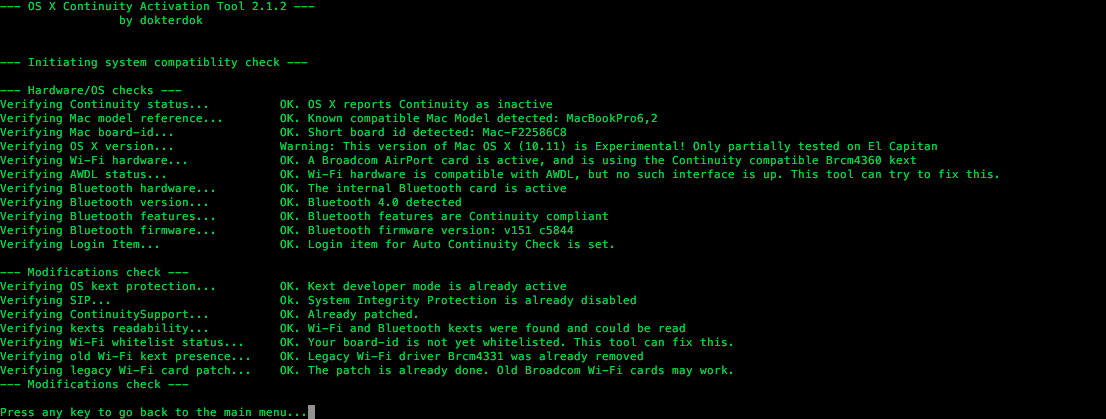

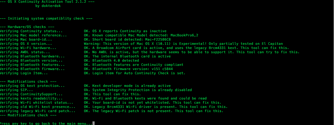

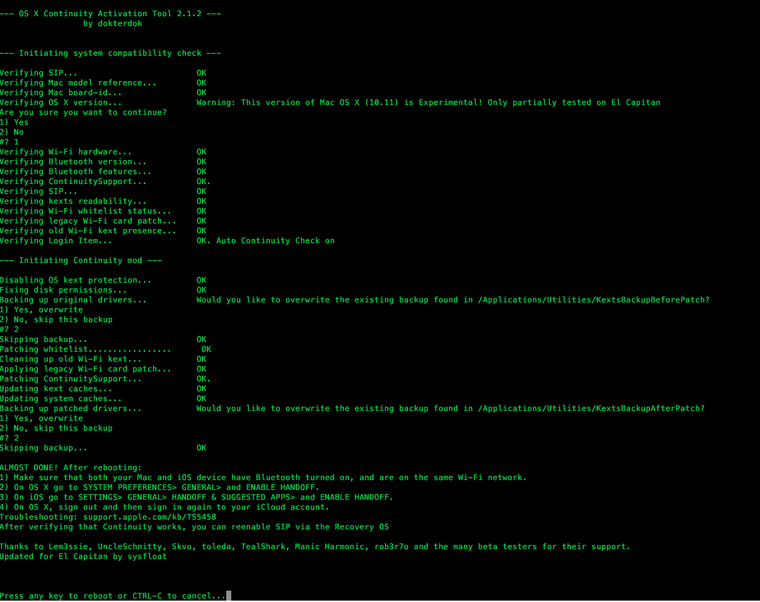

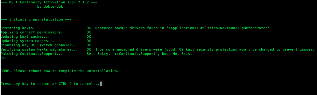

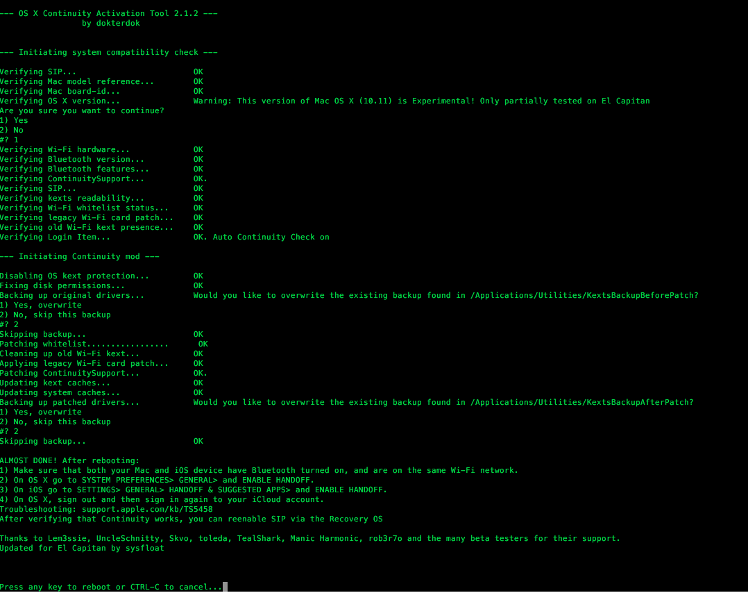

Hello,
I did a clean install of 10.11 (Official release) via USB.
Before restoring documents from Time Machine, i straight away use CAT 2.1.2.
Still no joy on MacBook Pro Mid 2010 15 Inch. I do not have anymore idea, except to wait for a newer CAT version.
Below are the attached logs of CAT 2.1.2
I just rebooted my MBP, and got the no wifi hardware installed symbol at the top of the screen. Booted to Command +R, disabled SIP and rebooted. I have wifi again. Handoff and Airdrop is working, but not getting any phone calls on the MBP or iPad Air. All are signed into the same account. Text forwarding toggles for both MBP and iPad Air are engaged.
Hello,

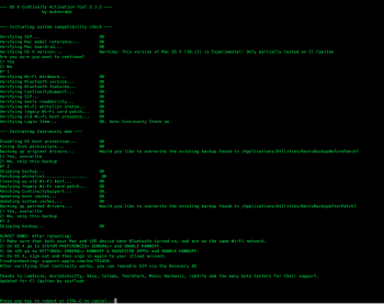

It took about 30 minutes before handoff started working for me. My phone showing as a hotspot in the wifi menu was immediate though.
Macbook Air 2011.
Upgraded to El Capitan from Yosemite yesterday.
Tried running the beta CAP, got the damaged message. Changed install security option to everything.
CAP ran fine.
Showed SIP activated and that it would be a problem.
Followed instructions to reboot and disable SIP.
Restarted.
Ran CAP and got continuity turned back on.
Restarted.
CAP auto ran and apparently turned SIP back on. (Confirmed this in disk utility, info)
Handoff now working fine.

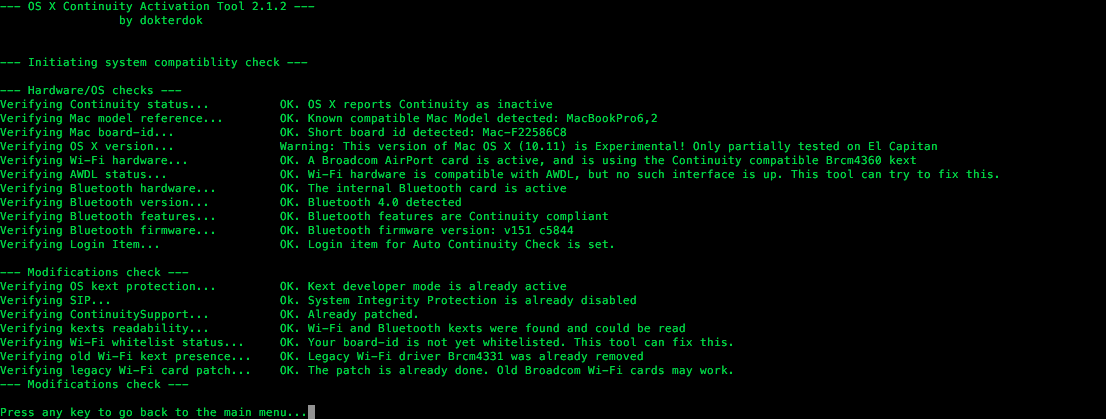

GOOD NEWS for macbook pro 2010 with BCM94331PCIEBT4CAX upgrade.
Osx El Capitan 10.11 Upgrade form yosemite today
I don't have modify bluetooth kext, just AirPortBrcm binary.
typed in terminal:
ioreg -l | grep "board-id" | awk -F\" '{print $4}'
show for my mac: Mac-F22586C8
and so i have manual edited the AirPortBrcm4360 binary and i have added my Mac-F22586C8 Board-id
Now This is what you have to do:
Reboot using CMD+R
Open terminal
Type: csrutil disable
Reboot
1. application/utility/terminal, write: sudo nvram boot-args="kext-dev-mode=1"
2. open Kext Drop and drag on it my IO80211Family.kext
3. This is the end: reboot your macbook, now we have all new functions working.
If not, try to log out iCloud from macbook and iphone and then login again
I am not sure if all the step are necessary, I am a regular apple user, not an expert.
I hope you can solve like me
This modded kext it's only for MacBookPro 2010 with BCM94331PCIEBT4CAX card upgrade
Regards
http://speedy.sh/EvSE4/Archivio.zip
