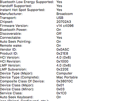

Anyone have any idea why my IOGear 4.0 BT is showing up wrong w/ the LMP?
CAT ran fine, but no continuity.
It has been a long time since I first tried a BT dongle but, I seem to recall, that it didn't always recognize correctly after rebooting at times. In your case, it could be a faulty dongle or unsupported one. The latest CAT release does not support BT 4.0 dongle with continuity.
