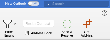

What is this "New Outlook"? I am running 16.56.
There is a small toggle button in the top right of outlook which will give you all the joy and pain of this experience
Only works with 365 accounts and has some limitations, but isn't a bad interface and the search works - think this is independent of spotlight!
