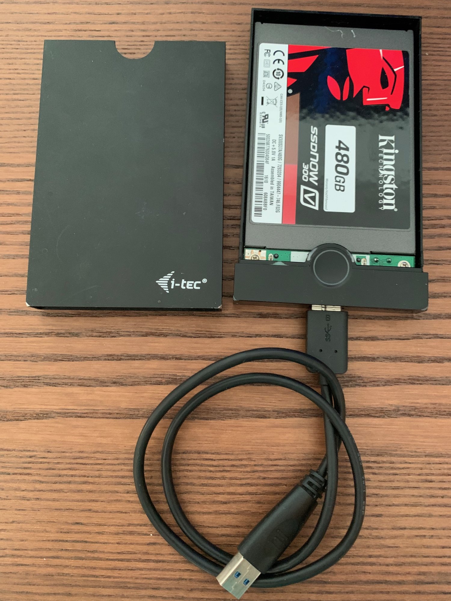

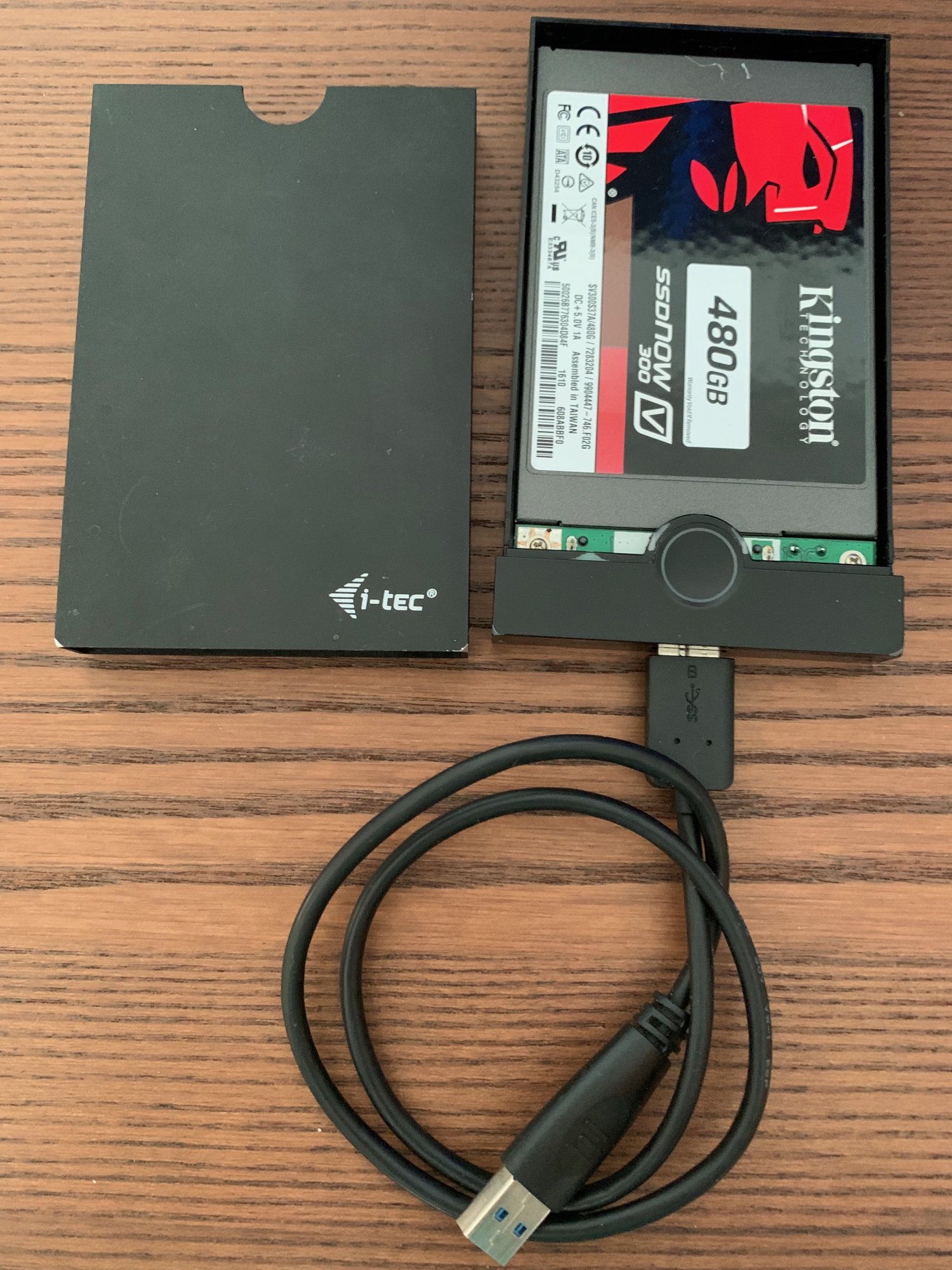

It's "i-tec" no model name brand enclosure

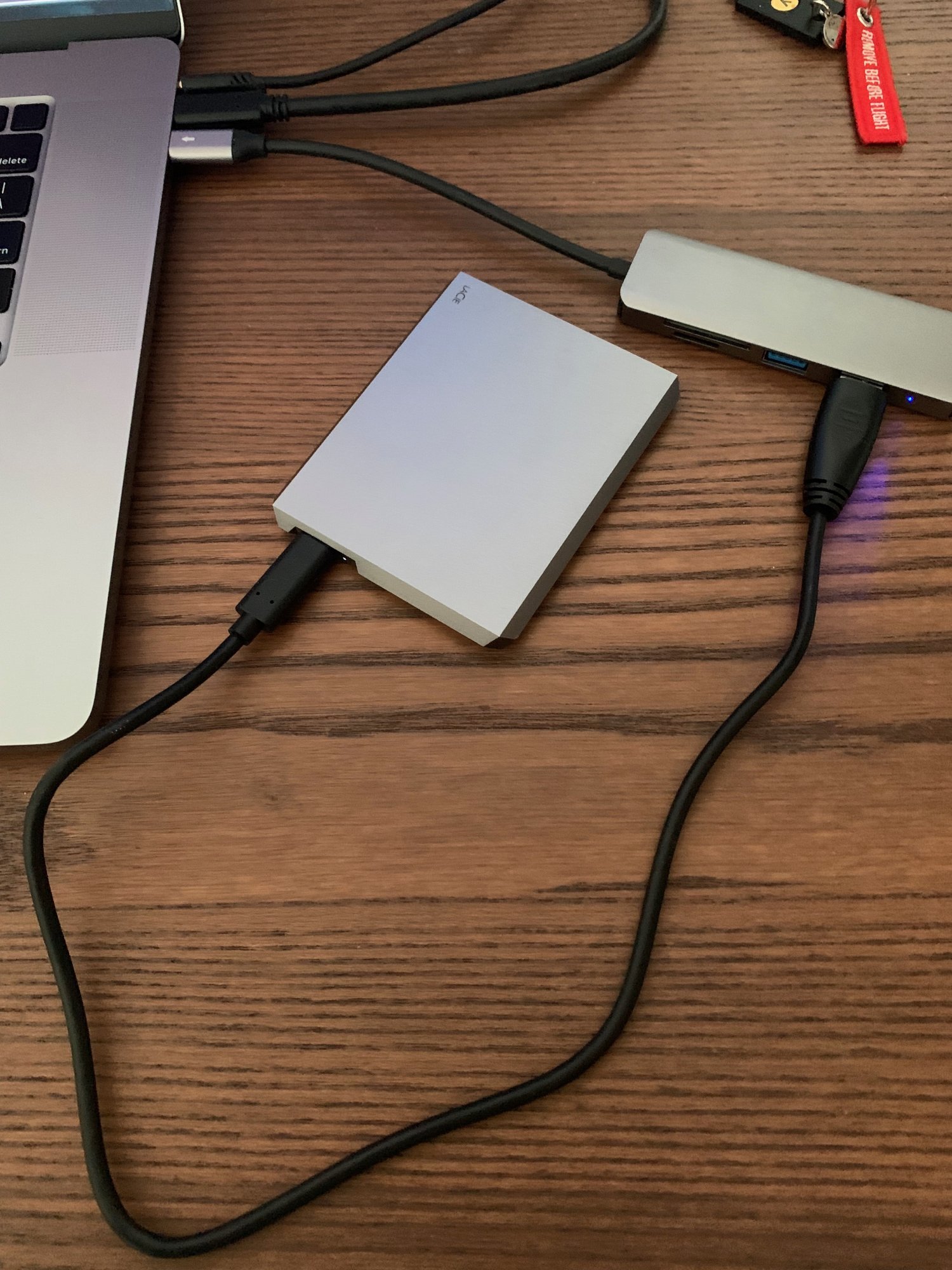

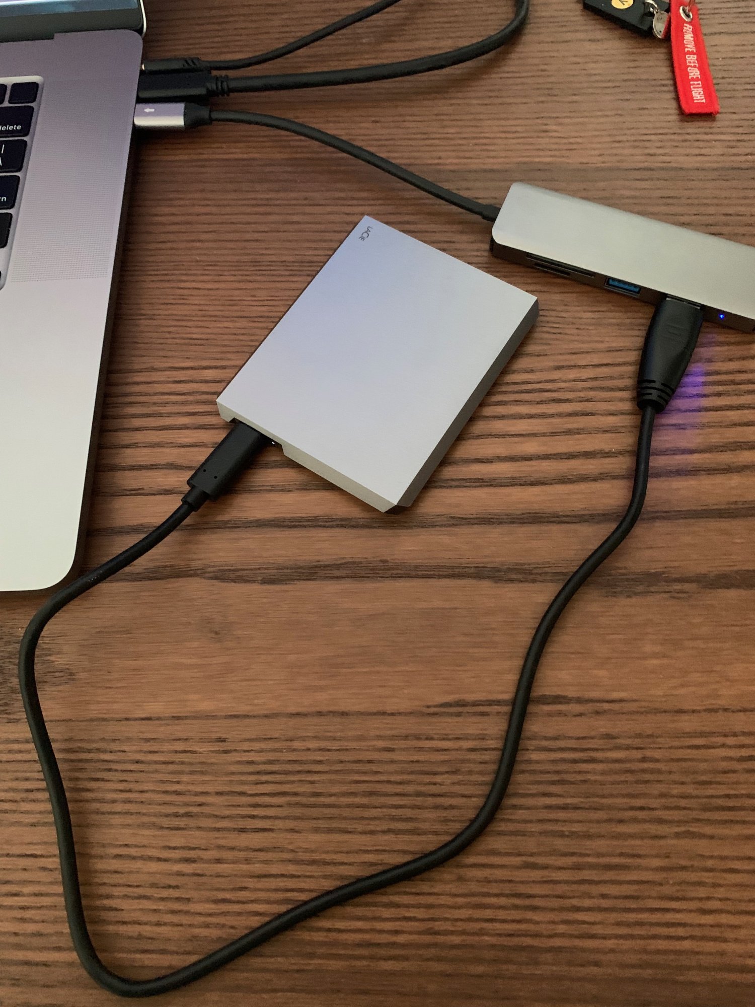

I've used the drive using USB Dongle hooked directly to MBP 16" (2019). Additionally I've used the drive through the Dell U2720Q USB hub as well.
Additionally I've tried to connect the Lacie Mobile SSD via USB-C to USB-A cable, problem still persists.
20GB Image file copy operation
- approx 400MB/s speed no name drive
- approx 2-4MB/s speed on LaCie SSD (approx 3 hours to complete)
Well, finally I have tried to hook the LaCie SSD through the Dell display (LaCie USB-C to Dell's USB-A) -> to MBP via USB-C Cable and the speed was somewhat faster - finder says approx 8 minutes to complete (compared to 3 hours when hooked via USB-C hub)

Yea, well, using the A cable with LaCie SSD gave me no resolution to the problem. This leads me to the conclusion that it has something to do with the cable itself (and it's protocol support - data transfer speed).
I have just tried to connect the problematic LaCie SSD drive using an IKEA USB-A / C cable link (not sure about the data transfer speeds, but defninitely not as fast as the original LaCie supplied cables) and to my surprise it works as fast as it can through that cable (approx 38MB/s transfer speeds) - apparently the cable is slower, but the point here is that it is possible to work with the drive without any beach balls and freezes (Finder, Disk Utility), although the transfer speeds are 10x slower.
I have no further knowledge how exactly the USB works under the hood regarding the protocols and speeds, but it seems like slower cable (IKEA brand) make's the drive at least usable without any beach balling and using LaCie SUPPLIED cables makes the drive utterly slow and basically not usable. Great job team which worked on Monterey. ?

my SSD drive worked with its C/C cable without any issues on a BigSur VM that I created via VMWARE Fusion in OS Monterey
It's "i-tec" no model name enclosure

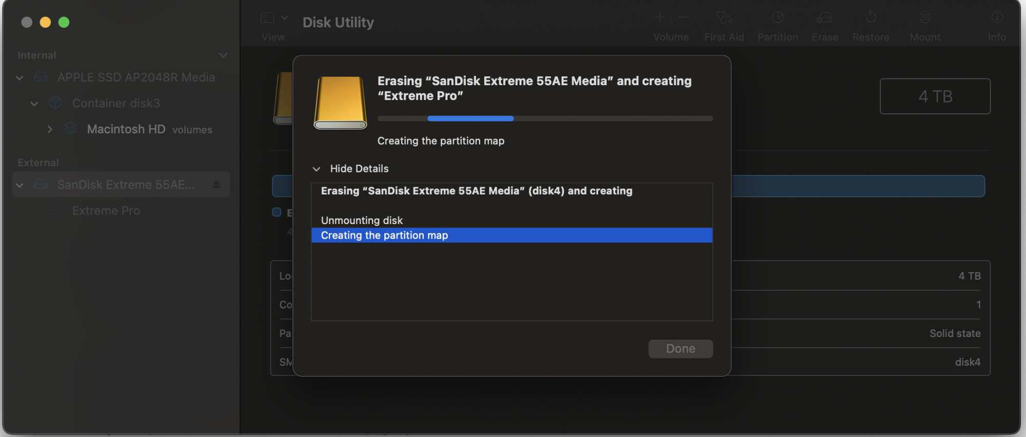

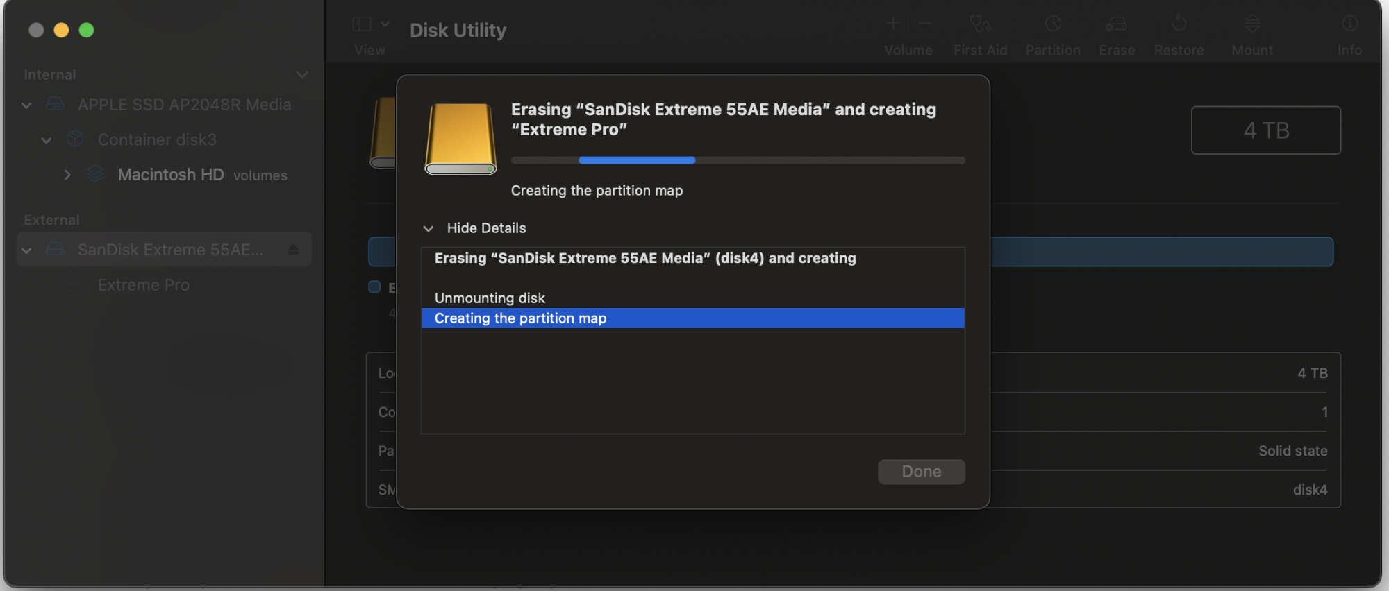

I had this same issue, i.e. Disc utility hangs at "creating the partition map" when trying to initialise a new Samsung 870 QVO 4TB SSD connected via External USB 3.1 Enclosure on macOS Monterey 12.0.1, formatting with APFS Encrypted and GUID scheme. I tried multiple different enclosures and cables* with no difference.
I left it overnight (~12 hrs) and both laptop and drive got warm but zero progress. Interestingly iStat was showing very low utilisation on anything, yet the Mac and dive were both noticeably warm. The drive & enclosure was new but the Mac & cables are ones I've used many times for formatting drives.
Luckily I had another Mac in the house on Big Sur 11.6.1 and the same process completed without error and near immediately (few seconds). Having completed the initialisation on the Big Sur MacBook, the drive is now fully usable as normal on the Monterey MacBook. But the Monterey MacBook was not capable of completing the initialise procedure.
So I would say this confirms it as a Monterey bug wrt drive initialisation / formatting / partitioning.

Just received a new SanDisk Extreme Pro 4TB SSD and discovered this issue. Had to reformat on an iMac running Big Sur. What a hassle! The bigger question: Is it risky running this drive in Montery if there were issues with formatting? Are we risking data loss?
Yes. I‘ve tried it with two different 4 TB drives (Samsung 860 QVO, SanDisk Ultra 3D SSD) in the same IcyBox USB C 3.1 enclosure. Formatting worked on an MacBook Air M1 with Monterey. Accessing the drive from an iMac 27“ with Monterey made the drive unreadable even from the MacBook Air.
I had the same problems on Monterey on M1 machines (MBA and MBP14) with Sandisk Extreme PRO 4TB - couldn't erase/create partitions, both CLI and GUI was stuck on creating partition map etc.
I connected the disk with my ipad's original charging cable (USBc - USBc), and suddenly Disk Utility worked normally. I was able to erase the default ExFAT partition and create APFS container with two APFS encrypted volumes on it without any issues. Then I ejected the disk, connected it with the Sandisk provided cable to my MBP14 and it sees the encrypted APFS volumes correctly and I'm able to use them just fine.
