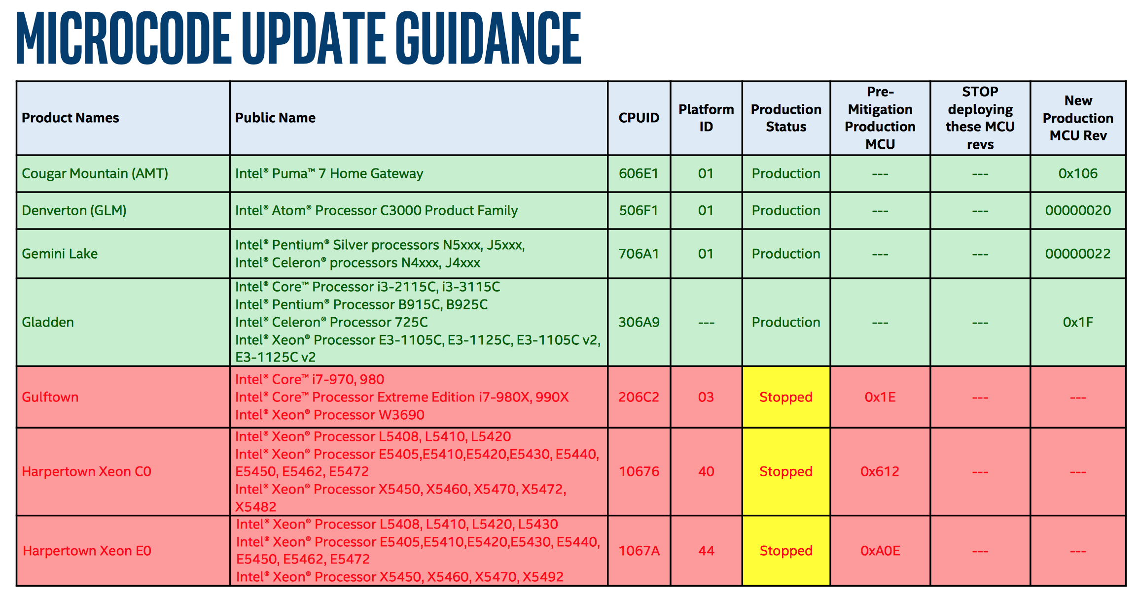

Today Intel published the updated Microcode Update Guidance. The production versions of the microcode for the Mac Pro 4,1/5,1 Xeons are 0x1C/0x1E (exactly like previous Dell's servers updates).
0x1C for Nehalem EP/WS Xeons
0x1E for Westmere EP/WS Xeons
Microcode on the MP51.0085.B00 still on the unmitigated 0xF version.
Note: Xeon W3690 will not be getting the update since Intel weirdly stopped Gulftown i7/Xeons microcode update.

im curious why intel is segregating the microcode update to this extent...
the W3680 and W3690 are practically identical apart from clock speeds.
Does anyone here have a System that got a BIOS update with the new microcodes? (or a system that you have patched the microcodes into the BIOS yourself LGA771 on LGA 775 style)
if you do, it would be very interesting see what microcode gets loaded for a W3680 vs a W3690, as at least back in the LGA775 LGA771 days microcode was only differentiated on platform (socket type) and architecture (it was not CPUID levels of specific)
It’s CPUID based, if you look on the table, Gulftown have a different one.
Gulftown = 206C2
Westmere = 206F2
Gulftown = 206C2
Westmere = 206F2
206F2 is for Westmere-EX...
206C2 is the CPUID for Gulftown Westmere-EP and Westmere-WS AFAIK

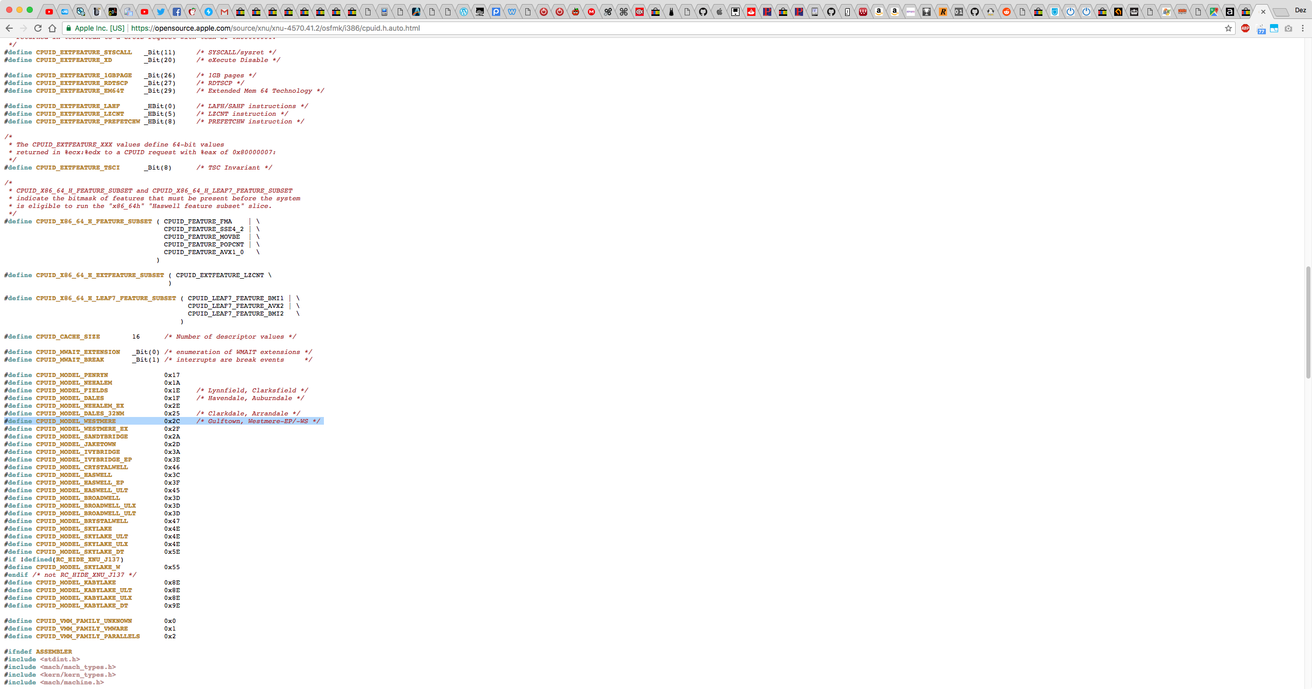

to further this here is an excerpt from the Apple XNU source code to do with CPUIDs (J137 is the code name for the iMac Pro in case anyone is wondering, also fun fact if you check out the 10.4.11 intel, version of this source code file you can see Apple where "supporting" a Lot more CPUs and that they had added Penryn support despite no Mac shipping with Penryn at the time :) )
(Also my bad, by CPUID levels of specific I meant the past microcodes never cared what the CPUID name string was ie they never cared about this: "Intel(R) Xeon(R) CPU X5677 @ 3.47GHz" all they cared about was the General CPUID and the Platform ID )
Seems Intel did a petty move - if ever Apple update microcode they will have to add checks to differentiate Gulftown/Bloomfield/Clarksfield
CPUs…
Reactions: LightBulbFun
CPUs…
which makes me wonder is the Microcode actually checking for the Brand/Model string or is intel Just saying the W3690 is not supported even tho it does get its microcode updated?
only way to tell is test the CPUs out in a patched system and see what Microcode version is reported exactly, Once intel puts out the microcode that the Linux guys use people should be able to use that to patch PC X58 BIOSs with the new microcode even if the system vendor does not put out an update. (in the same way people add LGA 771 Microcode to LGA 775 boards, or how I added Wolfdale/Penryn LGA775 microcode to couple LGA 775 boards I have that do/did not support Penryn and lacked microcode for them so until I patched in microcode I had no SSE4.1 or VT-x heres a couple CPU Z validations of the systems I added penryn support too :) http://valid.x86.fr/b2y13x and http://valid.x86.fr/56lzvi )

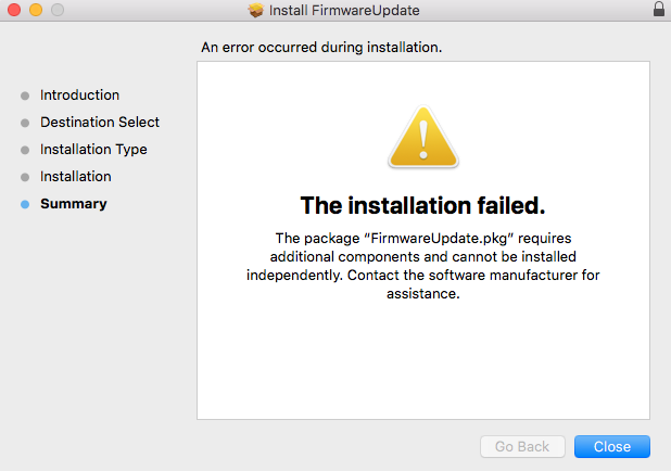

Downloaded the 10.13.4 installer and upgraded from MP51.0084.B00 to the 0085.B00 version. It took a few efforts:
1. You can install without running the rest of the installer, if you are already running a current or beta version of macOS and do not want to install over that.
2. Firmware update did not complete from a boot drive connected via a third party card, it needed to be on the native controller.
3. I have a Sierra installation in one of my standard locations. The first time I waited for the light to flash plus the sound. This did not take. On the second attempt I stopped pressing the power button with the flashing light. It beeped, reboot chimed, opened the DVD drive doors, trundled, and rebooted. The EFI display driver does not work with my Dell 38" screen so I had to fly blind. But all ended well. After reboot I cancelled out of the install.

For info, my cMP can be upgrade via a SSD that installed onto the Sonnet Tempo SSD card. So, point 2 is not entirely correctly. However, I do agree that the storage and its connection method can cause firmware upgrade failure.
For point 3, if there is any display port setting in your Dell monitor, set it to DP 1.1, then the boot screen should work. And it's the very first post I've seen to confirm you don't actually need to display the firmware upgrade process, but only need a Mac EFI graphic card installed. Thanks for this critical info.

Today, for those who are not sure how to get the firmware upgrade.
My method
I did a clean install of Mavericks 10.9.5 on a spare HDD.
Logged into the App Store
Searched for "High Sierra.
Selected install.
Then the "firmware update required" message popped up.
Followed the instruction to SHUT DOWN the cMP.
Restarted holding down the power button 'til the light started blinking.
It started up in Mavericks 10.9.5 with MP51.0085.B00 showing in System Info
Done.
