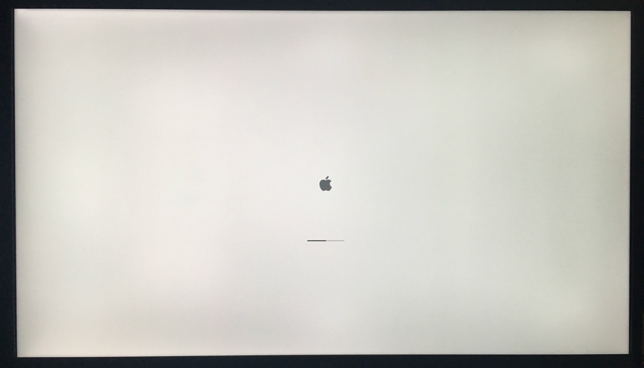

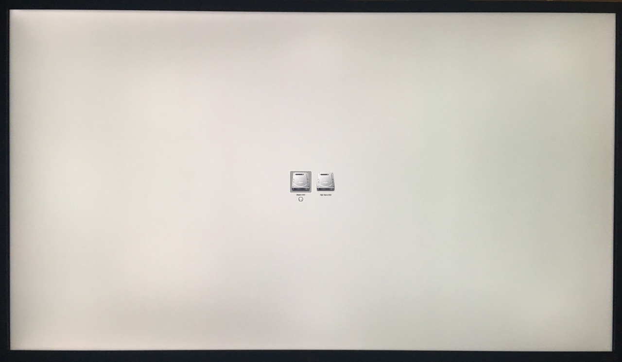

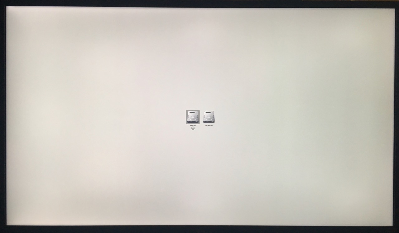

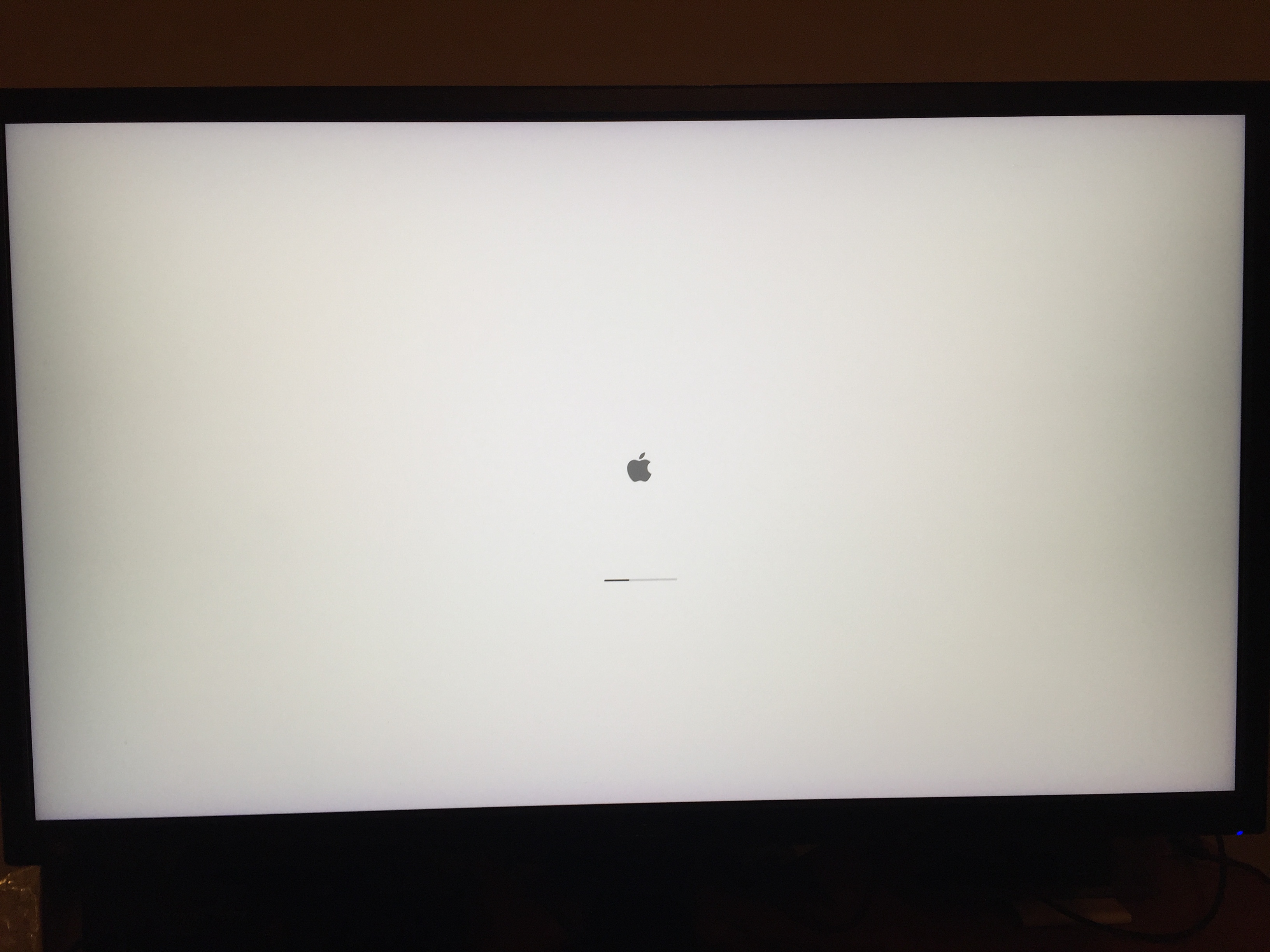

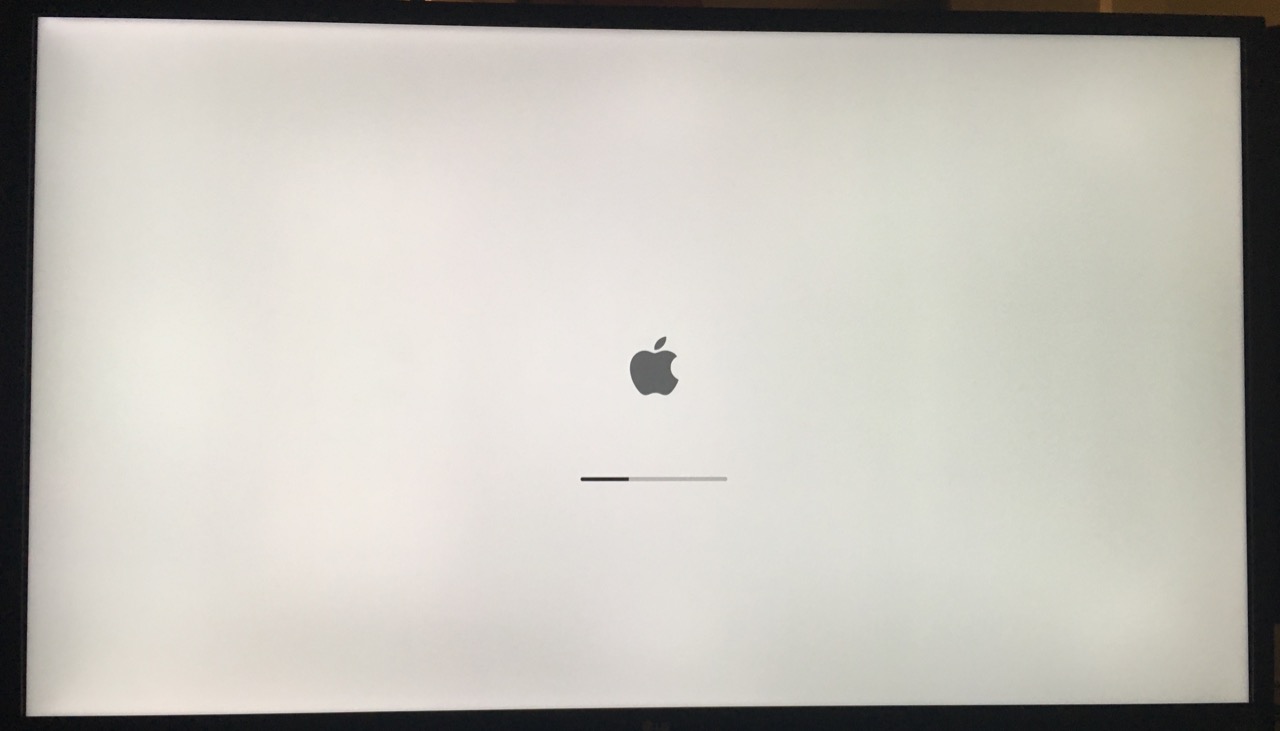

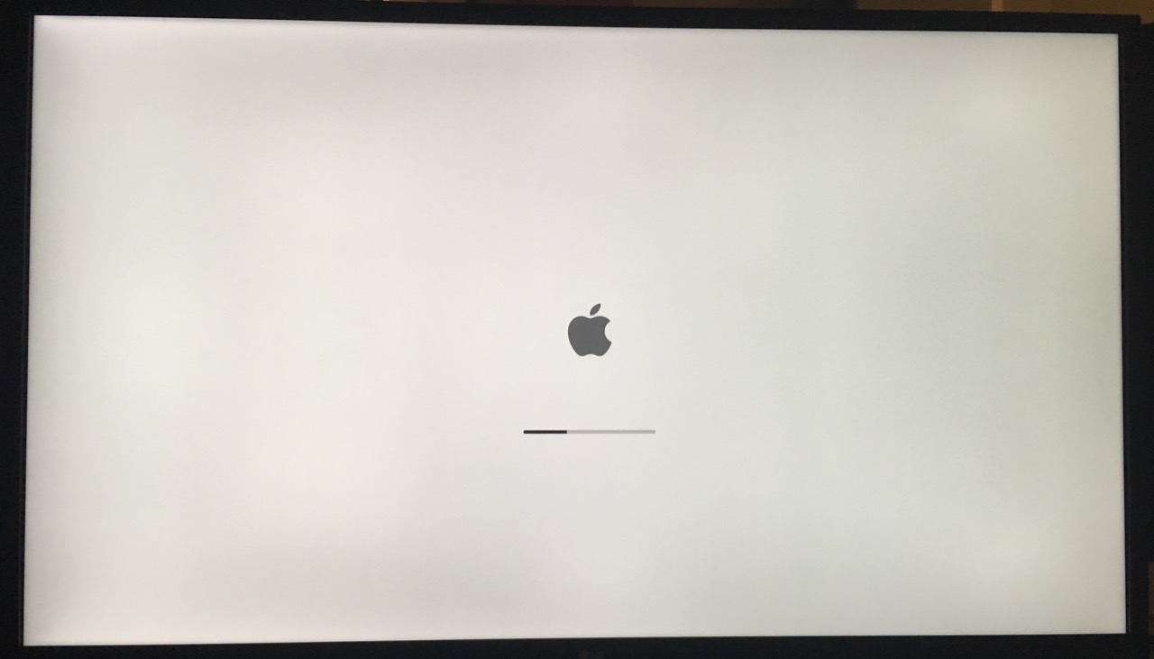

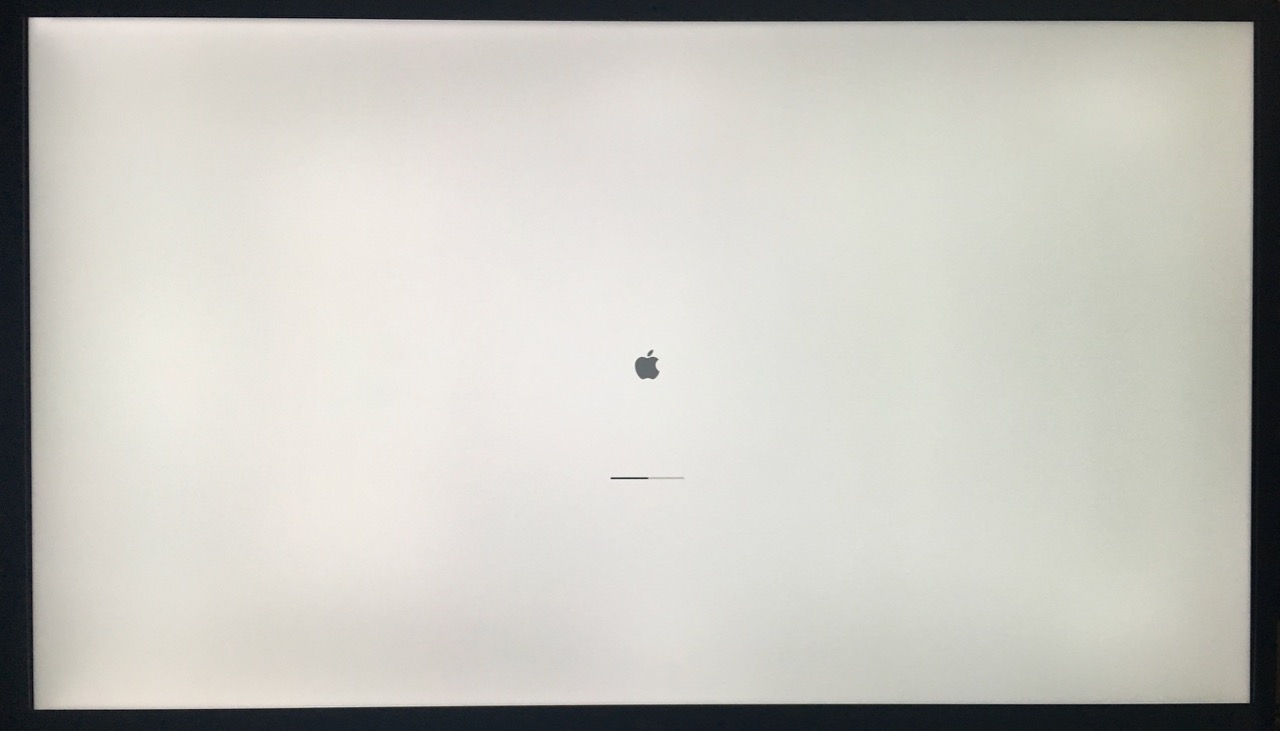

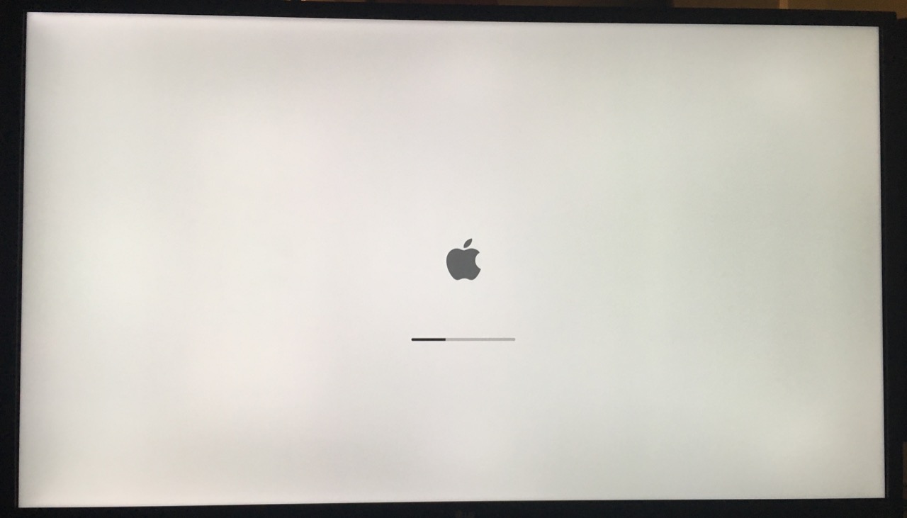

Since I just got a UHD 4K monitor, here's a photo of the boot screen on the MacVidCards RX580. (Connected by DisplayPort.) It seems to be running at 3840x2160 resolution (1:1, no retina scaling) as the icons and text are very small. (The monitor doesn't tell me the refresh rate.) Then when the OS loads, retina scaling kicks in and the Apple logo grows to its usual larger size.

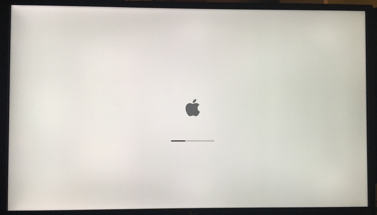

I was afraid of that (see post #63), and I was hoping that this peculiarity would be fixed (MVC Nvidia Maxwell cards did this as well). Luckily, you can fix this with the UIScale NVRAM variable.

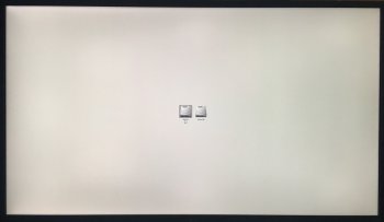

With your UIScale nvram setting, I do get a retina scaled (1920x1080 equivalent) Apple logo EFI boot screen on my UHD 4K monitor. However, the option key boot drive selector seems to still be unscaled, at 3840x2160 size (tiny text).

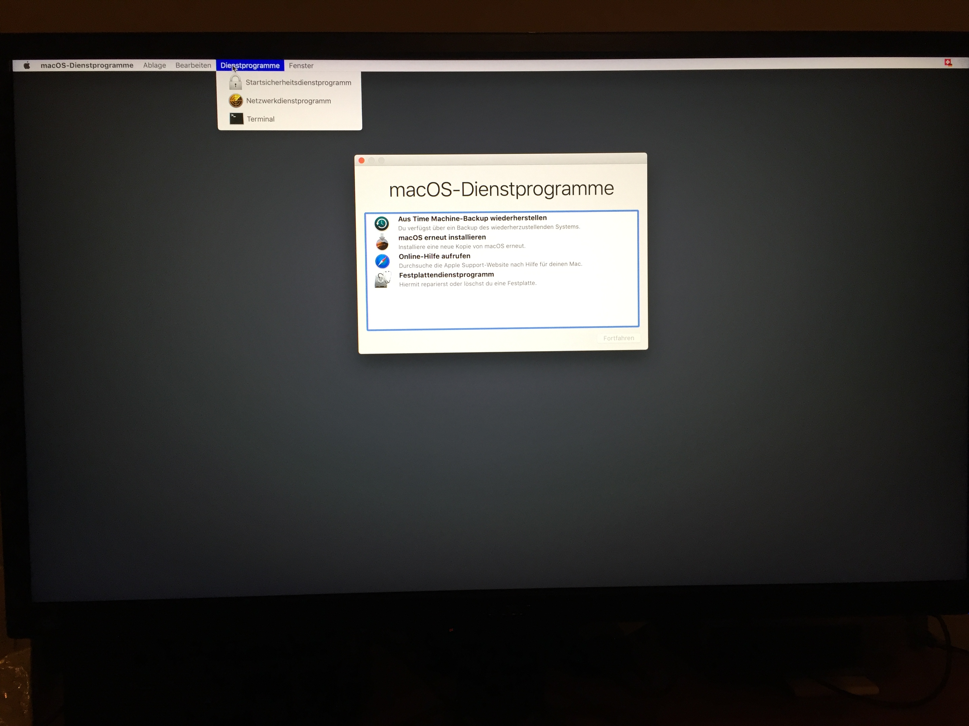

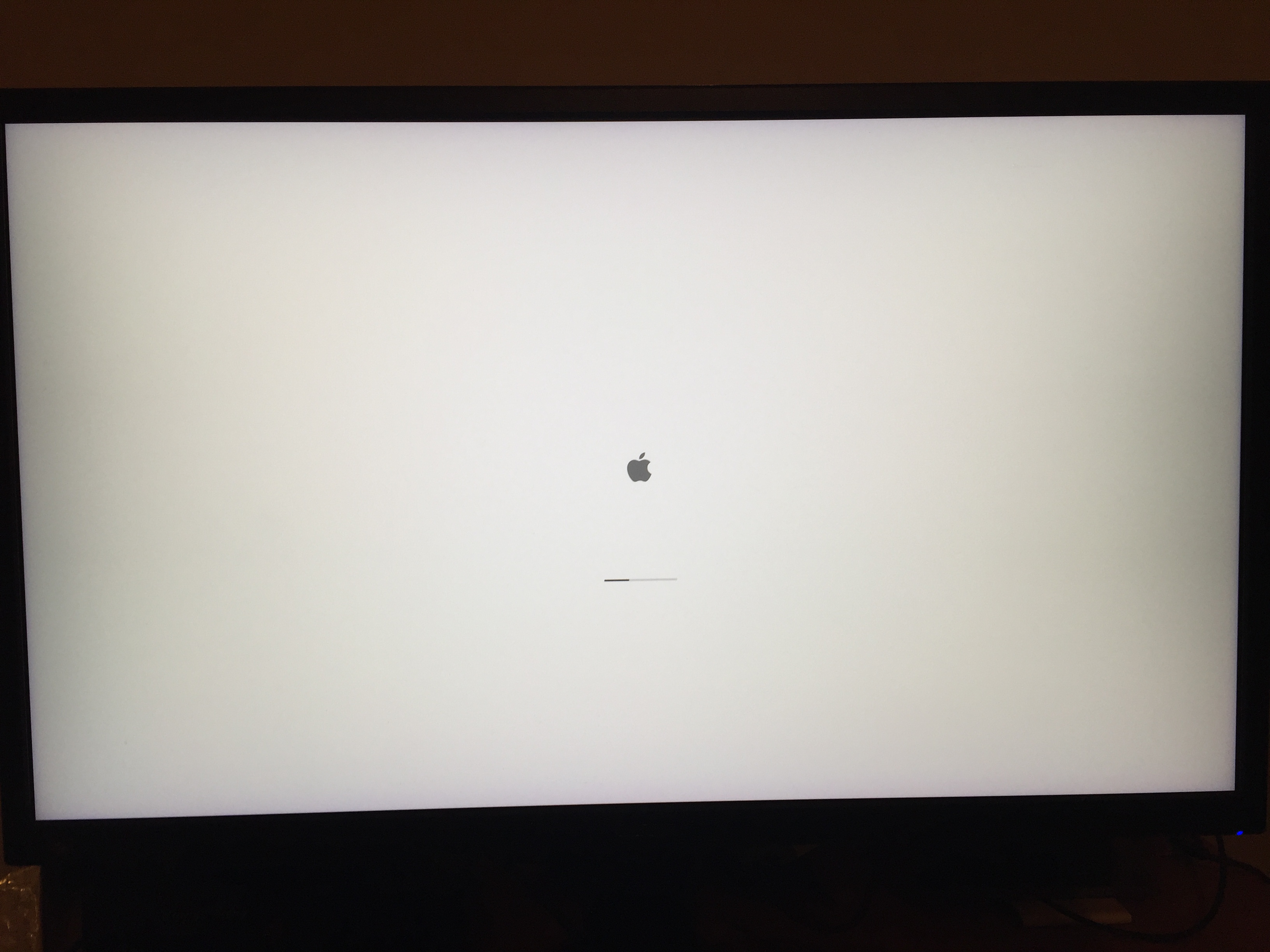

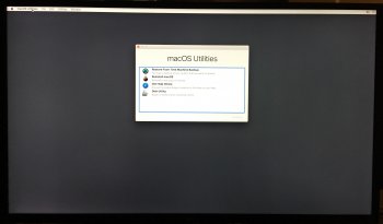

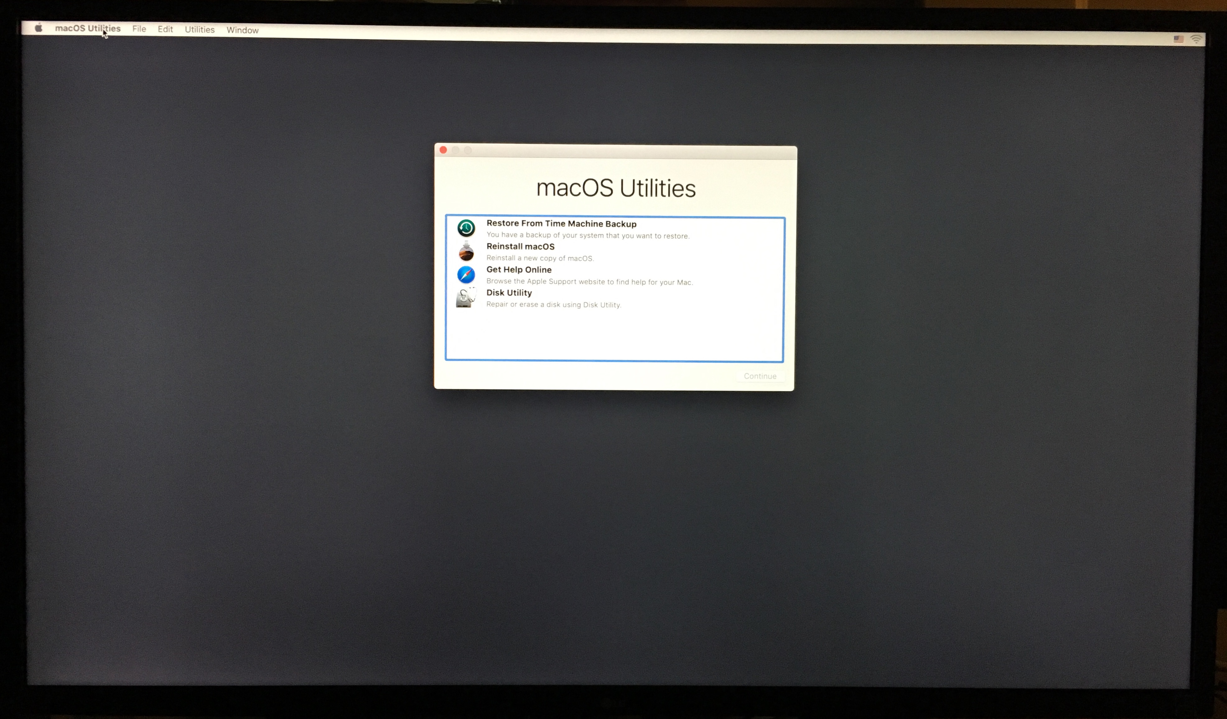

Do you mean, even only ONE 4K monitor connected to the MVC flashed RX580, and NO any other monitor connected (in other word, single 4K monitor setup), your card still can't boot into recovery mode?

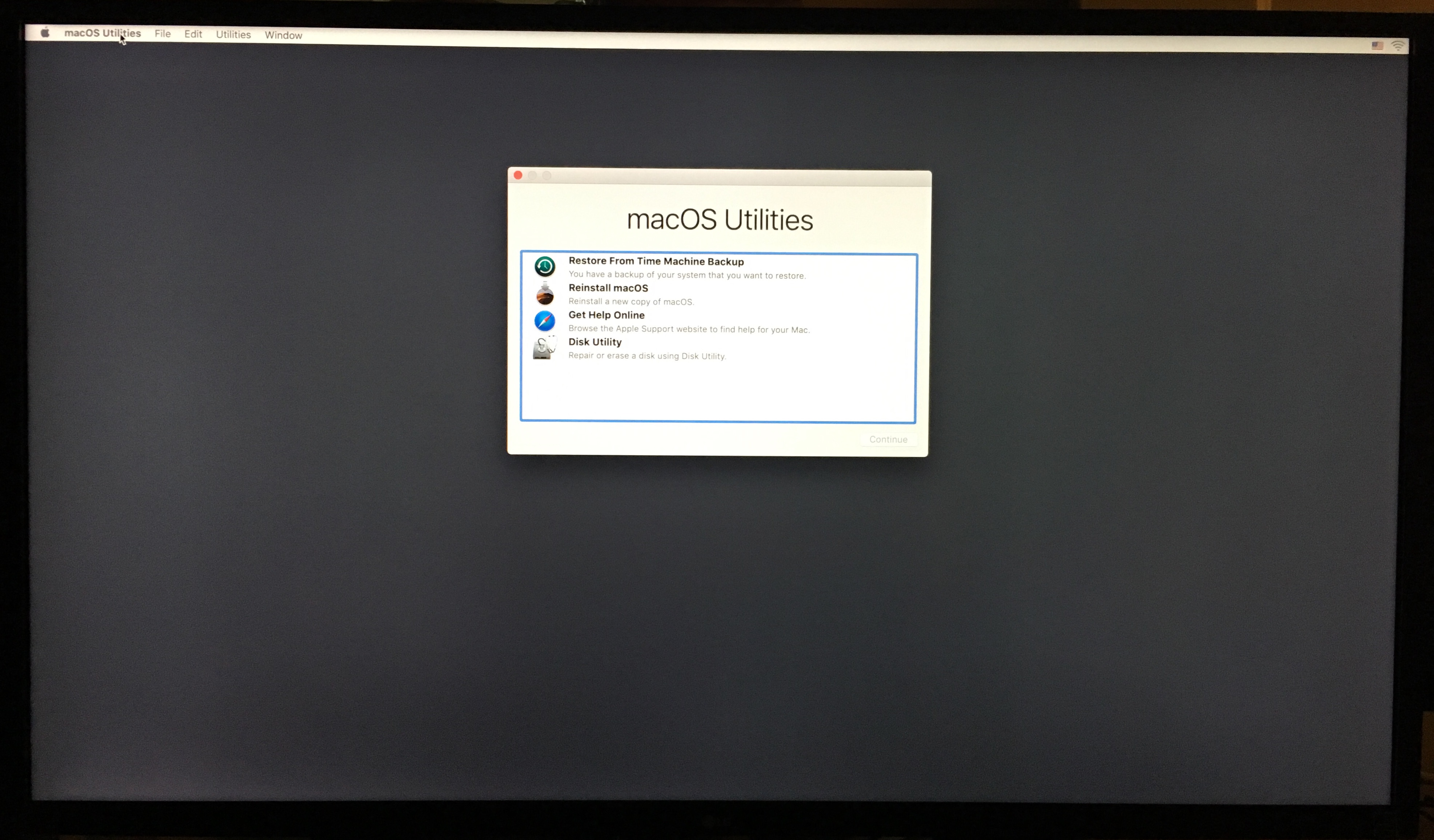

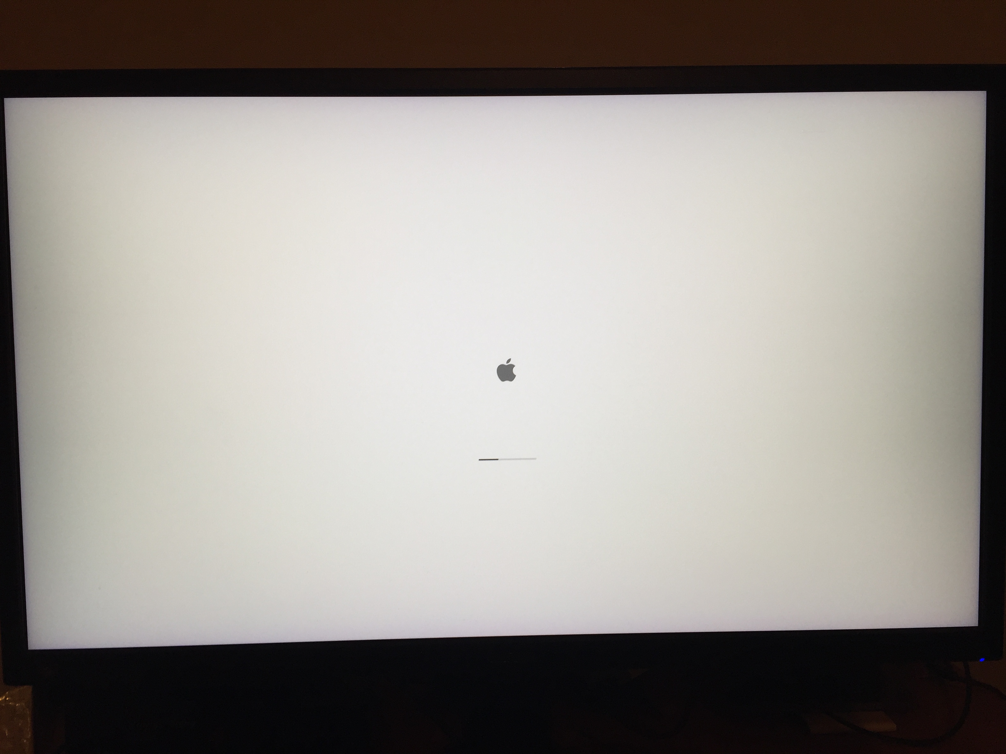

Proof of contrary: I just booted into recovery mode with one 4K monitor (Acer Nitro XV273K) attached. No UIScale nvram setting edited.
MVC RX 580 with EFI.
